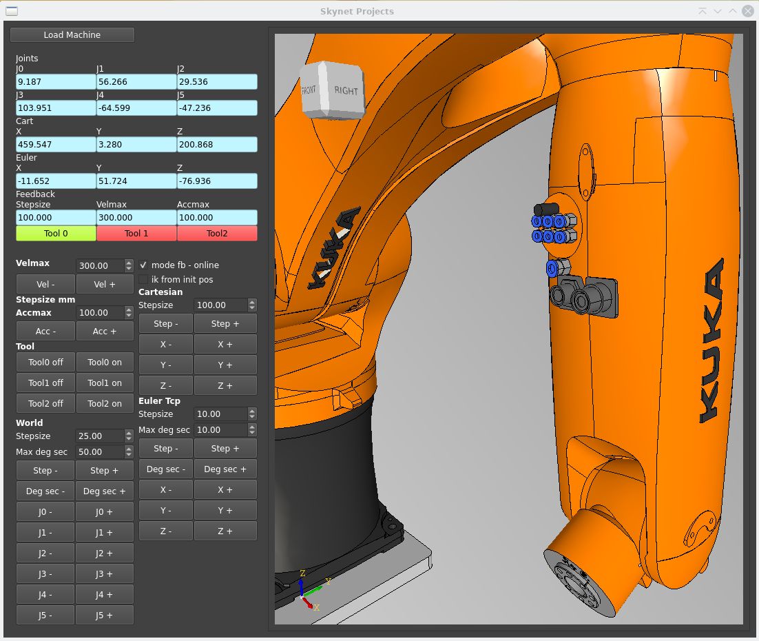

23 May 2021 10:33 - 23 May 2021 13:31 #209915
by Grotius
Replied by Grotius on topic ROS LinuxCNC Link
I have now tested the halstreamer. It works excellent.
For testing and moving the robot i have created a little program.
This program has under the hood:
- Hal connection ( base threat + servo thread + halstreamer )
- Forward + Inverse interpolation based on kdl
- Respect's joint limits.
- Cartesian s-curve moves, based on this algoritme
- Euler angles rotating at fixed (user defined) degrees a second ( ** cool option ** )
- Joint angles rotating at fixed (user defined) degrees a second. => used when only rotating joints.
- Opencascade cad machine preview, updated by stepgen feedback value's results in realistic motion preview.
- Live mode (hal stream) and demo (playing) mode.
Used hardware :
Ethercat beckhoff + 5us stepper outputs.
Used software :
Linux-cnc source : Linuxcnc at master
Linux software : Linux-11-pro
There was quite a lot to code. This took me 2 day's.
I am quite happy with this result so far. The best kinematic result so far.
Next thing to do:
1. Make a working gripper, wich can open and close in preview.
- Maybe make a program for a piano?
- If you have any request for a program, please post your request.
2. Record the halstreamer movements to a single play-off file, and then execute this file.
3. So far so good. Up to the next day !
* Attached my hal file. It's quite clean.
Last edit: 23 May 2021 13:31 by Grotius.
- Posts: 4819
- Thank you received: 2177
23 May 2021 11:53 #209921
Replied by Aciera on topic ROS LinuxCNC Link
Nice!
I'd still be very much interested in testing your app on my Mitsubishi robot. But, as discussed earlier, I'd need Dmitry's SSCNET drivers from his nyx branch built in to do so.
