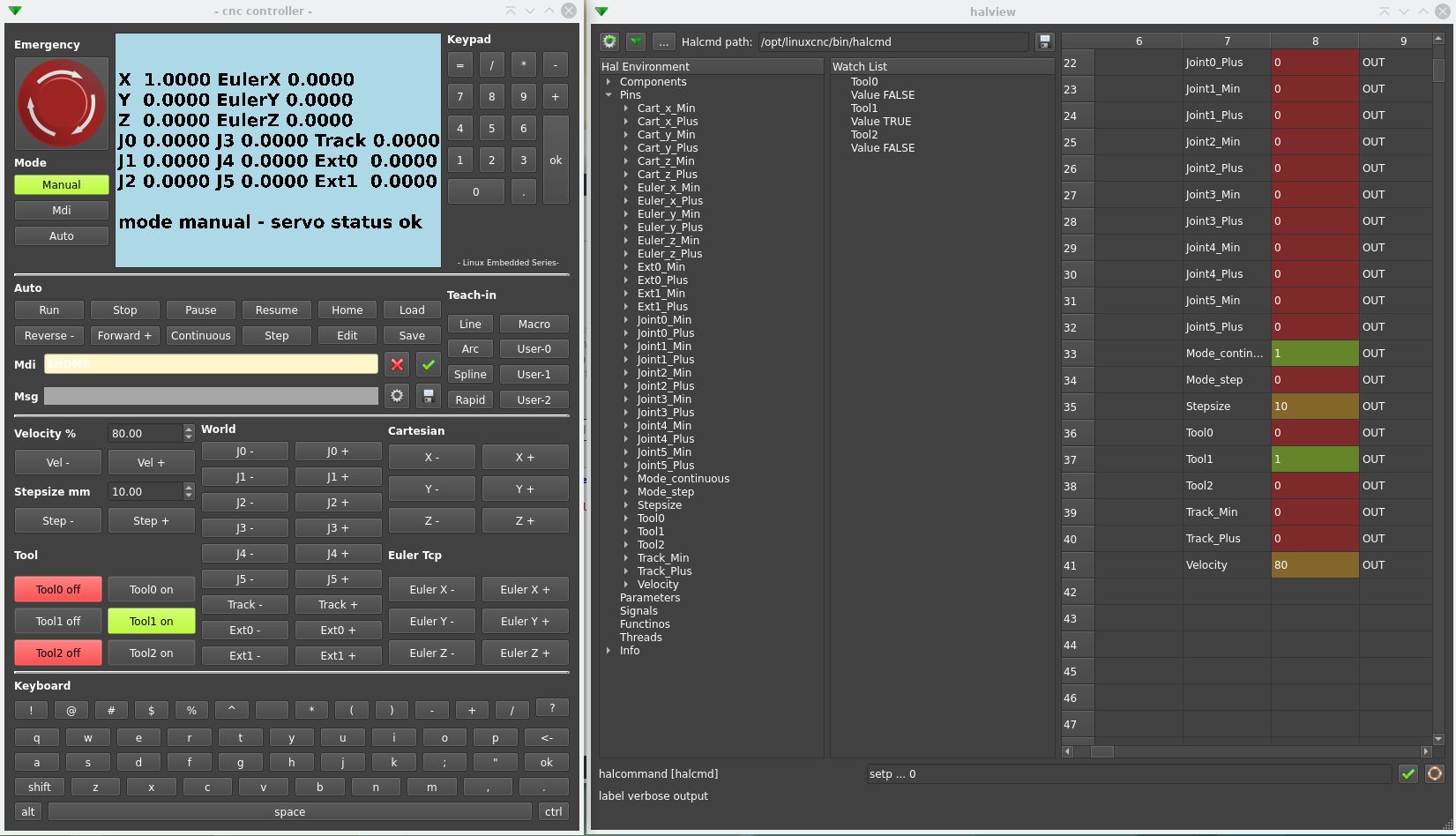

3. Created a realtime path planner wich behaves like a video player with 1000 frames a second.This is really a big thing.
4. Created a c++ halviewer. We have now full control.
5. Now creating the different robot, cnc machine teach in functions for 3d usage.

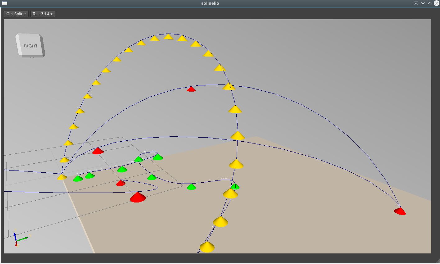

Replied by Grotius on topic ROS LinuxCNC Link
Cyborg here again.
Without a defined plane I am not sure how you determine clockwise or anticlockwise,
That is defined by point order. I now have the 3p 3d arc ready for teach in.
Waypoints out ok.
We don't have to know arc centre. We can reflect a euler angle on the 3d arc if needed in the future.
Where do you buy these 50-hour days?

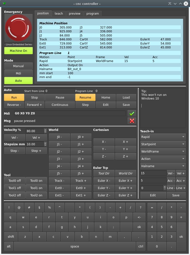

Now finishing the teach pendant.
Let me know if the button's, layout etc is ok. Then i can finish it.
The old display is done with some magic.

06 May 2021 06:46 - 06 May 2021 07:02 #208094
by Grotius
Hi Arciera,
1. Could you also implement rotations (ABC) in Cartesian and TCP modes using the opencascade kinematics?
A common implementation is the roll pitch yaw, but i like the euler angles above roll pitch yaw. The euler angles rotates the tool center point inline with the world frame axis.
2. Is there a way to switch between World (joint), Cartesian and TCP modes and execute moves in the respective modes in GCode?
I remember this question. So far as i can see there is no need to switch between modes. All modes are active at the same time. Except moving inline with the tool oriantation. This could be a extra button to activate.
If you press X+, the robot moves along the x world frame. For y and z the same.
If you press Euler X+ the robot rotates about tool center point in direction of the world frame axis x.
If you press J0+ the robot rotates about axis 0.
You can do above sequences without selecting a mode. When pressing a button, the other values will be calculated.
Arciera, if you mean something else, maybe provide a scetch so i can understand your comments even more.
There will be coded a kdl kinematics improvement wich performs anti locking and optimalisation of robot joint positions.
Maybe 300-600 lines of code. 2 day's work.
You did not see it, but the teach in function is really cool. It show your teach in path in the old screen. In fact the old screen is a
modern implementation of 3d opencascade. This widget can also show gcode etc.
For performing a gcode you can input a mdi command. What we can do is make a gcode input accelerator dialog that pop's up when
pressing the mdi line.
We need as much as idea's now. In this stage edit's are quite easy.

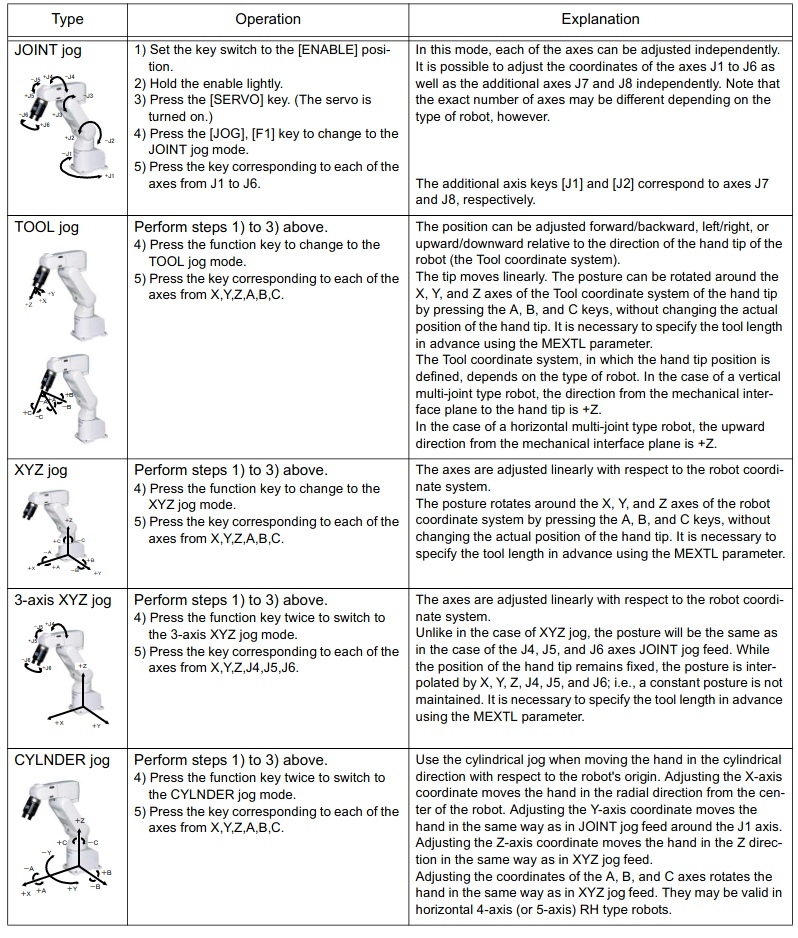

06 May 2021 07:57 #208098
Replied by Aciera on topic ROS LinuxCNC Link
I think it might be useful to have a reference document like the docs for my Mitsubishi robot. Doesn't really matter what manufacturer but I have this handy: www.electrobit.ee/web/file_bank/Manuals/...ons-detailed_ENG.pdf
From the above Document Section 3.2.1:
You seem to have created an application that lets me JOG the robot in two different modes:
"World"- which would correspond to JOINT mode ie. jog the six rotational joints of the robot
"Cartesian"-mode with "Euler-TCP" which would correspond to "XYZ" in the document.
1. Would it be possible to add what in the above document is called "TOOL - Jog"?
2 . Then since in your application we can jog the robot and there seems to be a "Teach-in" function I presume that we can save the current point and orientation to a file then jog to a different postion and orientation. Is that data stored as individual Points using joint angles?
3. Now say I want to write a program in GCODE to have the robot perform a task. If I take the line "G0 X0 Y0 Z0 A0 B0 C0" what does my robot do? Does it move the Hand to the Origin of the world coordinate system or does it move the six joints to their respective 0°
position?
position?

06 May 2021 09:03 #208113
by Roiki
Replied by Roiki on topic ROS LinuxCNC Link
What display are you targeting the gui on? I ask because that's way too dense for a 10" display. UR uses a 13" display and its not as packed as that. I suggest you break the functionality into 3 or more parts(mdi, jog, prog for example) and use tabs to make it more usable for small touchscreens. Otherwise it looks quite nice. Just not very touch friendly.
Also it would be nice if you would upload your code to github directly and not in zips. I'm no going to download random zips off the internet just to see some code.

Hi Roiki,
I thought about a wireless touch screen. But size is not defined. For now it's a process of complete the gui buttons etc.
If the gui is completed, we can split it up info tab's and define the exact display sizes it needs. Maybe i make 2 versions.
Yes, that is the extra button i talked about in previous post. This will jog the robot in tool direction.

Hi Roiki,
If users give their proposal for screen sizes, i can bring this info into the project.

This stay's a nice picture. Teaching a 3dspline, 3darc. Yellow=waypoint.
Teaching can be done quite quickly. I see now Velocity end is missing.
Can you think about the "Action" when teaching a point. With "Action" i mean what has to be done during the path.
