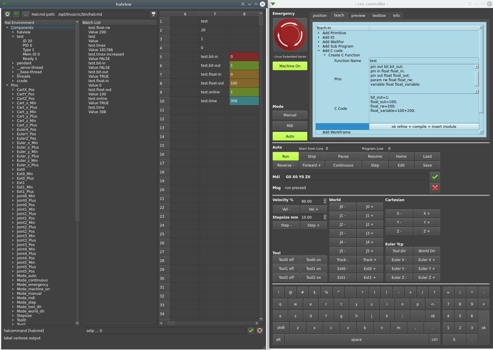

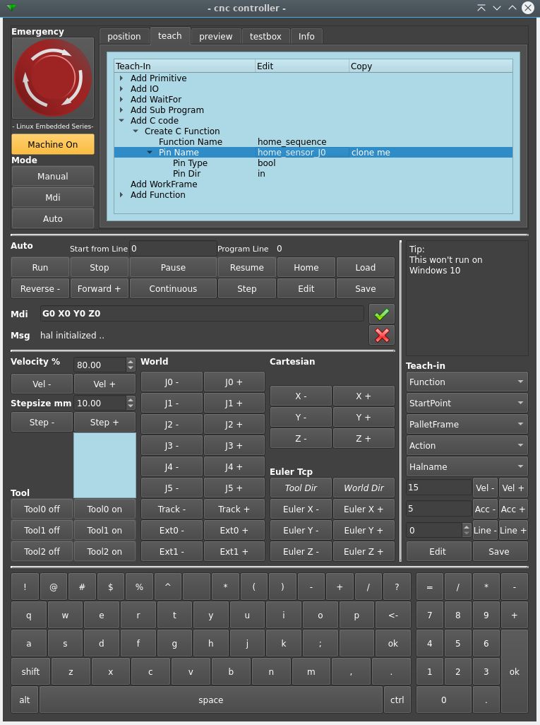

The teach in mode is as you pointed out. Forget about record feature for now.
Normally:
You jog to a position then the program point can be recorded. Then you jog to next position and record the next program point.
This is just as you pointed out.
When storing a program point i want to define values like :
1. What is the type of movement, is it a rapid, a 3d line, an 3point arc, a 3point(+) spline? Or is it teaching in a workframe?
2. Is it a startpoint, waypoint or endpoint of the above geometry, or is it a workframe point like a workframe origin?
3. What is the speed and vel of this move and if its a endpoint what must be the end velocity?
4. Must there be set a output or wait for input?
So far as i can see, this is a usuall way of teaching the robot program.
Every stored point can be edited by scrolling to it.
And you don't have to start alll over again. You can simply
start at a certain program line (teached point) and move to robot to it to edit the point.

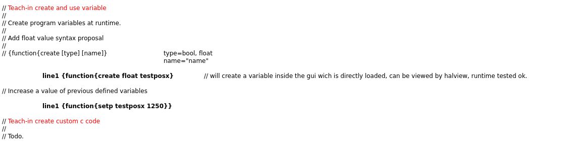

3. Make a (int) counter for x and make a (int) counter for y each time you visit the pallet workframe, and apply xy offsets.
Now how would we code that into the gui?
1. We can teach in workframe, that is done by selecting a few comboboxes.
2. We can teach in points, set grippers etc. no problem. We do this by selecting a few combo boxes.
3. Create x,y offsets with a counter and apply these offsets to a certan previous program (Line) point or say coordinate.

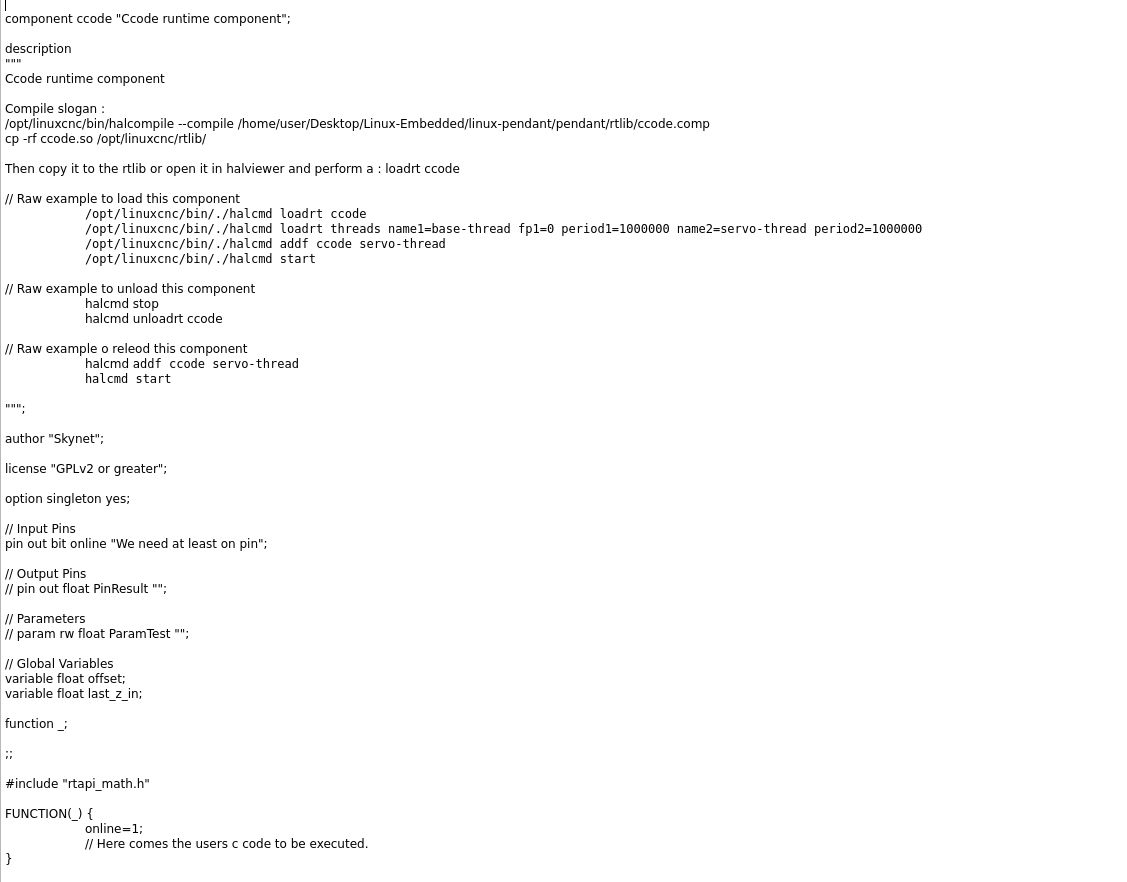

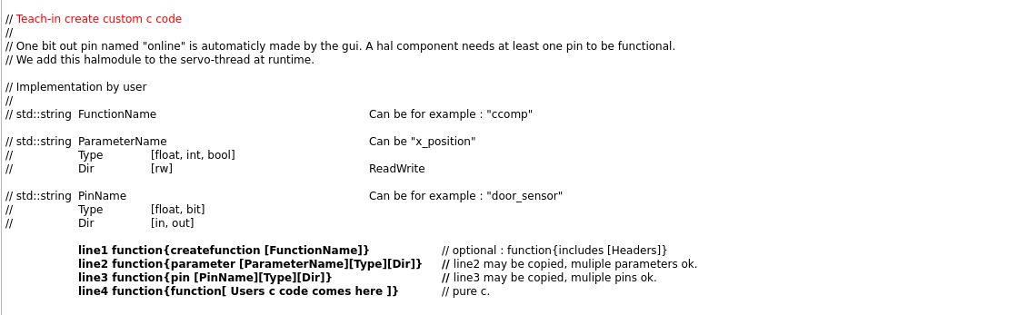

To prevent myself from coding various templates, i thought what if a user can input some c code into a teach-in program line.
Say you have a pallet.comp (c file that is going to be compiled automaticly by gui)
input value counter int : x_counter, y_counter
input value offset float : x_offset, y_offset
output value position float : x_pos, y_pos
Function routine : if x_counter==5, y_counter++.
With above code you can imagine a working pallet program.
At some point you have to stitch the above code into the program.
1. You or the gui can load the compiled pallet.com => pallet.so.
2. When doing a teach-in you can select a combobox named "Function". Inside that you pick the value "pallet.x_counter".
Then in second combobox you can set the "Increment value". For example "1";
3. During teach-in when you want to use position's produced by the component, like value : pallet.x_pos you select this
pos from combobox input.
4. Maybe think about a tree widget program structure? I can imagine you want to insert a complete subprogram at once.

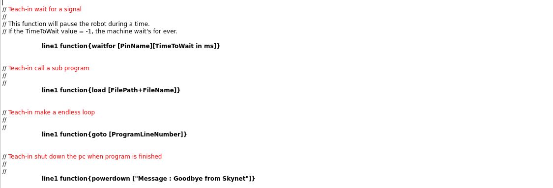

08 May 2021 14:31 - 08 May 2021 17:11 #208333
by Grotius
Replied by Grotius on topic ROS LinuxCNC Link
Hi Arciera,

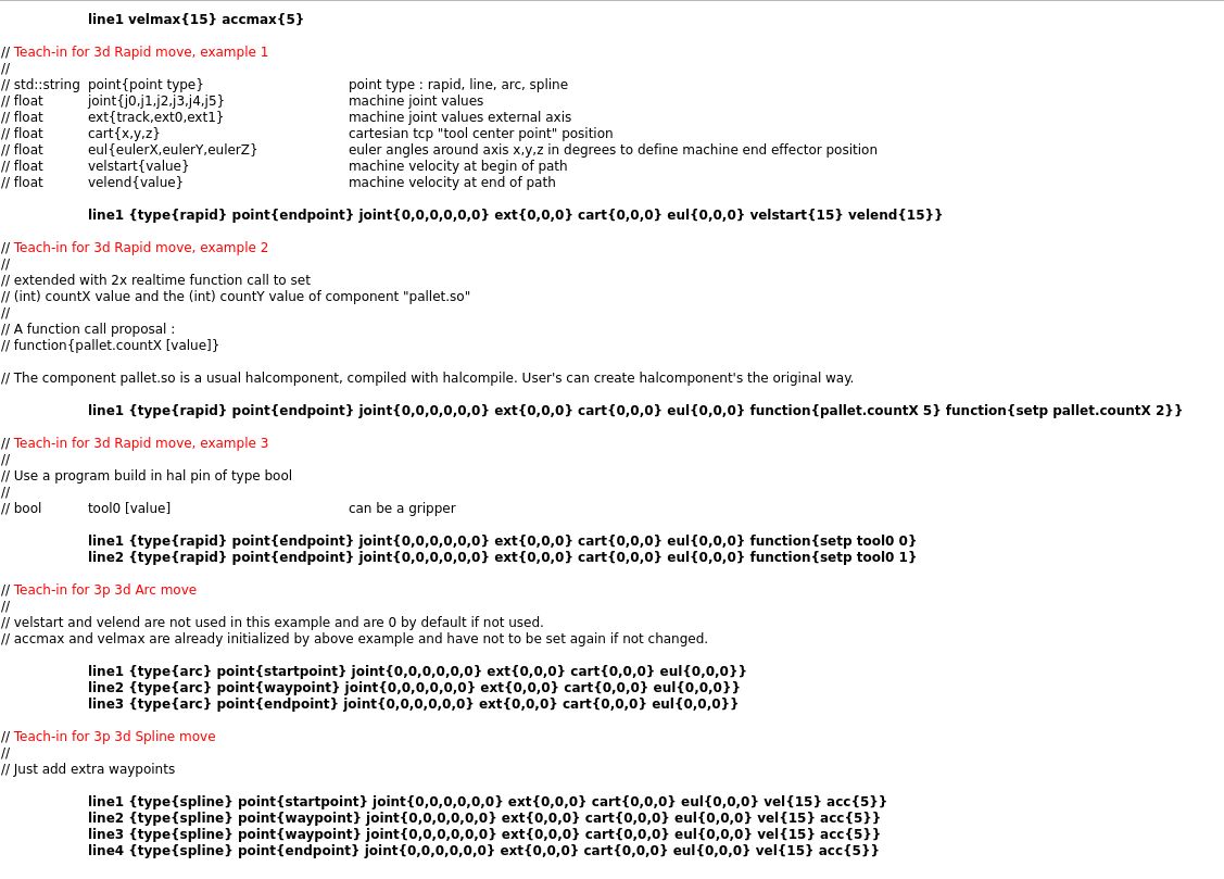

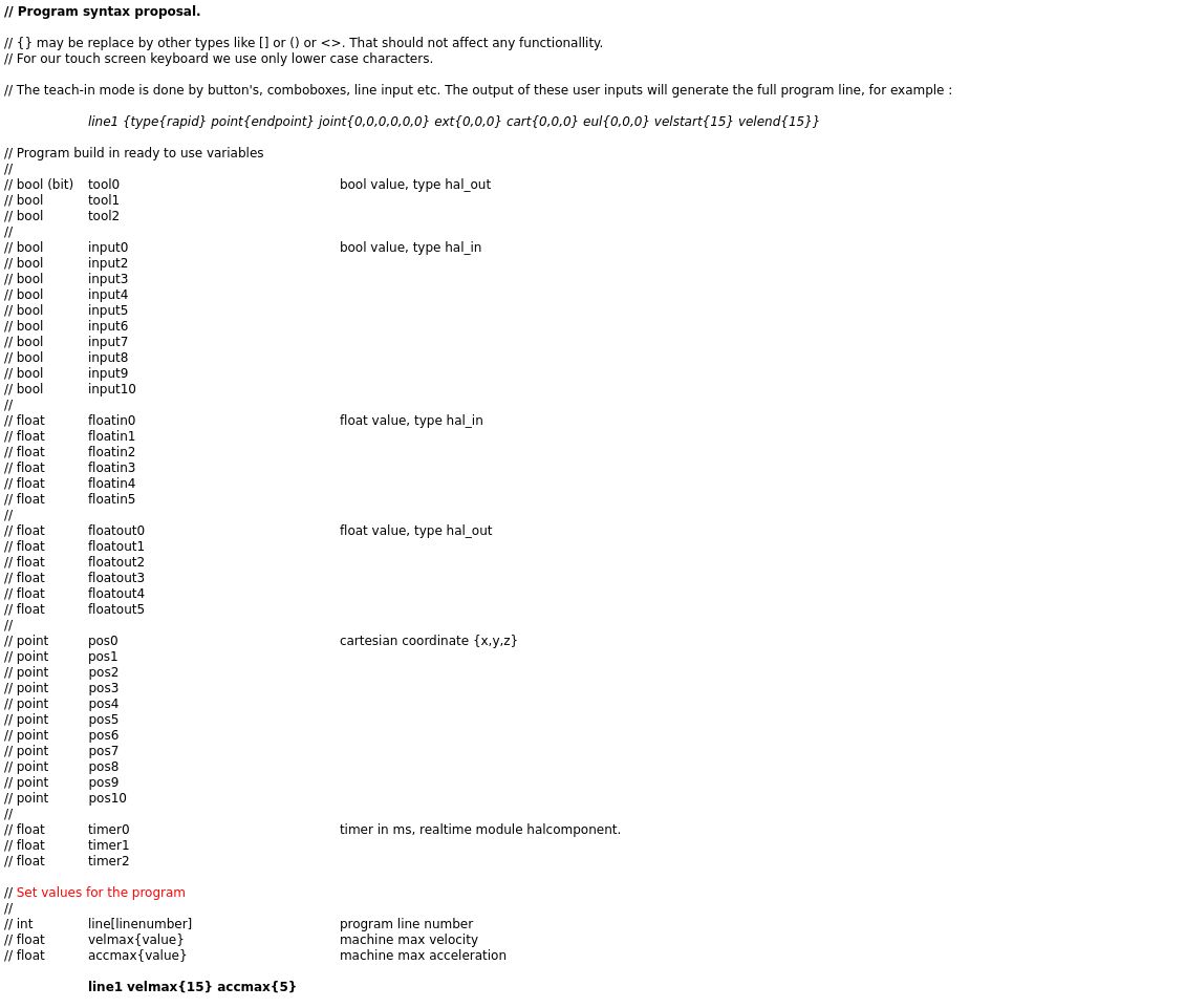

The most fundamental question I still have about your application is what the programming SYNTAX is going to look like.
It would be c style. But you only need it when you need to write complex program's.Compiling, loading etc is done by the gui framework.
So you don't have to install qt creator.
A syntax like python is a no go for me.
A syntax like g-code can be applied in the future. I already have a postprocessor to converse gcode into primitives like arc, line, etc wich can be converted to something the robot can work with later on.
That would be very useful as those softwares can usually detect collisions by use of STL models of the robot and it's environment. Inside the opencascade we have this option already. Can be implemented in future.
The used syntax will also be important to anybody who wants to write a PostProcessor for third party software (eg roboDK) to create programs for their robots.
Program's like robotDK are not compitible. It can not read in a function call to a realtime module and show what is going on. Ok. I plan to setup a short example how the program syntax will look like.

08 May 2021 17:02 - 08 May 2021 17:04 #208340
by Grotius
Last edit: 08 May 2021 17:04 by Grotius.
The following user(s) said Thank You: tommylight, Aciera

08 May 2021 21:29 - 08 May 2021 23:56 #208352
by Grotius
Creating and using c code in the robot program is tested ok.
It was a tiny puzzle to solve.
My implementation proposal :
What the implementation produces and compiles behind the screen looks like :
What here is done, is more orr less a administrative task. It looks like halmodule refining.
4 lines of code is not bad to load pure c code.
At last a few one liners for fun :
Now building up the treewidgets in the touch screen, will start with the most difficult one, adding c code :

Thanks for the examples.
To come back to my favourite question, how would we choose the Mode of movement (ie JOINT-,XYZ-,TOOL-mode) ?
Is it determined by the parameters given?
So if I wanted to execute a Joint move (ie without using the kinematics/inversekinematics) would I write:
line1 {type{rapid} point{endpoint} joint{90,90,0,148,62,-95} velstart{20} velend{20}}
If I then wanted to execute a move in XYZ cartesian mode (ie using the kinematics/inversekinematics):
line2 {type{line} point{endpoint} cart{100,200,10) eul(0,45,-45} velstart{20} velend{20}}
Is it possible to simulate the program before running it on the physical robot using a graphical STL model?
