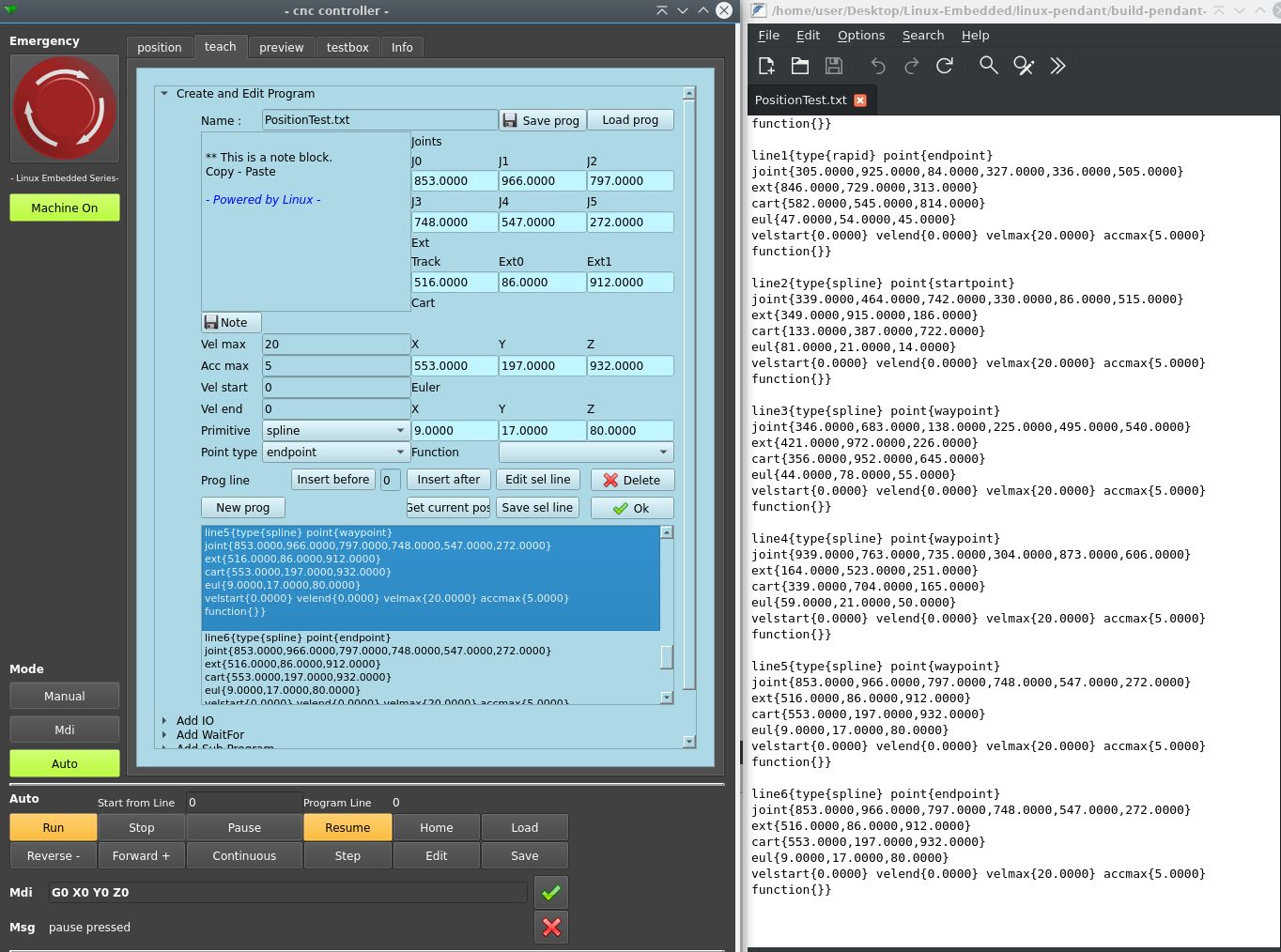

11 May 2021 05:54 - 11 May 2021 07:00 #208534 by Grotius
Replied by Grotius on topic ROS LinuxCNC Link
Hi Arciera,
If you clone it and build it without git checkout, i think it will be up to date.
[edit]
I did some work for the teach-in function.
It can now teach all points. It can insert points before and after a certain programline. It can edit and save a program line.
It can delete a random selected programline.
When edit's, insertions or deletions are done, the programlines are automatic renumbered.
Saving is tested ok. I have to code the file loading sequence now.
For file extension i used the simple .txt extension. :dry:
For coding the treewidget i used a different methode, using stackedwidgets.
Coding the treewidget by texteditor is not a nice way. So i code a treewidget structure and then i add a stackedwidget page
at the right place. This stackedwidget holds all the button's etc.
I think when you look at the file output, everyone can understand what is going on.

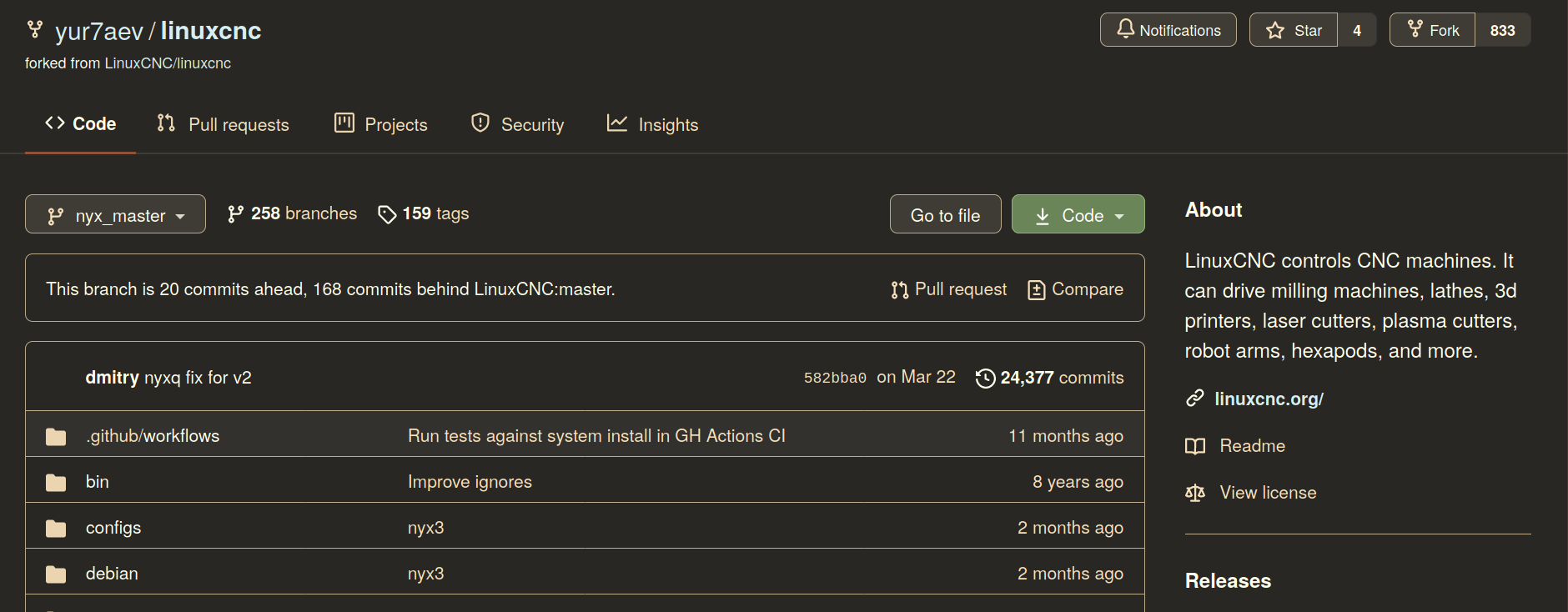

Hm, I did:
git clone git://github.com/grotius-cnc/linuxcnc.git linuxcnc-robotapp-dev
cd linuxcnc-robotapp-dev/src
./autogen.sh
./configure --with-realtime=uspace
make && sudo make setuid
cd ..
source ./scripts/rip-environment
But all I see is linuxcnc-master. Even all the nyx stuff is missing.
[edit]
Are you sure you forked the correct branch? github.com/yur7aev/linuxcnc/tree/nyx_master
Last edit: 11 May 2021 07:06 by Aciera.
