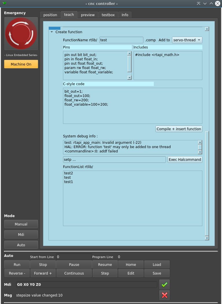

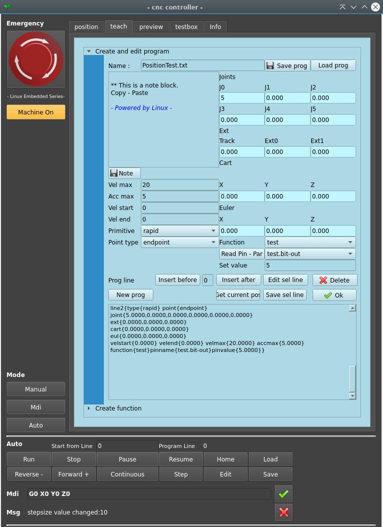

I had to expand the syntax a little. At the function section we have extra added "pinname" and "pinvalue".
At the combobox "Function" user can select the function they want to use.
Then it indexes the pin's of that function by pressing on the button "Read pin-par", then the value can be set.
Searching in hal for the child's of a component had to be coded. It took a while.
When you want to set multiple function's at the same time. You have to add a extra point with other function value's.
Then for the creation of the function i did some work.
It now display's debug information. When you have a typo in your function, it will be mentioned.
Also a halcommand can be done.
It load's all previous written function's in a list.
At the syntax display, section "functon" i have to define where the function has to added. To servo- or base thread.

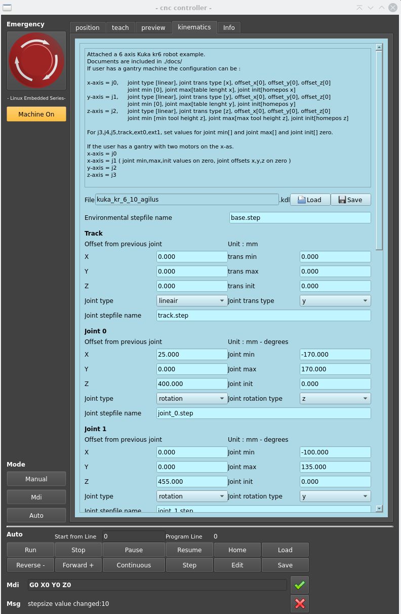

Just curious, do you have a gantry or a robot?
Today i added the kinematic configuration. It can save and load configurations already.
The sample configuration is a kuka kr6.
I was thinking how to add a configuration for a gantry machine. This is quite easy to do.
Even when the gantry has 2 separate x axis motors, it is quite easy to realise in the config.
The homing procedure has no priority at the moment.
This info is enough to setup the kdl kinematics model.
I already have stored the data in a vector bucket when the contiguration file
is loaded and saved.
All value's like "joint max" and "joint min" etc are visible in hal as pin's
Next thing to do now is load the stepfiles in the opencascade preview screen and apply the
offset and rotation matrixes to the invidual part's given by the kinematics input value's.
After that we can connect the opencascade cad machine model to the gui joint values.

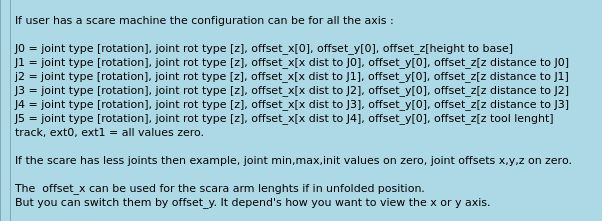

Mavbe an example for a SCARA robot would be interesting?
