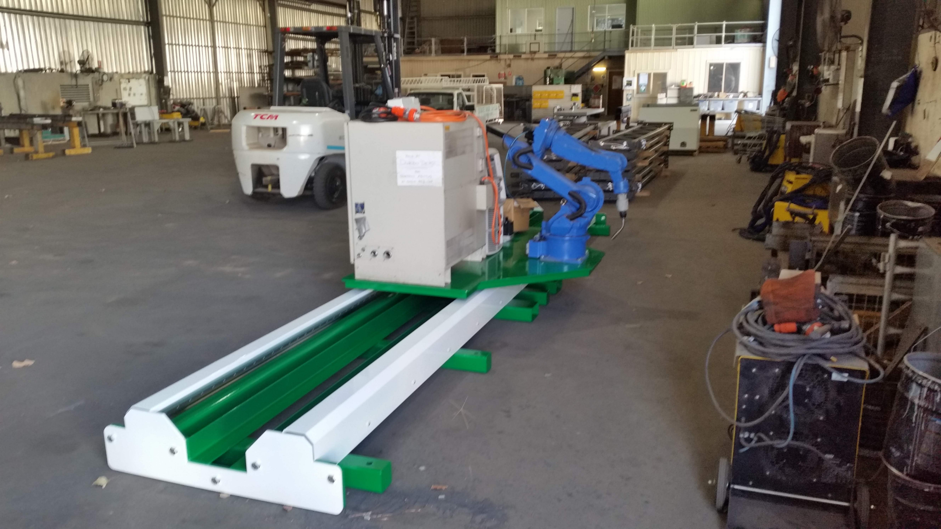

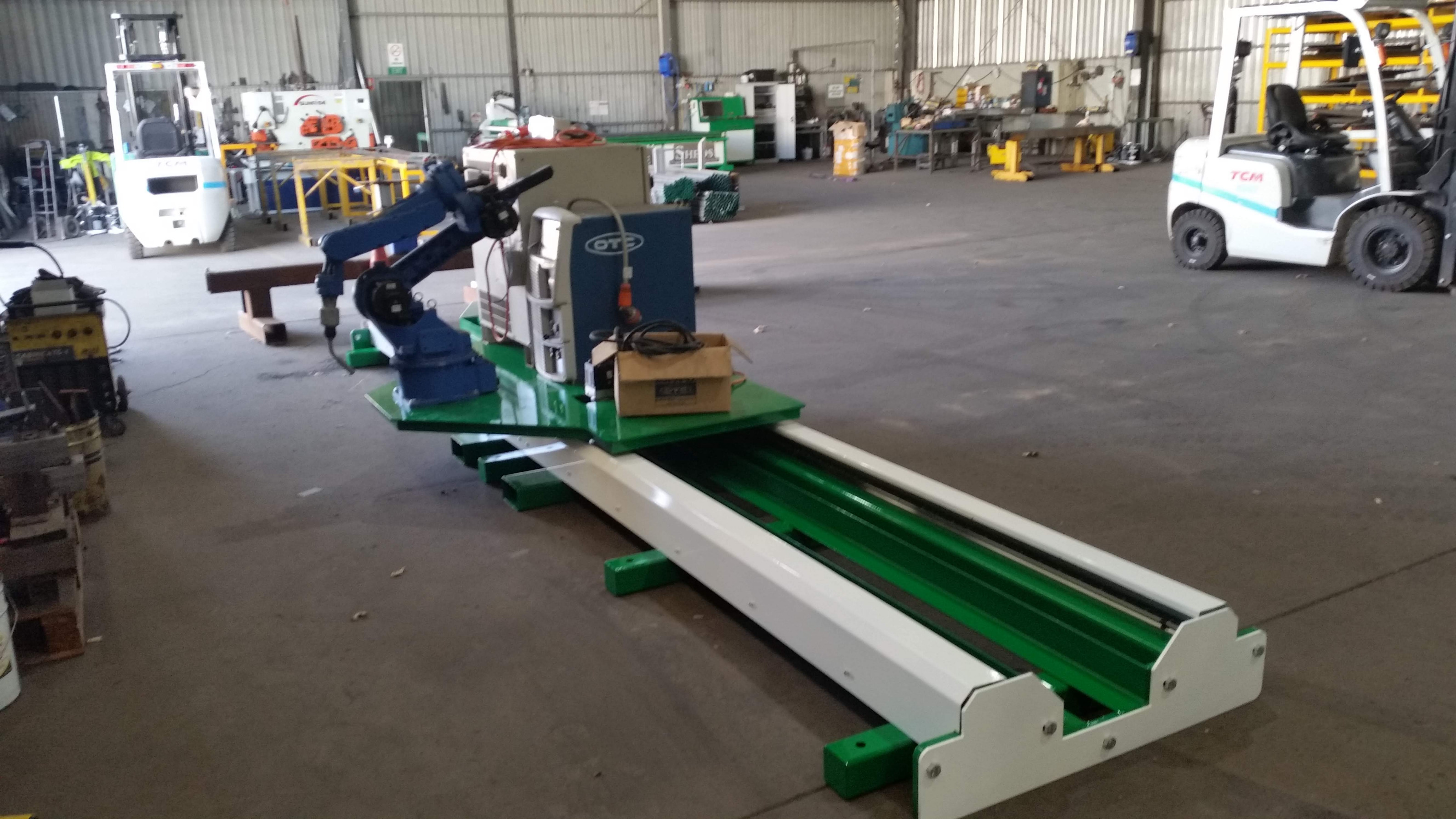

If we can get something working, I have a couple of industrial robots I can use to test out the software.
One thing I will need is the ability to control external axises, I have built a track that I plan to use to weld long trusses,
I have asked Daniel about if they plan to release the software and he said not in the near future.

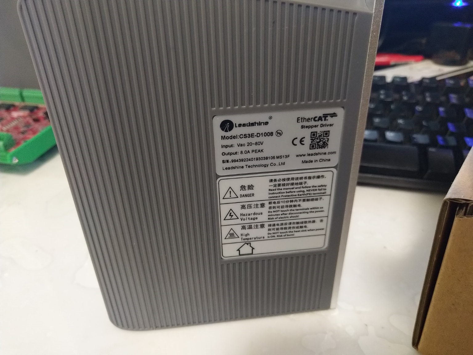

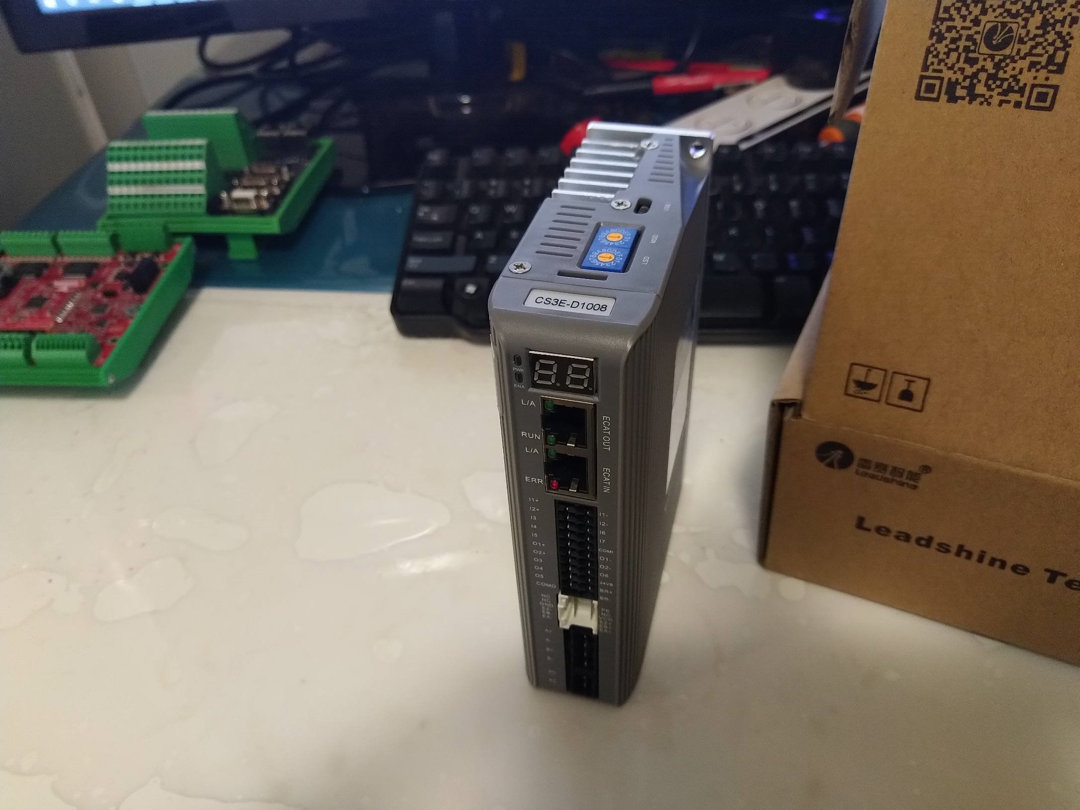

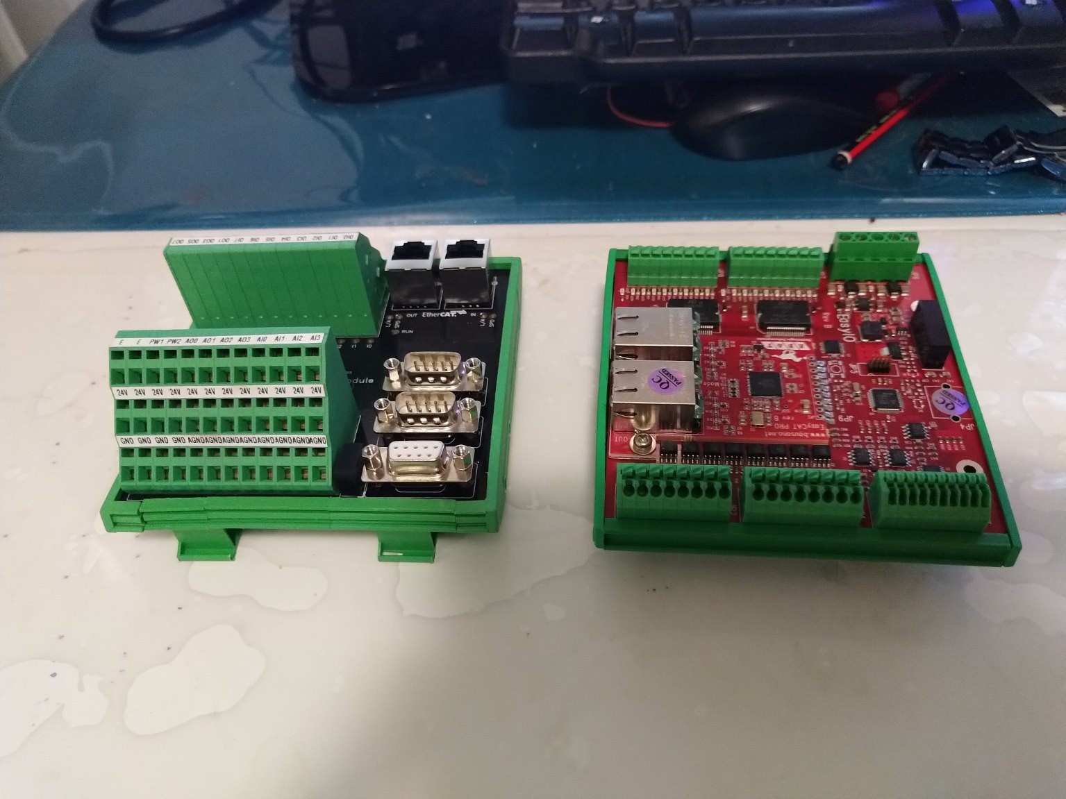

I have six Ethercat closed loop stepper drivers and some I/O modules,

For the ethercat leadshine's.
Maybe we can ask Chimeno to get the config file for this.

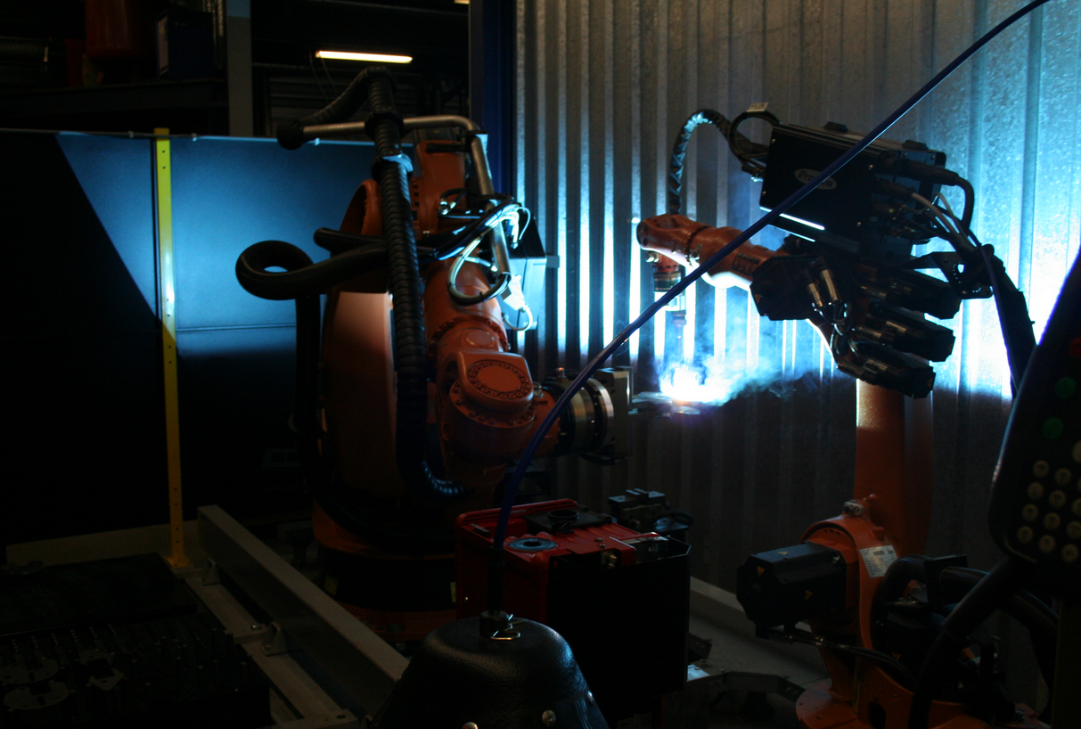

One of my welding projects, i think 15 years ago, last year i heard it was still running :
Attached 2 robot programs parts of a robot backup.
Maybe we can use them for setting up the code standard.
One is the big handling robot, the other is the welding robot.
