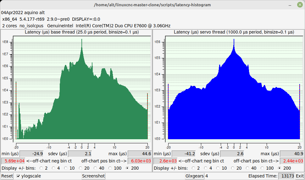

04 Apr 2022 16:28 #239263 by RGH
120us jitter is worse than what you posted initially.
Assuming you still have that wonky radeon gpu installed, remove it and go onboard graphics.
Otherwise any positive effect that bios settings or kernel params could provide, will be completely invisible in the 'latency test'. The only observable change would be the shape of the 'latency histogram' (not the max+/- deviations).
Regarding mem config, dual-channel / paired dimms is the only way to go. I wouldn't bother experimenting with that. The only thing that improves latency on core2 is switching memory straps but that's in the realm of 'honing' some microseconds and getting a 'pointy' histogram curve / reducing standard deviation.
Still - I don't see how the initial ~30us latency you had could lead to a stuttering axis. Assuming the base thread timing is adequate for the given latency that shouldn't happen. Also why only in auto mode and not while jogging and why only on one axis?

05 Apr 2022 03:21 - 05 Apr 2022 03:22 #239299 by clunc
Update: latency-test is down to 33000 ns base. With (4) glxgears, (4) glxheads, youtube with 12 tabs and playing (4) youtube movies. 'latency-histogram --show' attached.  The histogram looks terrible again.
BIOS changes:
1. I went through the BIOS point-by-point again, following Nebur's checklist. I had had S.M.A.R.T. disk-monitoring and Fan-Control Override both Enabled. I disabled them now.
2. Aside: I noticed that several options on Nebur's list were missing from my BIOS; "USB for Flex bay" and "HDD Acoustic Mode" being examples. It may signal a BIOS update is available.
Video change:
1. Removed the PCI-e DVI-D video card, and reverted to motherboard VGA.
Memory changes:
1. Removed the 2 GB stick and put the 4 GB pair in DIMM-3 and DIMM-4 (the blacks: following @tommylight's instruction).
Parallel port:
1. I had early-on disabled the motherboard parport in the BIOS and begun using one of the two parport PCI cards. The tests were run with this configuration.
The off-chart bin counts on the latency-histogram are still bad.
Last edit: 05 Apr 2022 03:22 by clunc.
