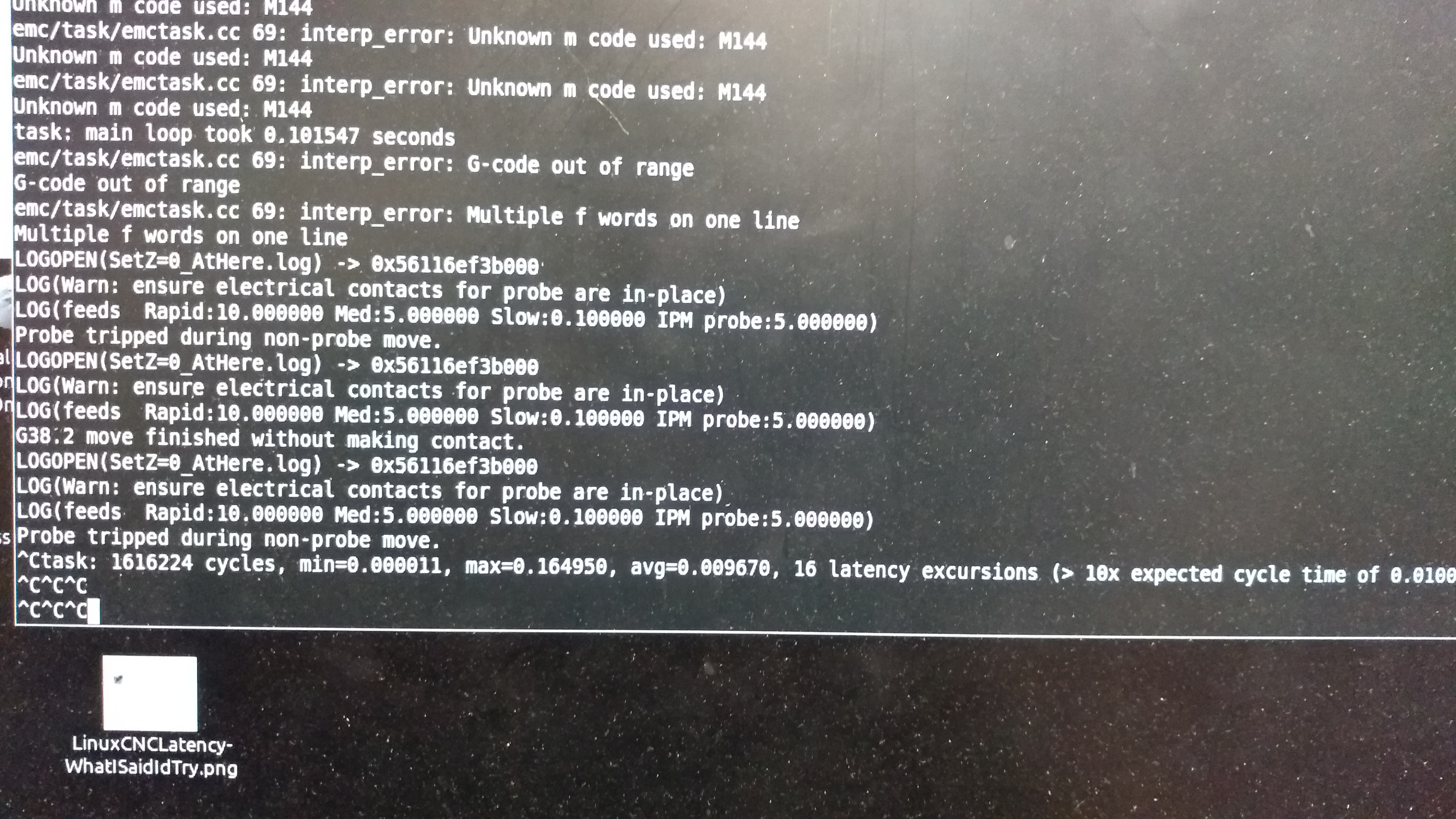

06 Apr 2022 19:24 #239464 by clunc
Tried a model. Failed. Lost steps.
I managed the rough cut which was relatively simple, with a 1/2" endmill @80ipm.
However the back-and-forth passes of a 1mm roundnose @120ipm lost steps after perhaps 2 dozen passes. I'd left the room after assuring myself that it seemed stable.
However, the first passes were also relatively smooth. As the majority of the model is carved relief text, there is much more acceleration/deceleration required in those parts and it appears that it failed as it entered that area. I discovered it after I returned to check on it.
After I shut it down, I "posed" the model in the AXIS GUI and snapped a picture and was attempting to jog the head out of the way so I could take a comparative picture of the model when LinuxCNC locked up and became unresponsive to the mouse and keyboard, and Ctrl-Cs in the terminal failed to interrupt it.  I had to force the terminal window closed to kill it.  Even at that, it said LinuxCNC was still running when I restarted it.
I've attached pictures.  The second is a terminal message about 16 latency excursions (I'd have expected 100s if not 1000s). "16" may correlate with the number of passes in the more complicated area of the model before I shut it down.
The finish pass begins from the lower-left of the model and then cuts left-to-right (+X), then steps up (+Y) a fragment of the width of the 1mm cutter, then cuts right-to-left (-X), steps up (+Y), etc.
Axis accelerations and velocities are copied from the last setup, and the CNC itself is capable of executing them, and each axis performed acceptably with those accelerations in stepconf.
I'll attach .ini and .hal files for completeness sake.
The lockup makes it appear to more serious a problem than losing steps.
