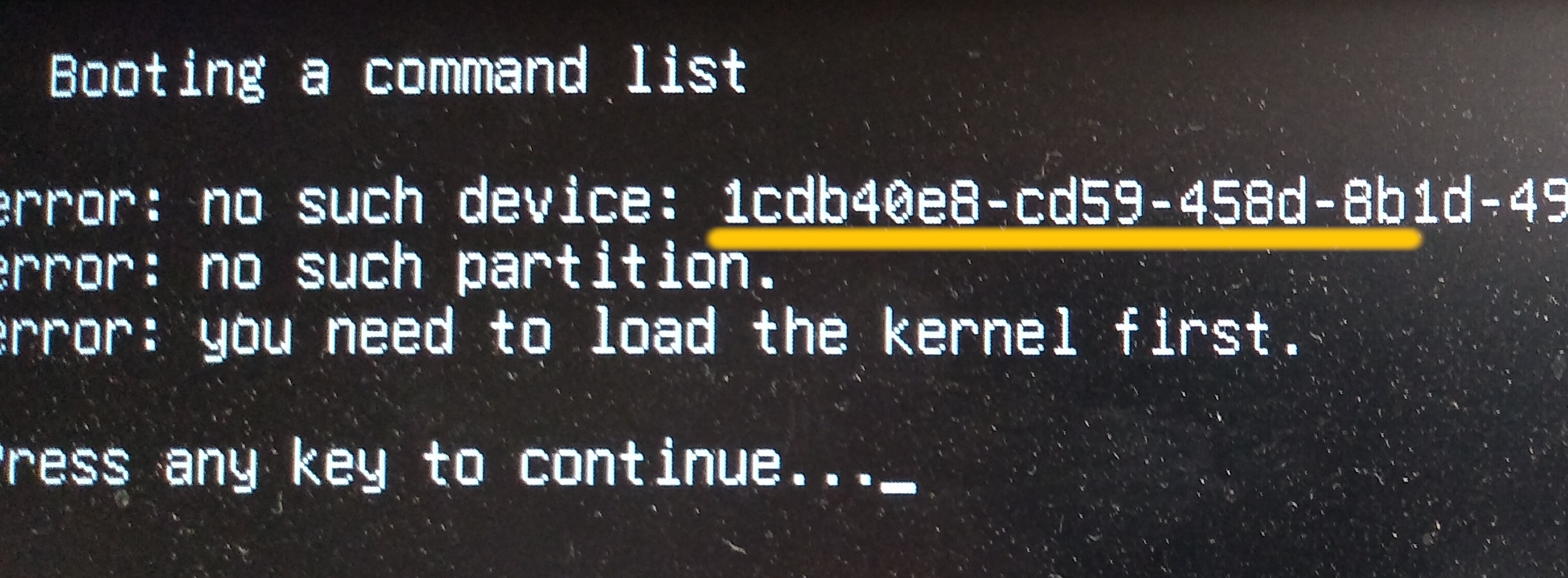

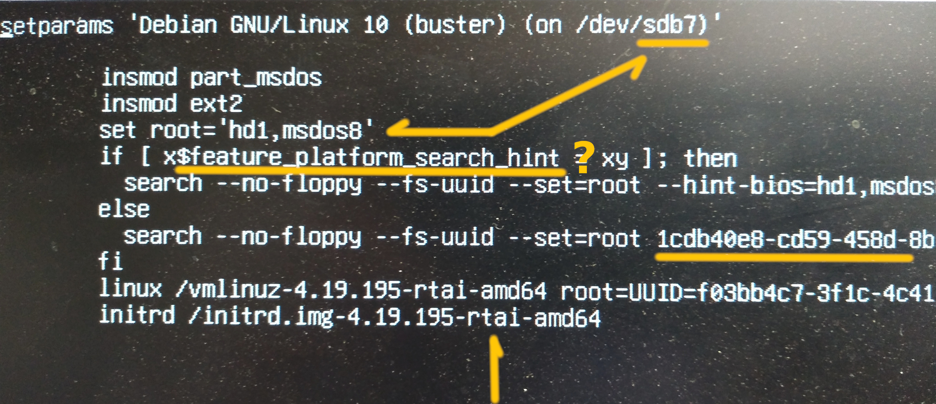

13 Apr 2022 15:57 - 13 Apr 2022 15:58 #240156
by clunc
Replied by clunc on topic Successfully configured with stepconf: but +Y-axis "stutters" running G-code
I repeated the install with the steps and decisions I had taken the first time.
It has failed again.
I've attached a pic of the boot entry in grub for the Debian 10 os on drive /dev/sdb7 (hd1; msdos) and for the subsequent "partition not found" error message when that entry is selected.
Note the peculiarity in the grub entry referring to an 'rtai' image. Note also in that pic the long hex number which is referenced in the second. Once again, I called for both the /boot and the /root partitions (sdb7/sdb8) to be formatted.
The reference to the long-hex in the second screen leads me to believe I should have somehow enabled the option signified by a '?' on the first screen.
Bizarre.

13 Apr 2022 16:17 #240158
Replied by andypugh on topic Successfully configured with stepconf: but +Y-axis "stutters" running G-code
I am confused now. Is this a standard Debian 10 installer or the dodgy one that I made?
