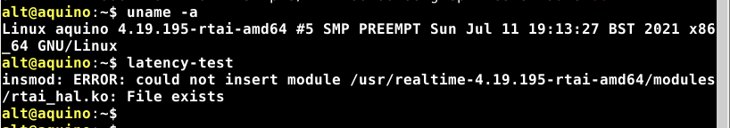

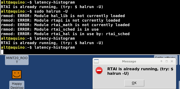

14 Apr 2022 03:56 #240204
by clunc
Replied by clunc on topic Successfully configured with stepconf: but +Y-axis "stutters" running G-code
Successfully installed the 4.19 RTAI kernel. Confirmed by uname.
Both latency-test and latency-histogram throw errors.
Screenshots attached.
(latency-test's reads:
insmod: ERROR: could not insert module /usr/realtime-4.19.195-rtai-amd64/modules/rtai_hal.ko: File exists
(latency-histogram's reads:
RTAI is already running, (try: $ halrun -U)
(but $ sudo halrun -U complains:
rmmod: ERROR: Module hal_lib is not currently loaded
rmmod: ERROR: Module rtapi is not currently loaded
rmmod: ERROR: Module rtai_math is not currently loaded
rmmod: ERROR: Module rtai_sched is in use
rmmod: ERROR: Module rtai_hal is in use by rtai_sched
I did attempt to launch latency-histogram while latency-test was running (but hung), possibly explaining the former's complaint and advice to run 'halrun -U', but running it even as root did not solve the problem.
I have no insights about how to go about resolving this. Can you advise where to start?
Thank you.

- Posts: 19896
- Thank you received: 4648
14 Apr 2022 14:58 #240236
But you should never get this issue after a clean start unless you have loaded LinuxCNC or the latency test.
Try the RTAI-provided tests:
First calibrate: sudo /usr/realtime-4.19.195-rtai-amd64/calibration/run
Then run the text-mode latency test: sudo /usr/realtime-4.19.195-rtai-amd64/testsuite/run
Replied by andypugh on topic Successfully configured with stepconf: but +Y-axis "stutters" running G-code
The only reliable way to recover from this "File exists" problem is to reboot. It means that something has trued to start realtime and crashed without exiting cleanly.I have no insights about how to go about resolving this.
The following user(s) said Thank You: clunc

I installed LinuxCNC from the Debian 10 .iso onto a 16GB USB thumbdrive and successfully booted into it and then patched it with the RTAI kernel following
"Section 7.2" steps in LinuxCNC install
The very next step was to try to do a calibration run, following Andy's instruction:
% sudo /usr/realtime-4.19.195-rtai-amd64/calibration/run
I could not do the next suggested, text-mode latency text
% sudo /usr/realtime-4.19.195-rtai-amd64/testsuite/run
because the first command never returned (even after leaving overnight). Ctrl-C wasn't enough to kill it either, although it was sensible enough to respond to a 'kill -HUP'; so it wasn't in outer space.
The output of
was (including my attempts to interrupt it with Ctrl-C):
.runinfo is /usr/realtime-4.19.195-rtai-amd64/calibration/.runinfo
No RTAI modules loaded.
Running insmod on /usr/realtime-4.19.195-rtai-amd64/calibration/.runinfo...
^C
^C^C
^C
To recap, this is a fresh install of Debian 10 Buster with a 4.19.195 RTAI kernel installed and confirmed by reboot and 'uname -a'.
Running RTAI's own 'configuration' step goes off into the weeds never to return. (The followup 'latency-test' run both complains the a module is missing and the same module cannot be removed because it's "in use.") The first step needs to succeed.
I am now completely baffled and have sat down in the road to await help from a passing motorist.
The Dell Optiplex 780 is destined for the curb if none comes along.
