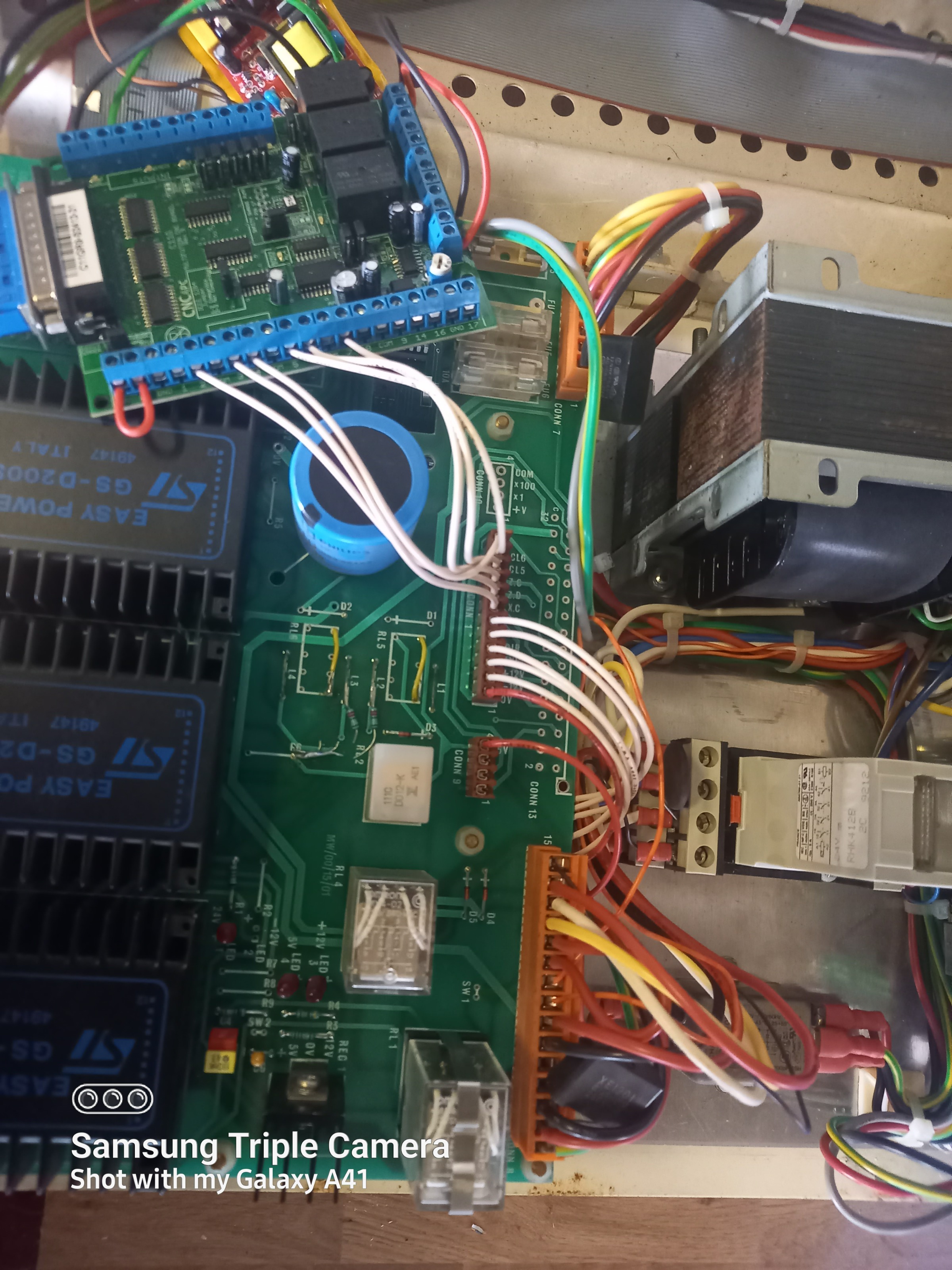

Hi allI just set up the computer on the lathe and turned on. I went to stepconfig to config a new file to test axis for some reason x won't move but z works fine I can here a click inside like it wants to do something any ideas where to look 1st.? Also noticed this in back of machine not sure if this was like it before 2 soldered wires unattached has anyone got schematics or pictures of same machine? And know what the do

- Posts: 4811
- Thank you received: 2164
06 Oct 2022 05:23 #253588
Replied by Aciera on topic Turret Rotating to fast and missing steps
Sounds like you haven't got the estop signals right in the hal file. I think the boxford config uses an external estop signal while you might not.
