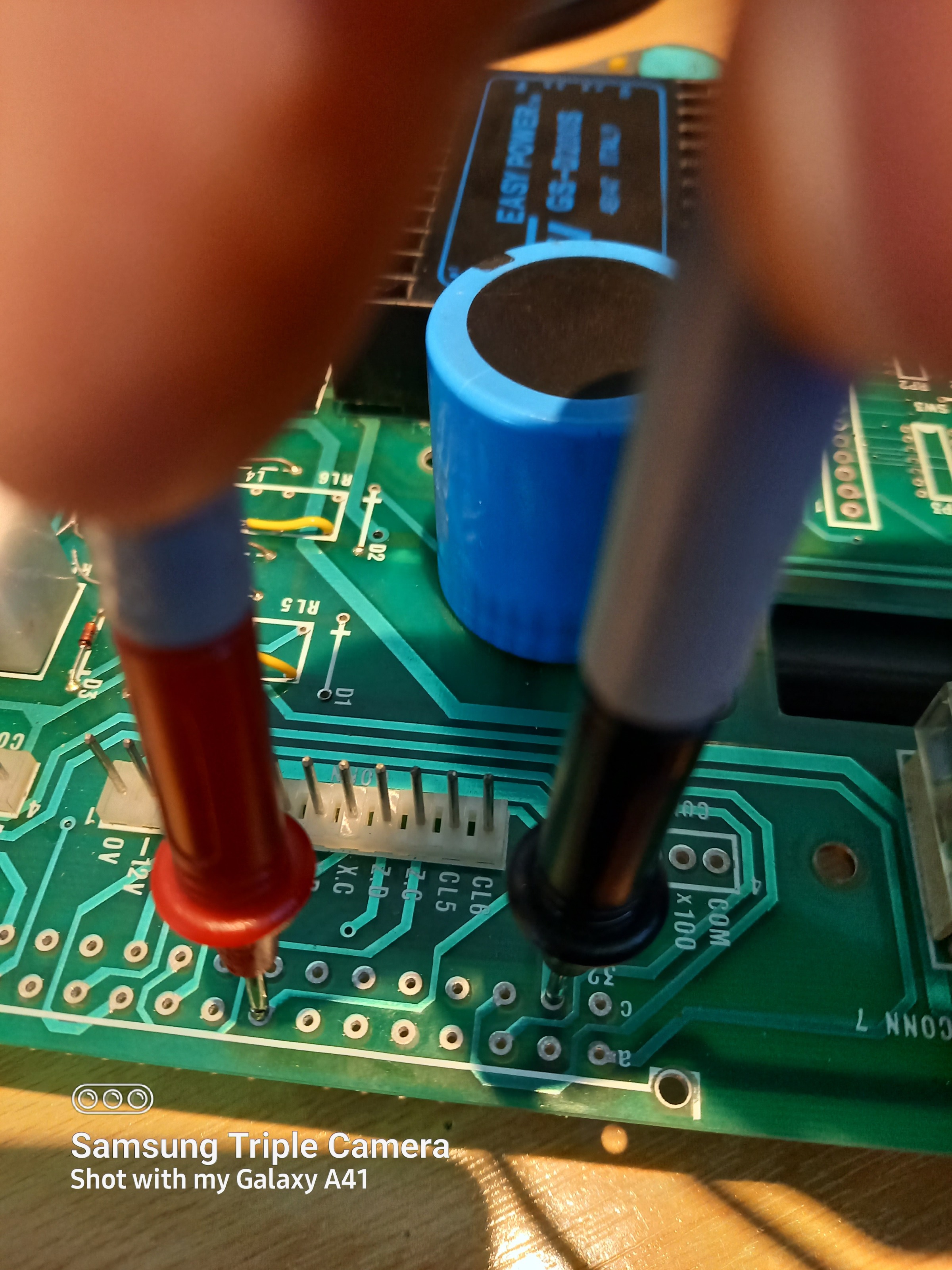

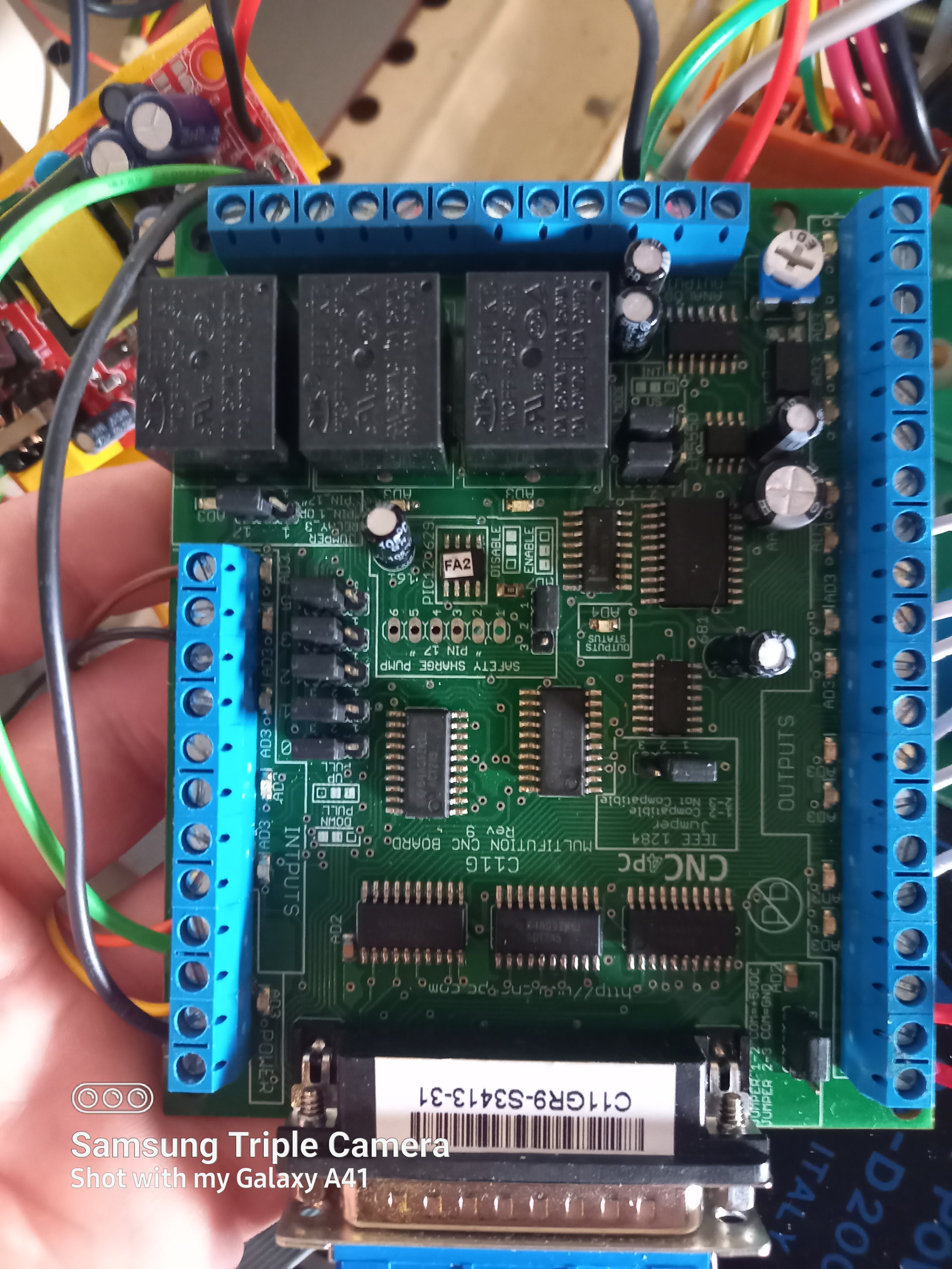

Am I correct a signal gets sent to the bob and when it supposed to change direction does It flick a relay. On the board .?
- Posts: 4811
- Thank you received: 2164
07 Oct 2022 17:43 - 07 Oct 2022 17:45 #253709
Replied by Aciera on topic Turret Rotating to fast and missing steps
A relay would be unusual for a direction signal. From the parallel port pin it would likely go through an optocoupler and that would change the signal going to the motor drive.
edit:
the easiest would be to use a voltmeter and check if the voltage changes when changing direction.
edit:

Hi
Where do I check and how I have a multimeter but not really a electrical person trying to learn.
Without you guys I wouldn't have got this far so thanks
- Posts: 4811
08 Oct 2022 11:36 #253745
measure the voltage between GND and the Outputpin that carries the direction signal on the breakout board. alternatively you can switch the wires from the direction signal of the X and Z axis and see if the symptom moves to the other axis.
The following user(s) said Thank You: Turners

- Posts: 4811
08 Oct 2022 12:54 #253752
On the parallel port pins you should see voltages no higher than 5V so set the volmeter to the "20V" range.

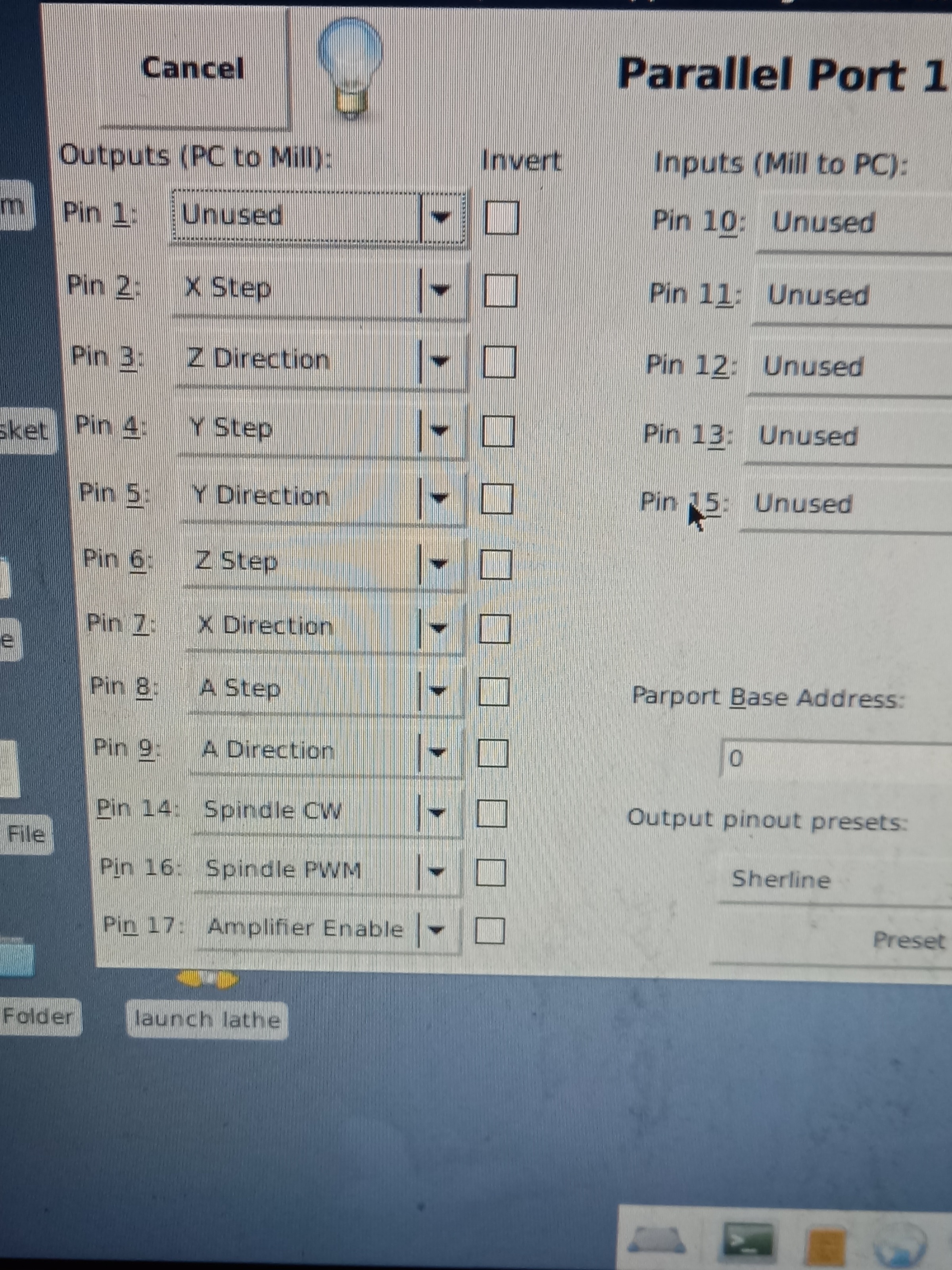

- Turners
- Posts: 74
08 Oct 2022 15:05 #253754
by Turners
Replied by Turners on topic Turret Rotating to fast and missing steps
Multimeter not working for me lolDo you mean if I change like thisIt tested x and the axis only moves one direction is that what you mean?

- Turners
- Posts: 74
08 Oct 2022 15:54 #253760
by Turners
OK if I change pin3 and pin 7 x moves up only
and z does the same
and z does the same
- Turners
- Posts: 74
08 Oct 2022 17:39 #253766
by Turners
If I change a axis pins to different pins say 8 and 9 if that stays the same ie a spins one way on both buttons does that tell me a boards gone ?
