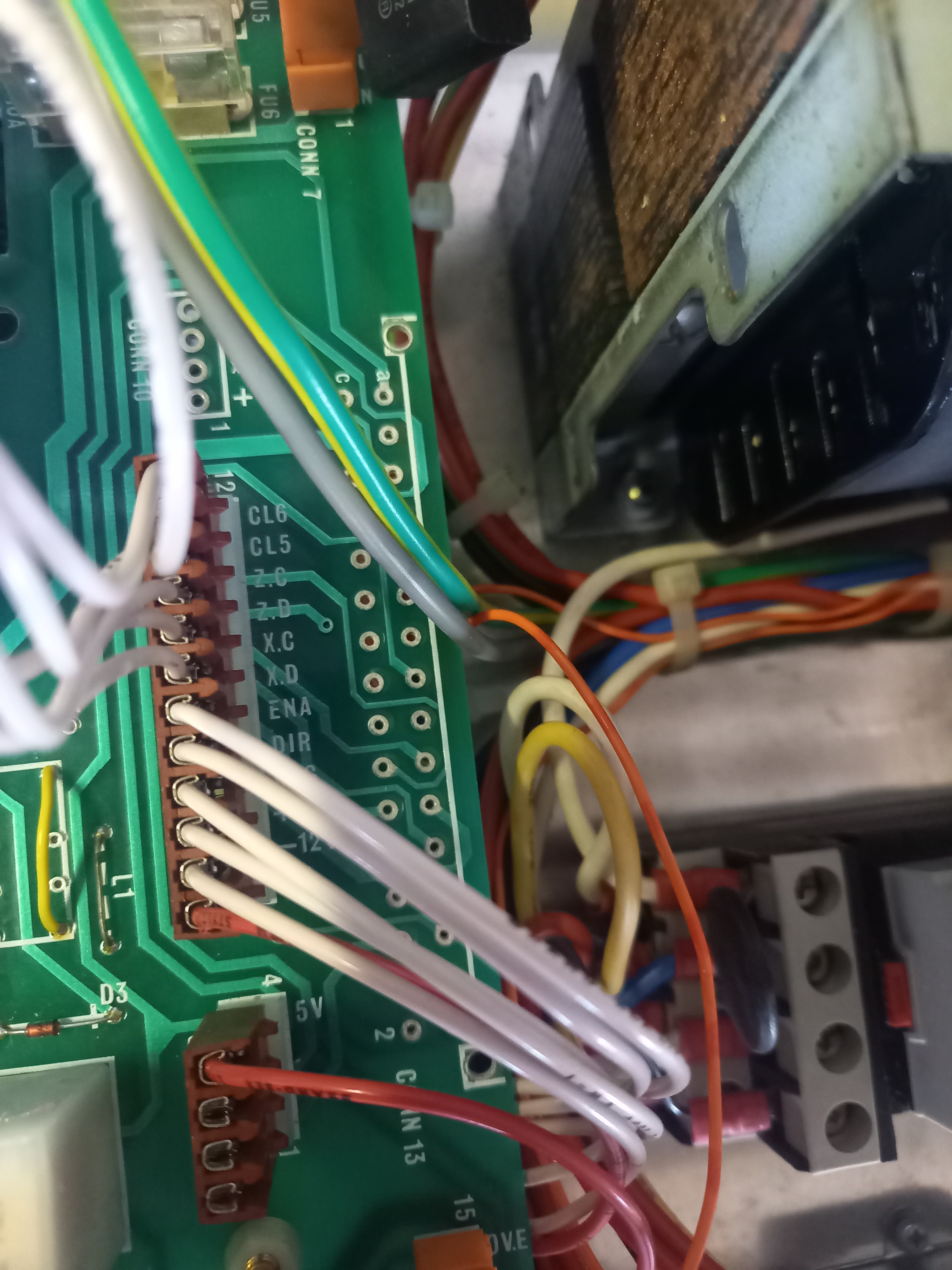

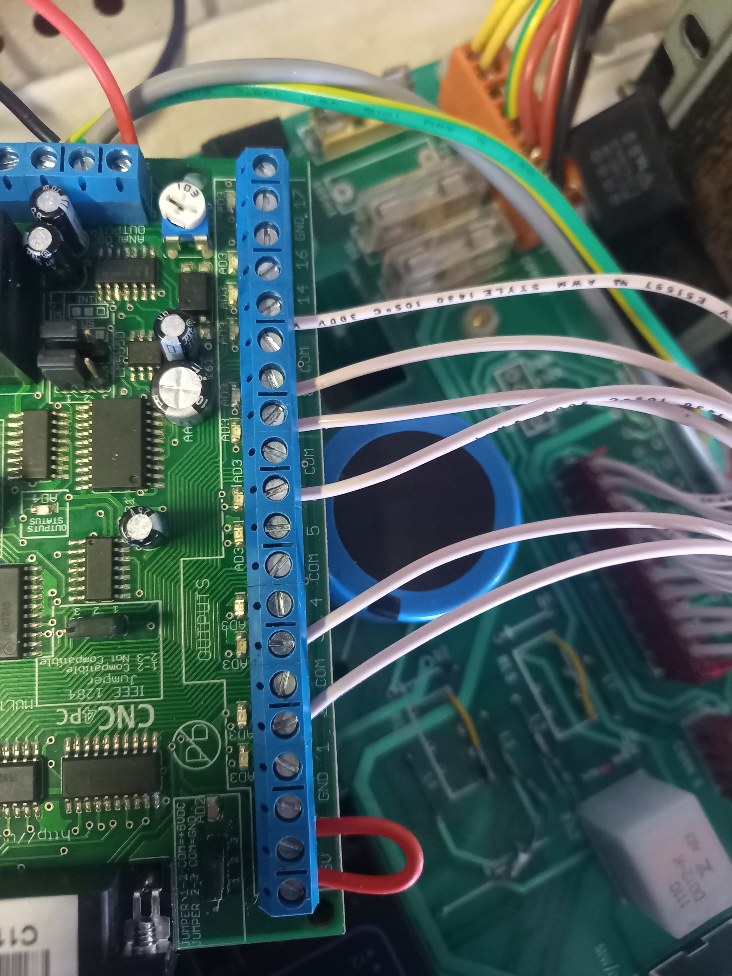

Pictures of the wiring?

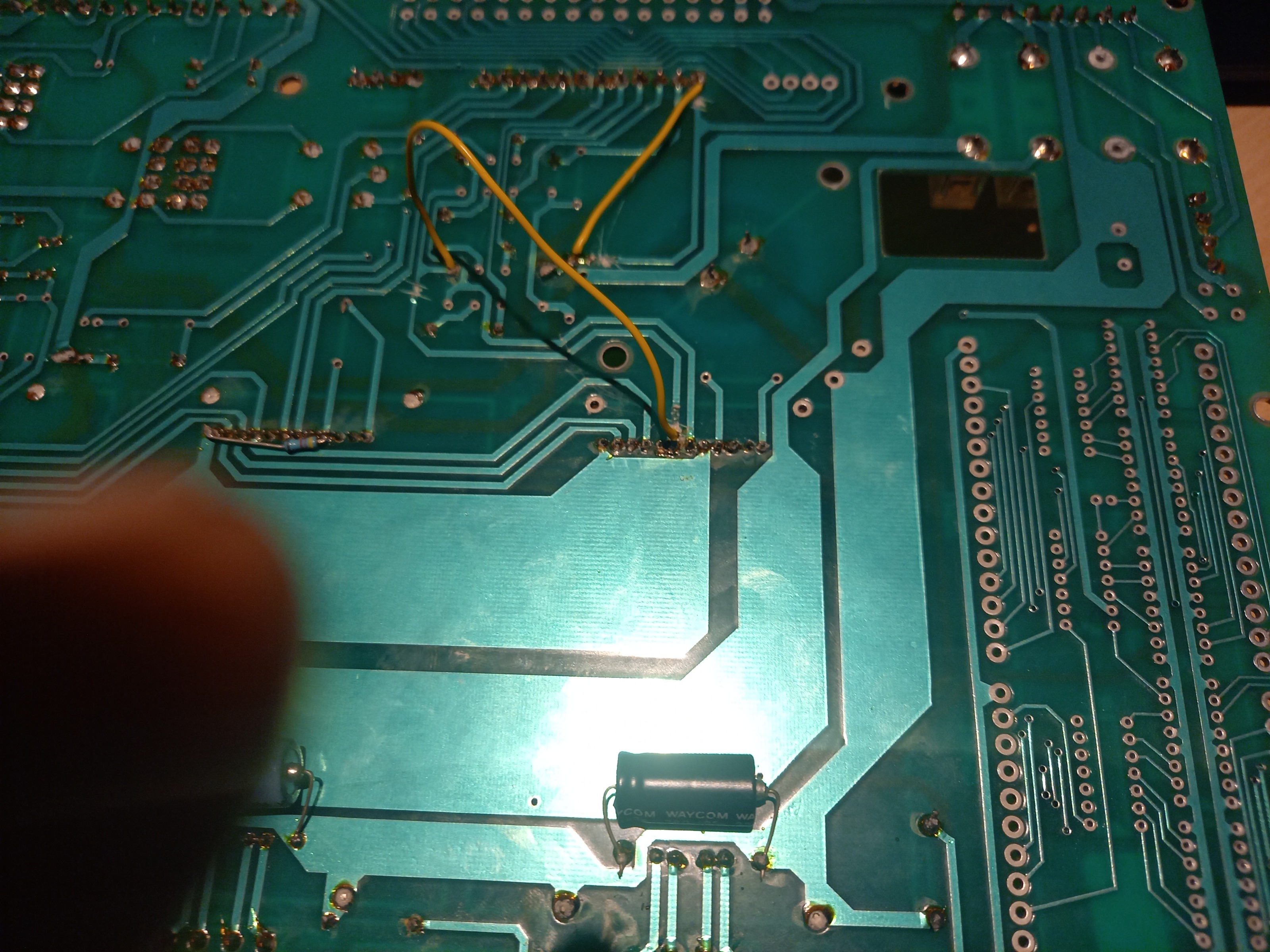

OK swapped z axis pins from 6 and 7 to 4 and 5 as they were empty it works so not the board itself so is something to do with the signal from a axis pins how to test please?

OK must be board related how do I test the capacitor?Top yellow wire is the step motionAnd bottom yellow wire is directionWhich goes to easy power gs d200s there's a black capacitor?? On there so need to test

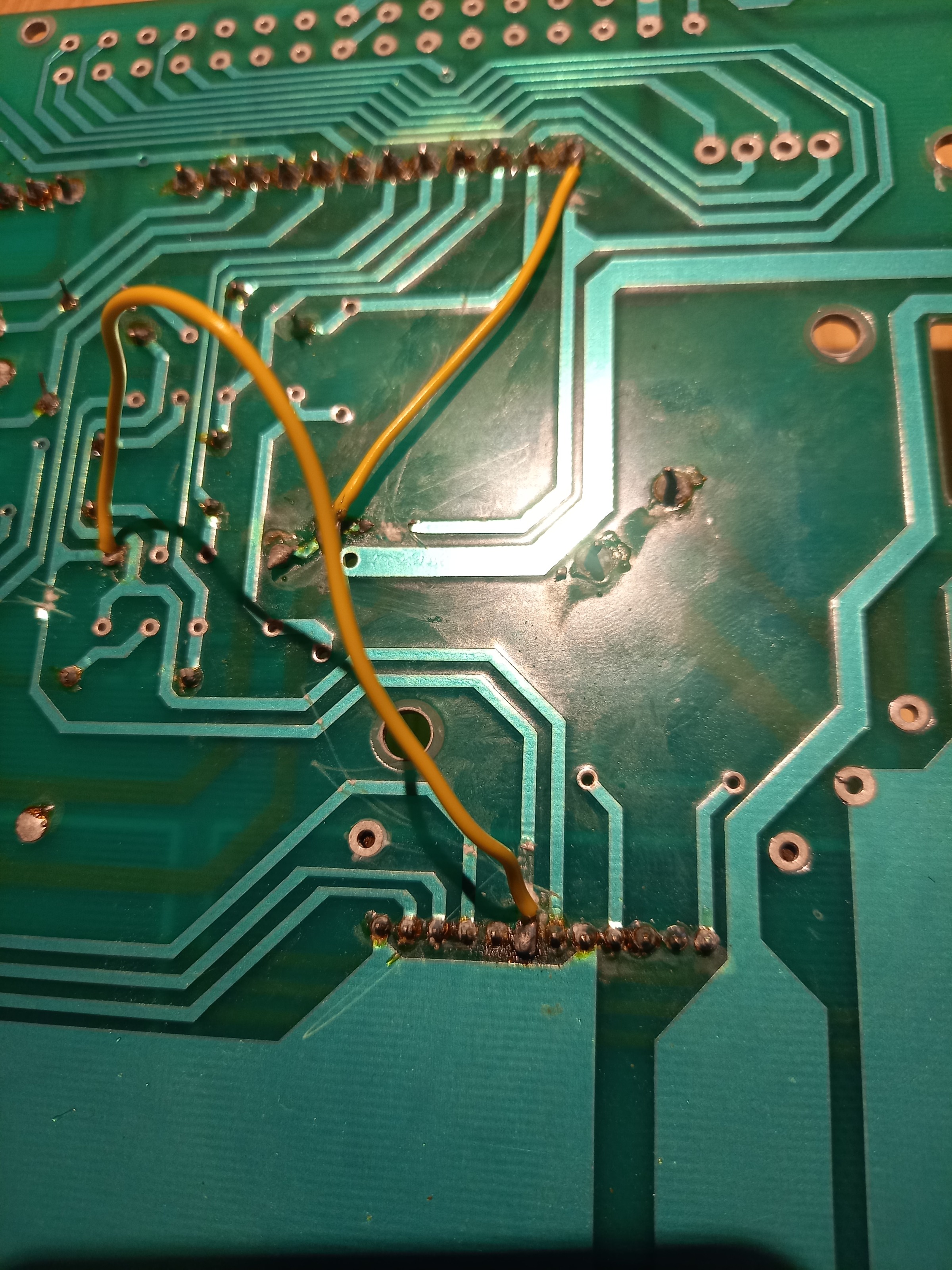

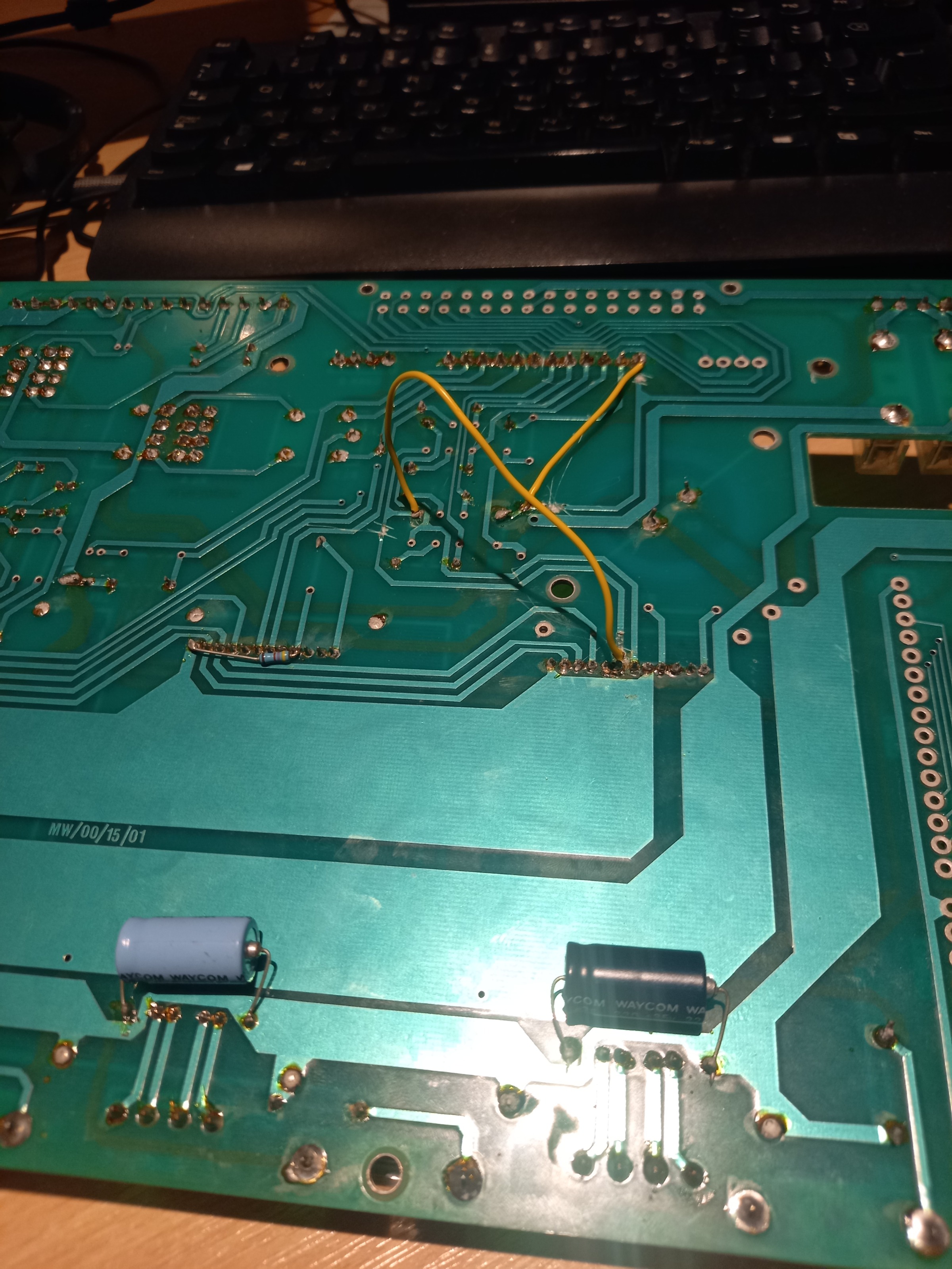

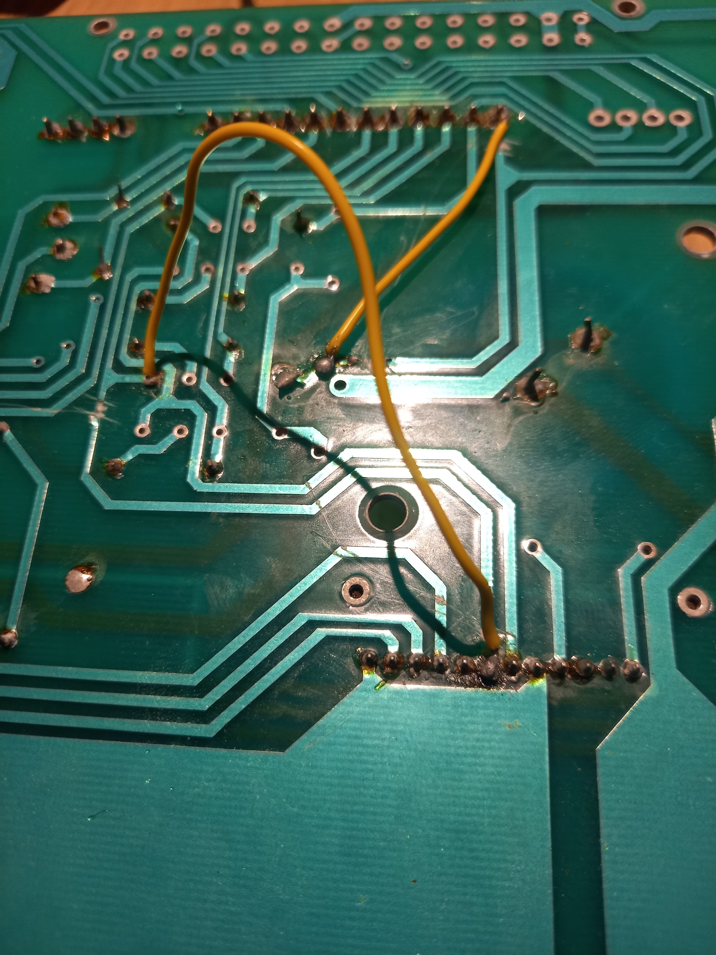

18 Oct 2022 20:41 #254464
Replied by tommylight on topic Turret Rotating to fast and missing steps
First, get a good soldering iron and resolder those pins on the IC's, the one on the right side of the picture looks especially bad.

Made no difference on velocity. I swapped over x and a axis on drivers the fault follows the driver wiring or driver need to rule out grounding issues can you tell me what I can put my multimeter to and how to test the signals? ?
