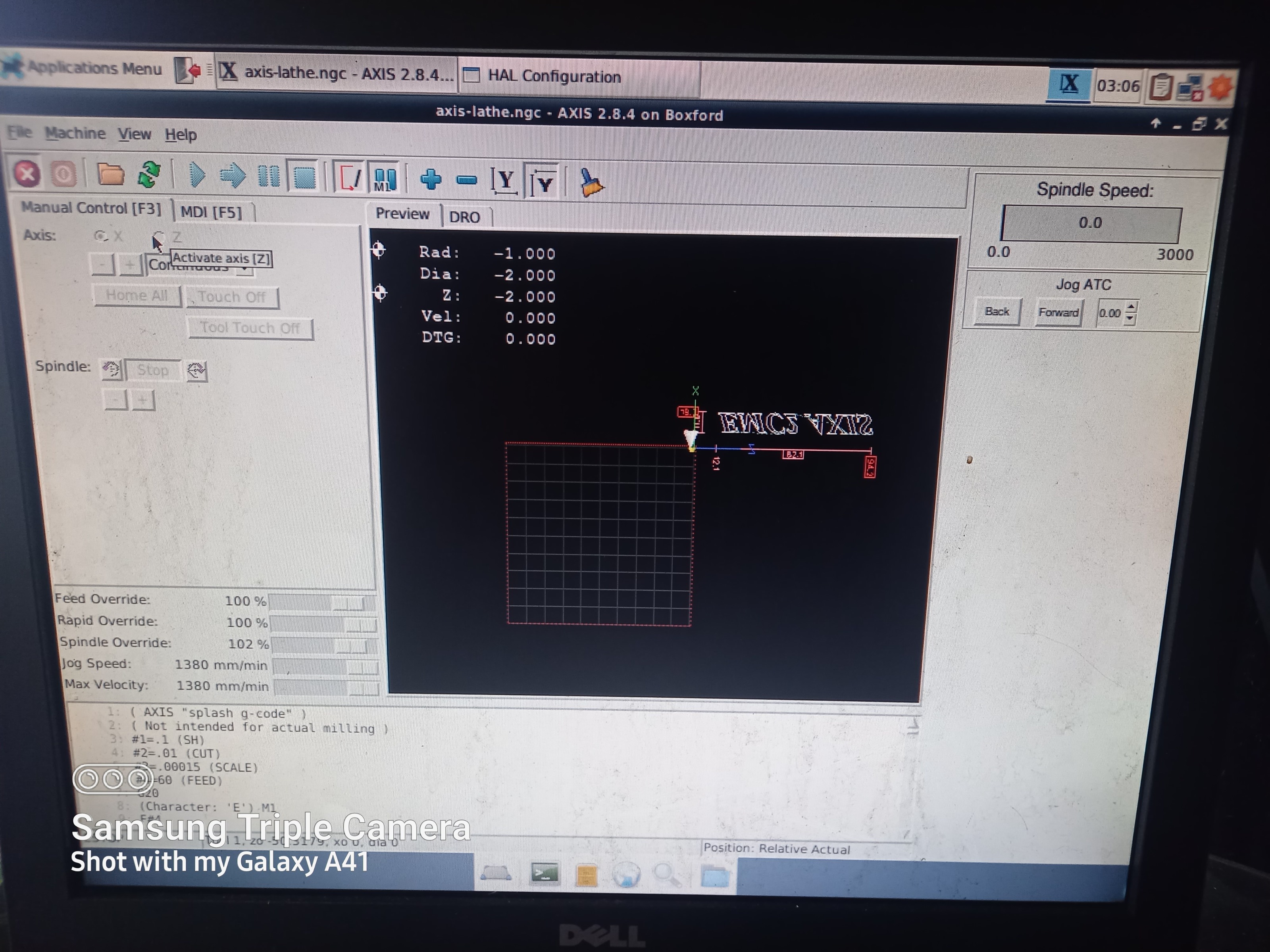

07 Oct 2022 13:08 #253689 by Turners
Replied by Turners on topic Turret Rotating to fast and missing steps
Hi
I have managed to get the tool changer to rotate.
But it doesn't reverse onto the pawl it goes forward for some reason. How does this change?
If you change max velocity on the gui it messes up the rotation completely is this normal?
07 Oct 2022 13:36 - 07 Oct 2022 13:45 #253695 by Aciera
Replied by Aciera on topic Turret Rotating to fast and missing steps
Maybe you could elaborate a bit. How did you get it to rotate? By toolchange command?
edit: This is what Clive wrote in his thread.
I notice that in the side panel there is a jog control according to the docs it is only used to set the reverse to lock the turret by adjusting and then putting the setting numbers into the comp. The jog buttons for/back don't move the turret to the next tool it is only for getting the numbers in the comp correct.
Last edit: 07 Oct 2022 13:45 by Aciera.

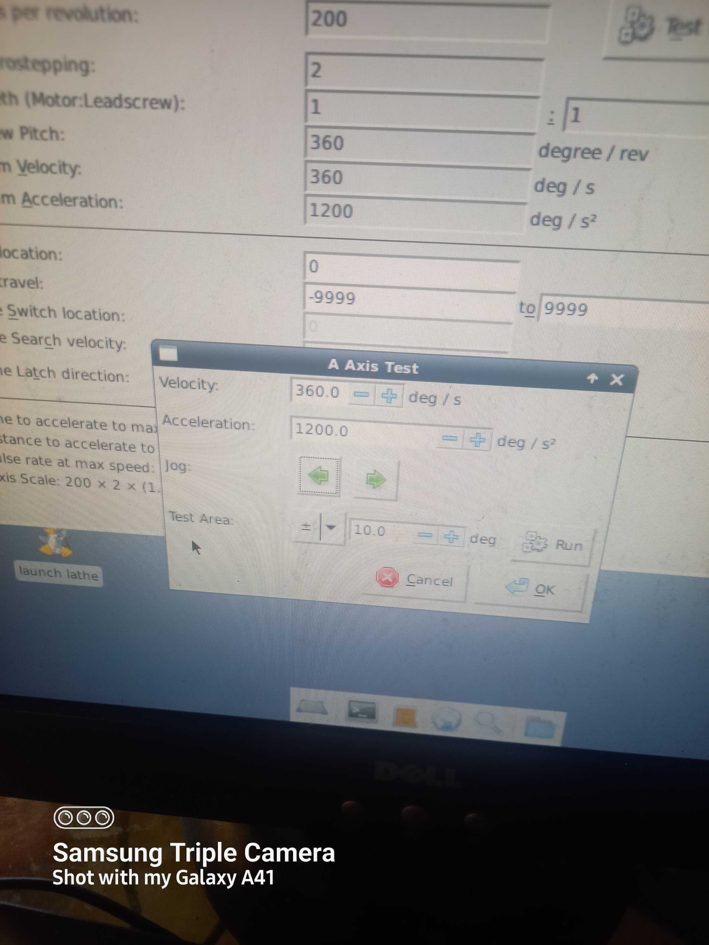

07 Oct 2022 15:17 #253703 by Turners
Basically I have redone a stepconfig to test
to use jog buttons to see if it rotates back an forward on keys it now only rotates with both jog buttons rotating same direction
07 Oct 2022 15:21 #253705 by Turners
I have made changes in boxford hal
but that shouldn't affect a new setup should it.??
07 Oct 2022 15:35 #253706 by Aciera
The motor rotates the same direction for forward jog and backward jog? If so that could mean that the DIR signal is not reaching the motor drive.
If you create a new configuration then no it should not affect your motor setup.
07 Oct 2022 16:22 #253707 by Turners
Yes that's what's happening.. so that's in the electrical machine side.
How do I test for that.?
