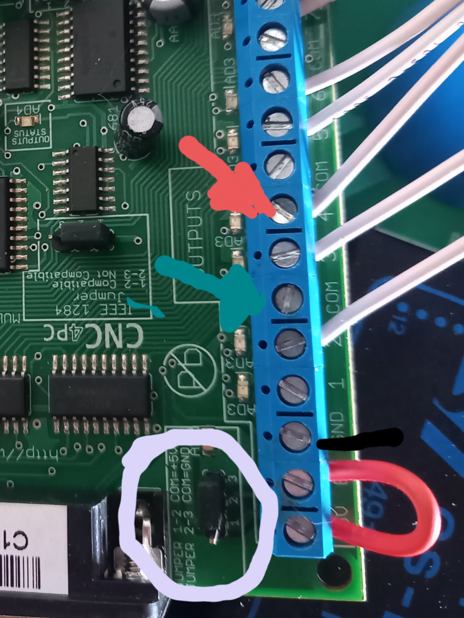

08 Oct 2022 22:17 #253778
by Turners
Replied by Turners on topic Turret Rotating to fast and missing steps
You mean the step and direction pins in the config file need to be ticked?
Or the little black relay jumpers on the board are step and direction pins ? Highlighted with circle
Also to multimeter touch top of pin then other end to ground or com see photo
- Turners
- Posts: 74
09 Oct 2022 12:01 #253806
by Turners
Hi I swap A axis with pins 8 and 9 seem to work now . Does that mean something is gone in the board? I noticed one of the little lights on pin 4 flicks on then off but clicks if need pics I will give you.
I tried to multimeter x axis pins but got no readings so gave up. Something I'm doing wrong.

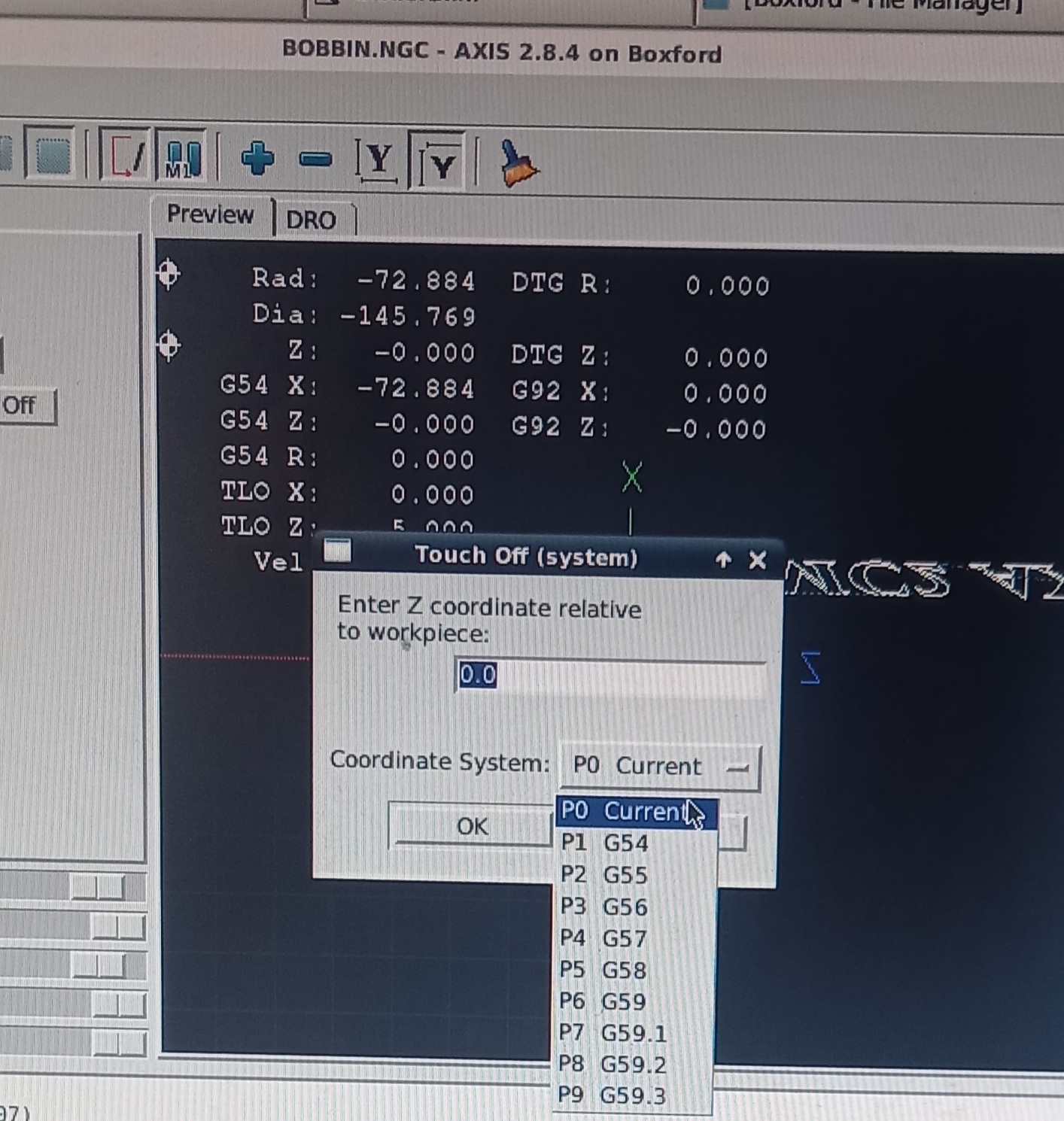

16 Oct 2022 15:54 - 16 Oct 2022 15:55 #254237
by Turners
Why do I have so many offset ?
Lathe only needs one.
I want to have my drill and turret on center line then ofset my tools accordingly. How do I save this so don't have to keep clocking in. And can I turn off all the offsets I don't need?
