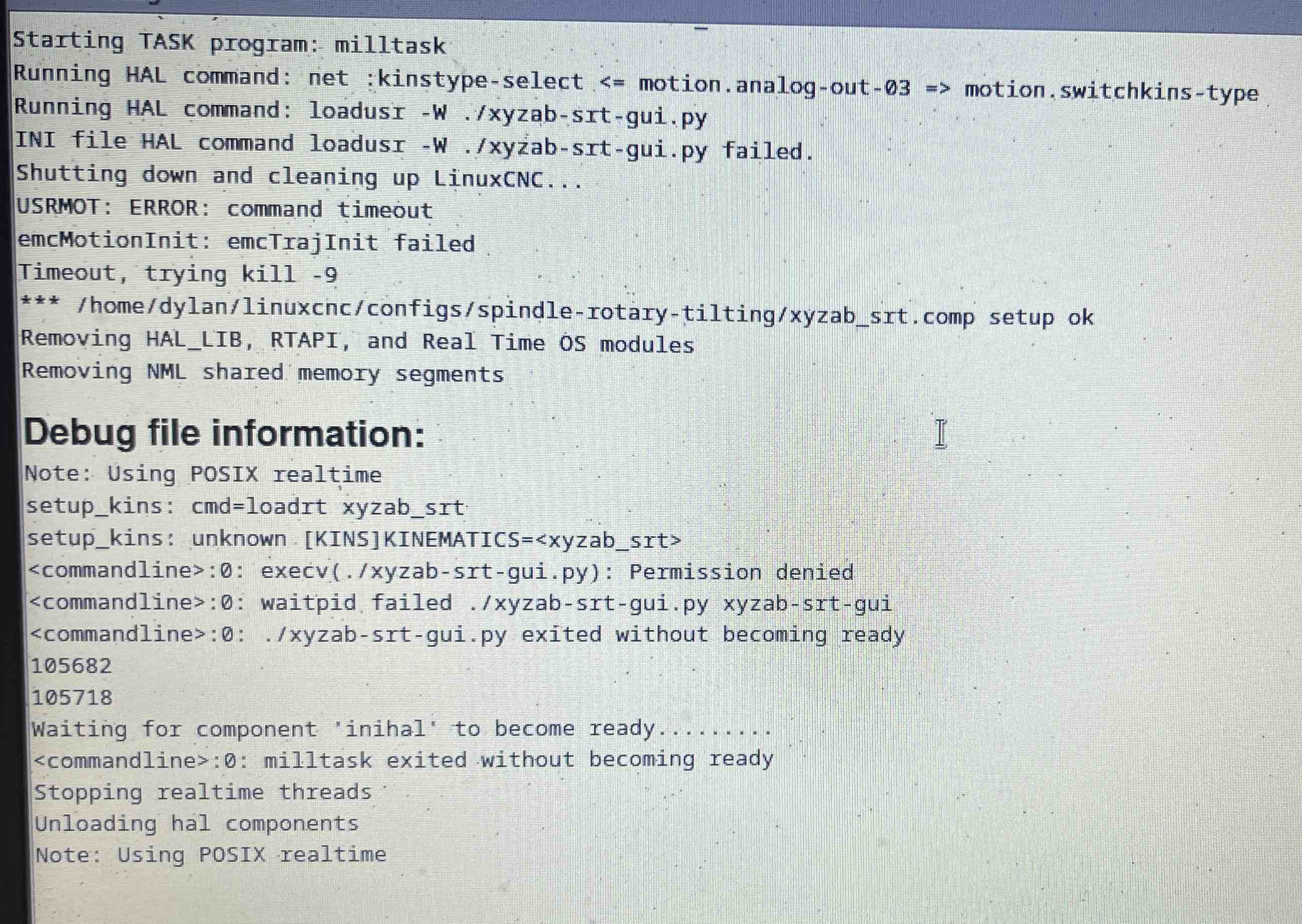

Sorry yes, thats what I just tried to run and thats where the debug came from..

Replied by Aciera on topic Please Help - How to Configure a 5 Axis Head-Head
Ah ok, I get it, you got the permission denied error with the sim config.
That is a bit odd as usually permissions should remain if you import and unzip on your linux machine. But anyway try right clicking on the file 'xyzab-srt-gui.py' -> Properties -> choose Permissions tab and activate 'allow executing file as program'
Then try launching again and report.

08 Aug 2023 17:39 #277344
by IronManDylan
Replied by IronManDylan on topic Please Help - How to Configure a 5 Axis Head-Head
Okay that worked, it launched without any errors...
Aha that may give us some hints.

08 Aug 2023 17:43 #277346
by IronManDylan
Really?? I was more worried there weren't any errors lol. What are you thinking?
First thing to try would be to delete the folders 'demos', 'psng', 'python', and 'remap-subs' from the non working hackbot config folder and copy those folders in from the working sim config folder. Just to be sure we got that sorted.

by IronManDylan
So from spindle-rotary-tilting-ProbeScreen -> hackbot_srt? Okay I will do that now.

by IronManDylan
Okay, did that, did not seem to change anything.
So the next thing would be to start the hackbot config from a terminal.
Open terminal and type:
$ linuxcnc
Then choose the hackbot config from the config picker and post the information from the terminal output.

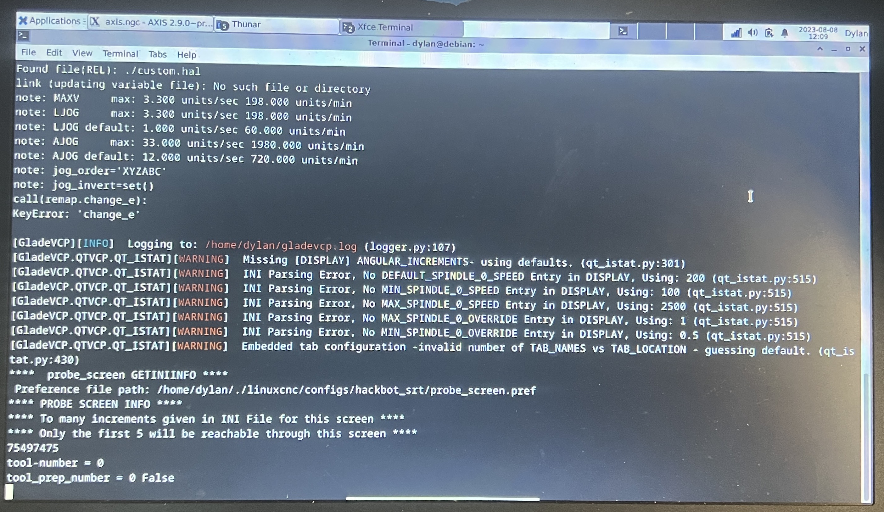

- IronManDylan
- Posts: 151
- Thank you received: 22
08 Aug 2023 18:11 #277353
by IronManDylan
Did that and had the same error. But the output from terminal looks kind of promising.
