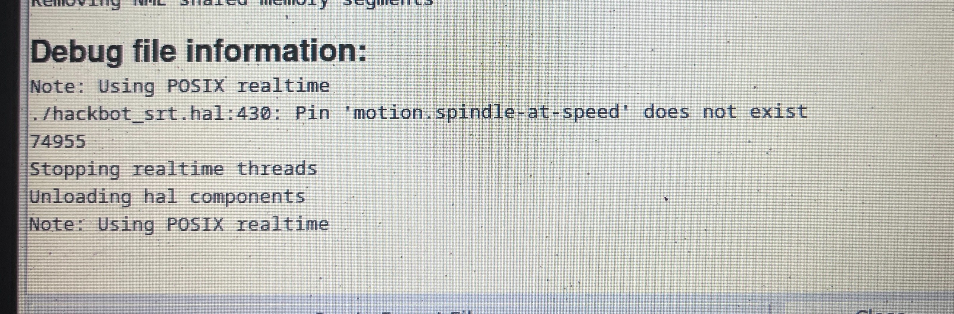

Okay, I thought I had this solution with what I found here: www.forum.linuxcnc.org/10-advanced-confi...-at-speed-time-delay
Which gave me this:However I am getting the attached error. I thought this was due to motmod not being loaded. But motmod was loaded through EMCMOT it appears. I got the error "motmod: already exists" when I tried to add it.
Edit: I have been working for a few hours on this as it seems like it should just be solvable. But no matter what I try I cannot get rid of the error "motion.spindle-at-speed" not found or does not exist. Also Aciera, if you see this in the morning, I explained the issues with verser_probe 6 posts ago. Thanks.
Which gave me this:
loadrt timedelay count=1
addf timedelay.0 servo-thread
setp timedelay.0.on-delay 5
net spindle-on => timedelay.0.in
net spindle-timer <= timedelay.0.out
net spindle-timer => motion.spindle-at-speedEdit: I have been working for a few hours on this as it seems like it should just be solvable. But no matter what I try I cannot get rid of the error "motion.spindle-at-speed" not found or does not exist. Also Aciera, if you see this in the morning, I explained the issues with verser_probe 6 posts ago. Thanks.

07 Aug 2023 03:30 #277191
Replied by rodw on topic Please Help - How to Configure a 5 Axis Head-Head
try editing your file to use : spindle.0.at-speed
Looks like your config predates v2.8 which went to multi spindle
Ref: linuxcnc.org/docs/2.9/html/man/man9/moti....html#SPINDLE%20PINS

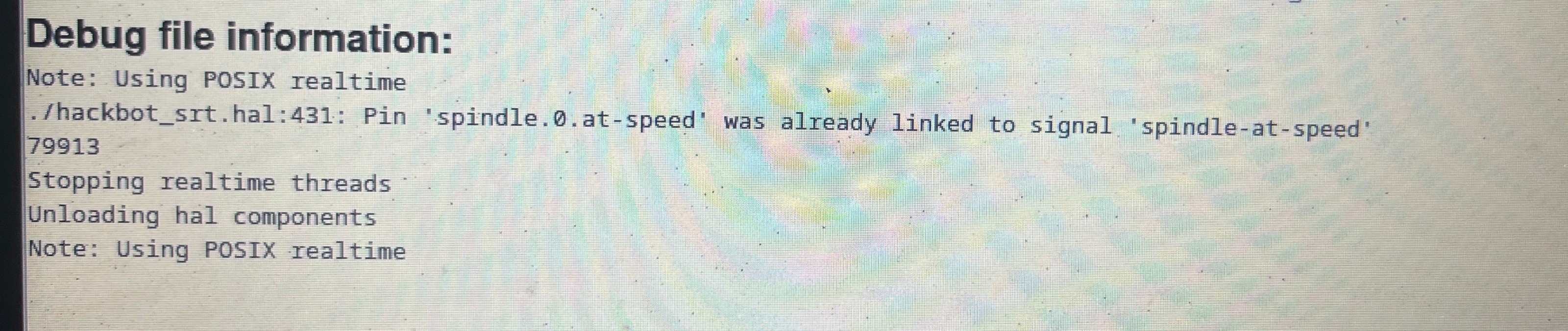

I was just getting on here to state that I think it has something to do with v2.9. I read something somewhere that made me think that. So I tried what you suggested earlier too and just tried it again to confirm. What happens is first I am told "'spindle.0.at-speed was already linked to signal 'spindle-at-speed'", so after that I comment out the line "net spindle-at-speed => spindle.0.at-speed", then I am able to get the config to launch. But, I can't turn the spindle on in MDI once it is launched. I start a gcode test and the machine just starts jogging to where it wants to cut in disregard for the fact that the spindle isn't running.
I am convinced it has something to do with MOTION...

spindle.0.at speed must be true before motion will begin. This can come from a RS485 spindle but some people use a near component comparing actual speed with commanded speed.
You need to connect the spindle-at-speed to the actual pin giving the signal. something like
net spindle-at-speed <= my-actual-at-speed-pin

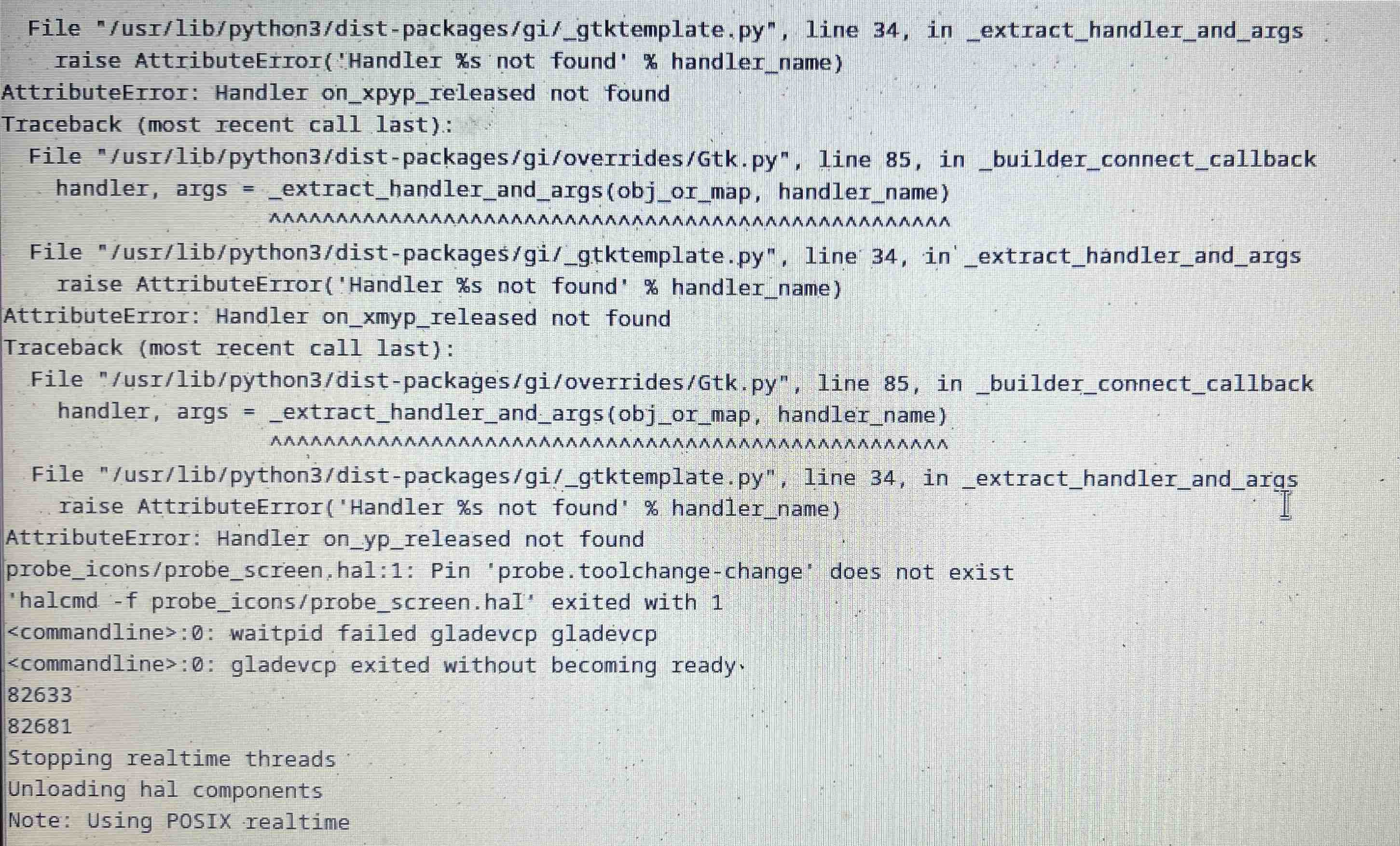

Regarding ProbeScreen:
Note that the Github repo you linked seems to be outdated. The original author has not reacted to several pull requests that address issues when running more recent versions of linuxcnc.
There is more recently updated code here:
forum.linuxcnc.org/49-basic-configuratio...obe?start=640#276444
I have not tried it but I may find some time to do so later.
[edit]
So I just added ProbeScreen to my xyzab-srt simulation config and it seems that you should be able to get your cofig going by replacing the two folders 'psng' and 'python' in your current config with the updated versions from the attached folder in this post (starts up fine on my installation running Linuxcnc 2.9 on Debian Bookworm):
forum.linuxcnc.org/49-basic-configuratio...obe?start=640#276003
Note there have been other more recent modifications in these posts which may also be relevant:
This one fixes the broken DRO in the ProbeScreen tab:
forum.linuxcnc.org/49-basic-configuratio...obe?start=640#276234
Not exactly sure what this one does:
So the above seems to give me a working ProbeScreen TAB in axis (I have not tested gmoccapy).
Note that I cannot test the probing itself since I don't have a probe.

07 Aug 2023 11:15 #277224
Replied by tommylight on topic Please Help - How to Configure a 5 Axis Head-Head
No need for timedelay.
Aciera is right, new versions of LinuxCNC have multi spindle support so spindle number must be provided for everything, so everything containing spindle becomes spindle.0.at-speed or spindle.0.on or spindle.0.cv etc, these are just examples.

Aciera
I do not have a folder titled 'psng' in my current config. Should I just add it or is there a different location I should build this from?
edit: i just tried replacing the python folder and adding the 'psng' folder and got the same error. Image attached. Maybe I should try to rebuild the probe from the links you provided?

Spindle stuff:
Tommy
I am confused, Aciera did not make a comment about the spindle? Everything that I have is connected to a spindle.0 pin as follows:
net spindle-vel-cmd-rps <= spindle.0.speed-out-rps
net spindle-vel-cmd-rps-abs <= spindle.0.speed-out-rps-abs
net spindle-vel-cmd-rpm <= spindle.0.speed-out
net spindle-vel-cmd-rpm-abs <= spindle.0.speed-out-abs
net spindle-enable <= spindle.0.on
net spindle-cw <= spindle.0.forward
net spindle-ccw <= spindle.0.reverse
net spindle-brake <= spindle.0.brake
net spindle-revs => spindle.0.revs
net spindle-vel-fb-rps => spindle.0.speed-in
net spindle-index-enable <=> spindle.0.index-enable
I am confused how it would be possible to achieve a delay without timedelay? I do not have a method to measure the RPM on the VFD.
rodw
It seems that the spindle-at-speed is connected to spindle-timer. Its seems like this should go true after the allotted time passes, but that error is still present. Based on you suggestion, how would I get my-actual-speed to go true after a given amount of time?
Tommy
rodw
