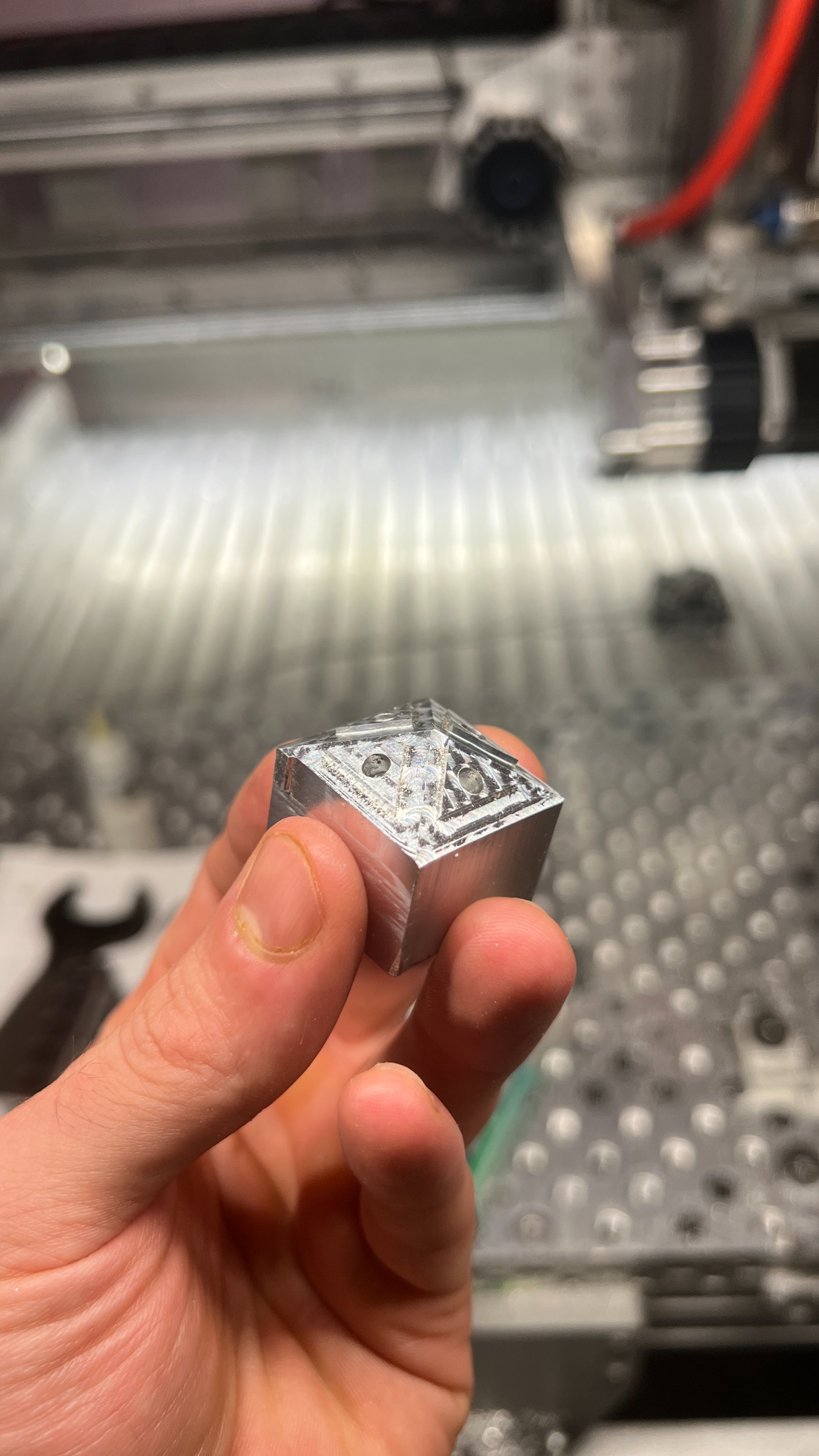

09 Aug 2023 06:57 - 09 Aug 2023 06:58 #277405 by IronManDylan
Replied by IronManDylan on topic Please Help - How to Configure a 5 Axis Head-Head
Did that test cut tonight. Had to do quite a bit of mods to the post even after that last message.  Added it here incase you are making a Hackbot.  A big one was removing the canned "deep drilling" cycle, as that was causing weird issues. All things considered I say the test cut went well.  You can see some misalignment near the top, but I had to rehome and reprobe z a few times. Also the Z ball screw is shot and will be replaced.  So that probably accounts for some of it.

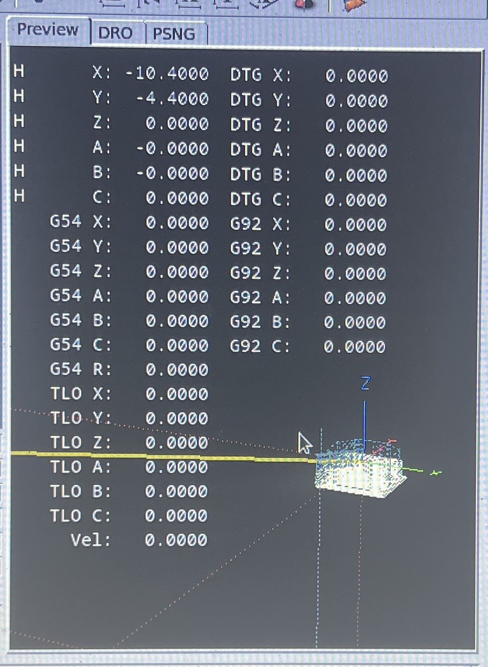

10 Aug 2023 02:35 #277496 by IronManDylan
I will probably get M6 rocking when I can get upgraded to a bigger monitor.  For now its not terrible to add the offsets manually.  Ill look through the probe stuff, but right now I have discovered an issue.
The alignment of my spindle center seems to be a little bit Y- to the joint of the A axis.  So I need a way to fix this in the kinematic model. Do you know which of these need to be modified to do that:
HALCMD = sets :pivot-y 0
HALCMD = sets :pivot-z 2.3000
HALCMD = sets :offset-x 0
HALCMD = sets :offset-z 0
Obviously, I would think it would be "pivot-y", but 'pivot' seems like a strange term to call this.  And you said that you modified this kinematics system off of another system, so I was wondering if they are labeled in an intuitive way.  I am going to go try that now but was curious what you think.

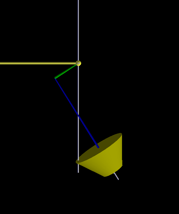

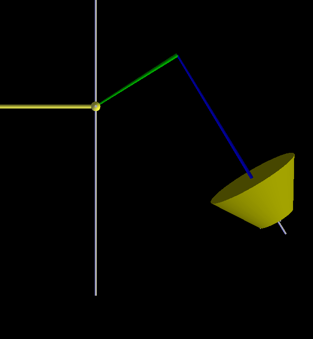

10 Aug 2023 04:35 - 10 Aug 2023 04:39 #277501 by Aciera
Yes, 'Pivot' length is the distance traveled as we go from the spindle nose to the rotary-a axis:
So this is a positive pivot_y:
While this is a negative pivot_y:
Note: In the pictures
machine coordinate +Z is pointing UP
machine coordinate +Y is pointing LEFT
machine coordinate +X is pointing INTO the screen
