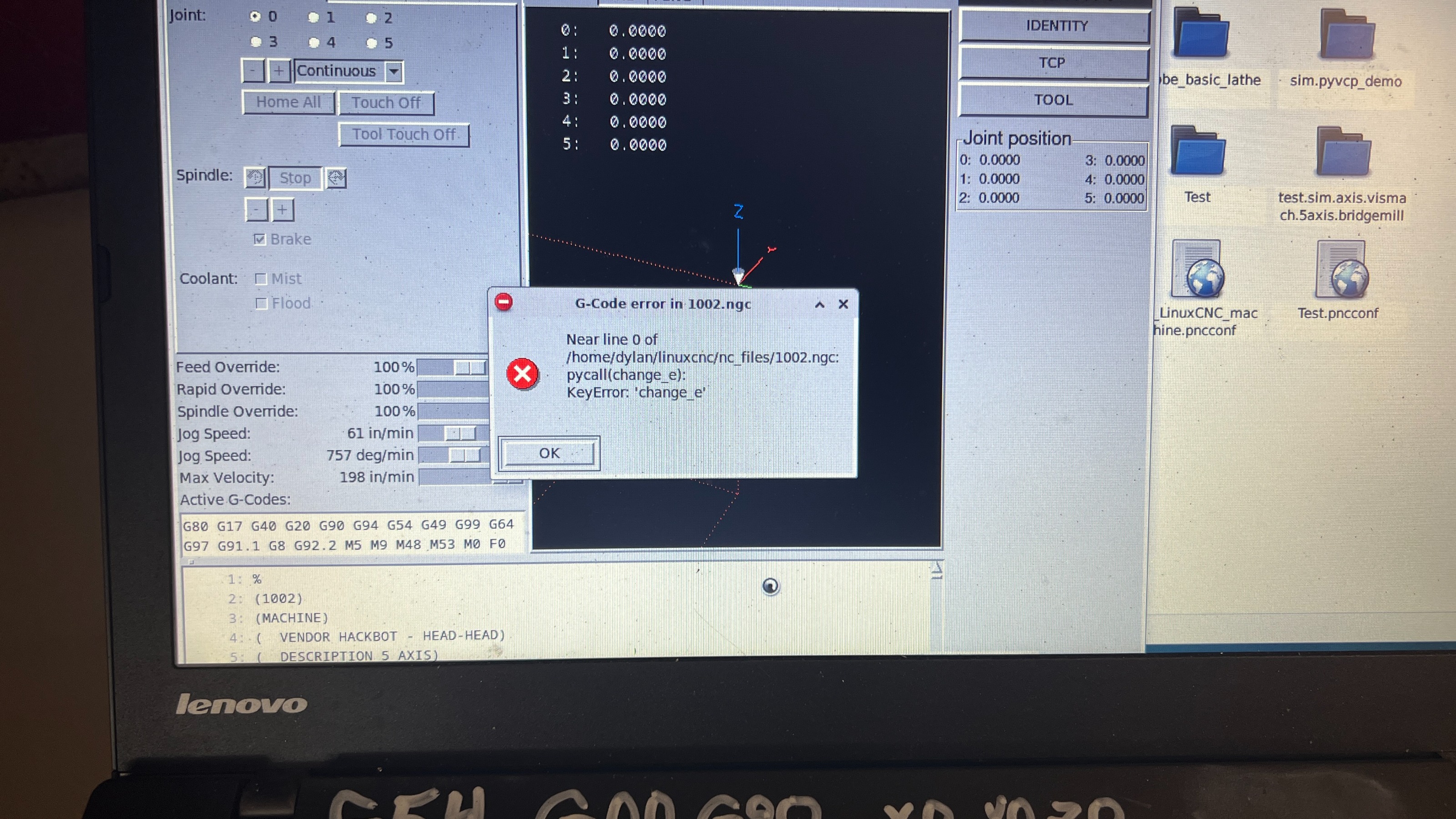

Yes I am using a Mac. I did that, the files extension won't upload here. Trying to compress another way but am not having luck.
Edit: I simply removed the .7z extension and added .tar. Hopefully you can open it by changing the extension back
Edit2: Maybe I should state that the compressed file that is attached to this message is different from the one in the google drive. Here I have deleted the files associated with qtdragon (I thought maybe those were tripping it up). I have also deleted and recopied the 'python' and 'psng' files as I thought those may be causing an issues. However, both those modifications have yielded the same result.
Is it possible the issue is coming from either of the pyvcp files? Is it possible that the install of python3 I did earlier to work with probe_basic could be causing the issue?
I am going to add the error image again for easier reference.

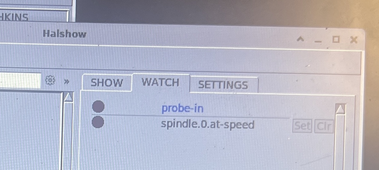

rodw
this is the code I have been using:
setp timedelay.0.on-delay 5
net spindle-on => timedelay.0.in
net spindle-timer <= timedelay.0.out
net spindle-timer => spindle.0.at-speed
Isn't pin 'spindle.0.at-speed' connected to pin 'timedelay.0.out' through signal spindle-timer?
Edit: if you do not see anything wrong with this I think maybe it is working and that the delay is just set very short. Possibly this is in microseconds and not seconds? I cannot test that hypothesis though until I get the machine to upload gcode again...
Last edit: 07 Aug 2023 21:15 by IronManDylan.
- Posts: 12166
- Thank you received: 4152
07 Aug 2023 23:02 #277288
Replied by rodw on topic Please Help - How to Configure a 5 Axis Head-Head
Its seconds so should work. Ref: linuxcnc.org/docs/2.9/html/man/man9/timedelay.9.html
Time to go to halshow and watch the variables are changing state first the delay and then the spindle
Axis menu: show hal configuration
- IronManDylan
- Posts: 151
- Thank you received: 22
08 Aug 2023 01:49 - 08 Aug 2023 01:52 #277300
by IronManDylan
Replied by IronManDylan on topic Please Help - How to Configure a 5 Axis Head-Head
Ah, thats a good idea (though I was initially looking at hal meter and hal scope). Weirdly, spindle.0.at-speed never seems to go high.
However. I think it is no longer an issue, as I think Tommy deserves a win here, I have modified line 659 of the linux post processor to say:
and now I get a pause baked right into my gcode WITHOUT having to remember to write it in after each gcode post. Thank you Tommy
And that shoulddd really do the trick, as long as LCNC does indeed listen to the 'G04 P5' command that is... So no pressure Aciera, but I will be saying a prayer to Linux the Penguin God of CNC that you are able to find out what is causing that error when you have the time tomorrow
Thank you.

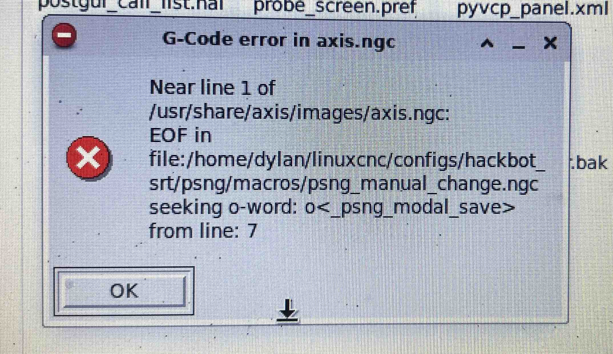

08 Aug 2023 16:39 - 08 Aug 2023 16:52 #277335
by IronManDylan
Aciera
Well whatever you did fixed one problem it seems, but not I am getting a similar issue. Image attached. Looks like this time we may know where it is?
Also, where should the .axisrc be placed? I thought it should be under ~./dylan not in the config folder?
Edit: btw this message is appearing when I try to load gcode, just like the other message.
Last edit: 08 Aug 2023 16:52 by IronManDylan.
- Posts: 4819
- Thank you received: 2177
08 Aug 2023 17:08 #277337
Have you tried running the attached sim config folder? If so, did you get any errors running it?
Replied by Aciera on topic Please Help - How to Configure a 5 Axis Head-Head
Yes, if you have it in ~/.axisrc (which is the same as /home/.axisrc) then that is fine, which may be what you meant.Also, where should the .axisrc be placed? I thought it should be under ~./dylan not in the config folder?

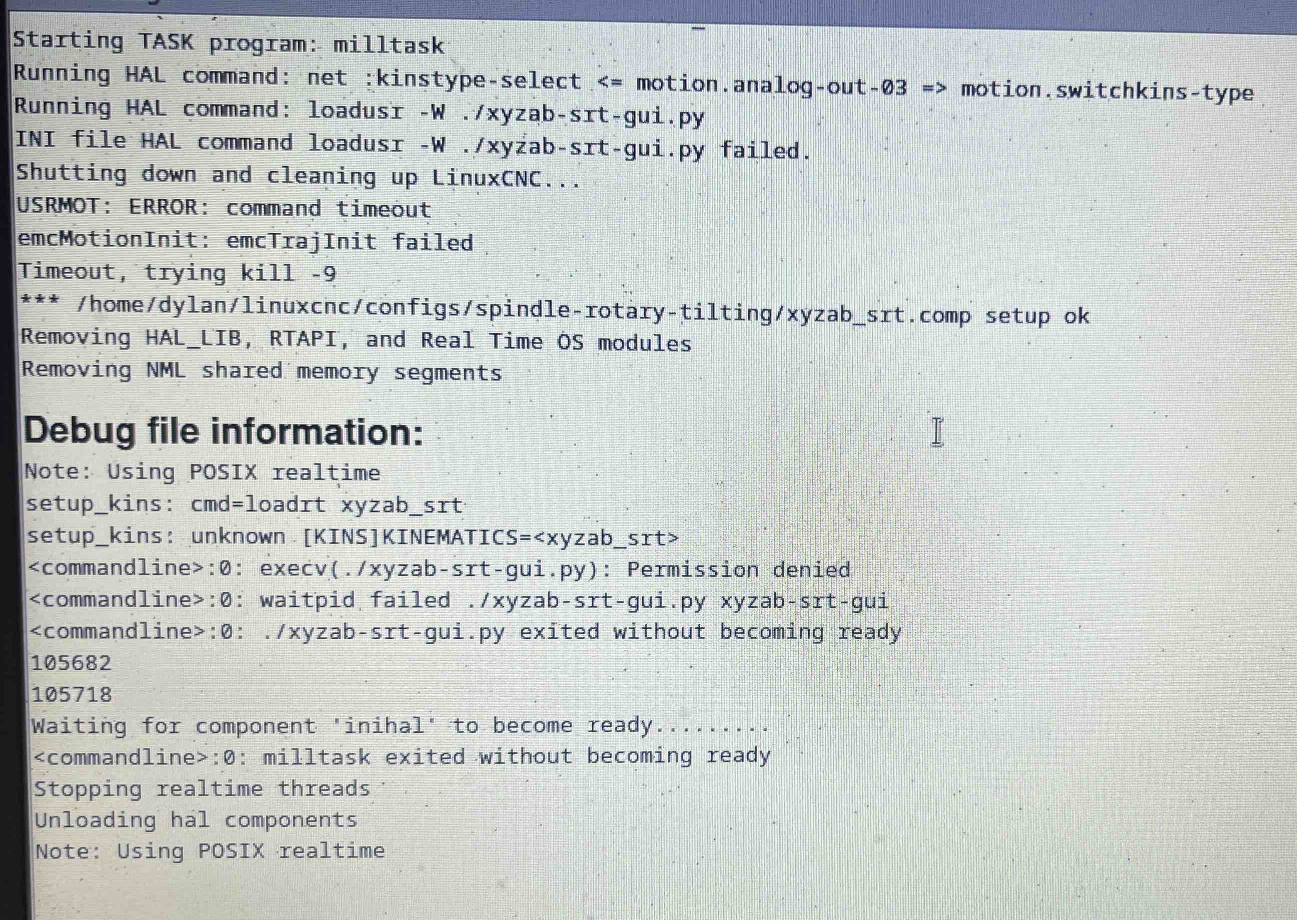

- IronManDylan
- Posts: 151
08 Aug 2023 17:21 - 08 Aug 2023 17:21 #277339
by IronManDylan
So I noticed that a lot of the macros from the 'psng' folder were missing from your cleaned up version of you sent. When I added those back I got the same error from before :/
I just tried launching it. I got this error when it failed to launch.
edit: yeah thats the location I meant
Last edit: 08 Aug 2023 17:21 by IronManDylan.
- Posts: 4819
08 Aug 2023 17:24 #277340
Ok, but have you tried running the the config from this post?
forum.linuxcnc.org/38-general-linuxcnc-q...ead?start=170#277321
