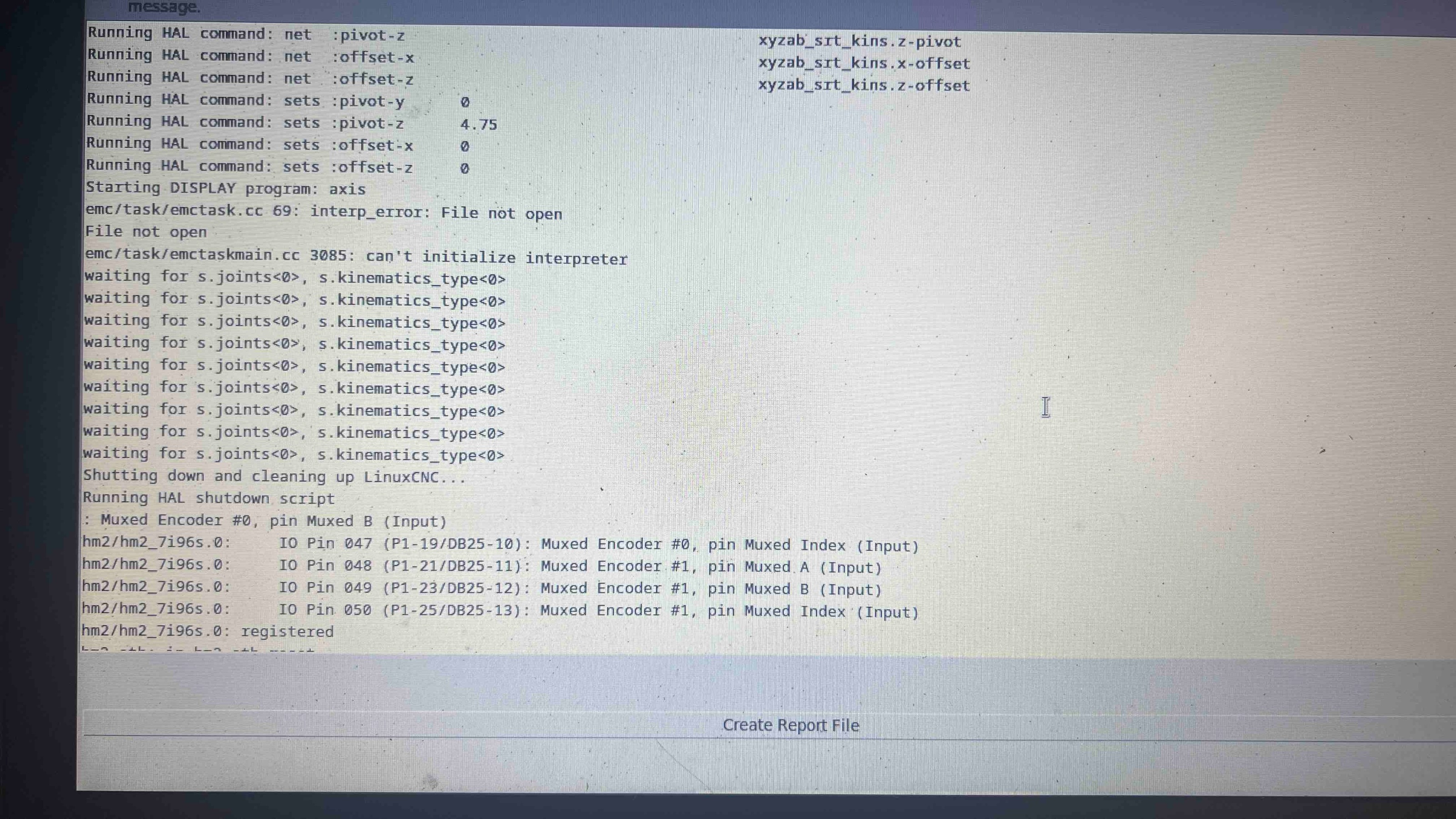

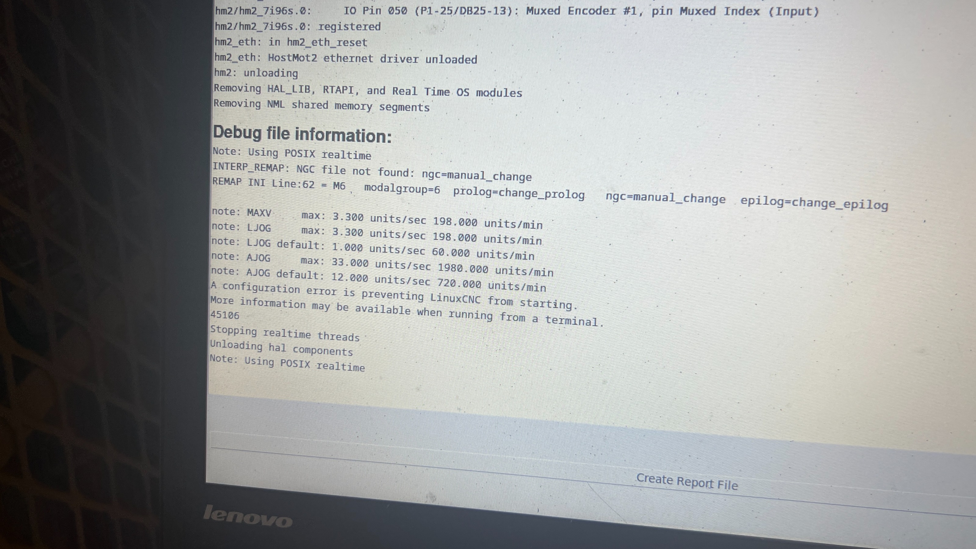

06 Aug 2023 00:37 - 06 Aug 2023 00:42 #277071
by IronManDylan
Replied by IronManDylan on topic Please Help - How to Configure a 5 Axis Head-Head
I apologize for posting so many times in a row, but I am trying to figure this out in real time. It appears the trouble I initially had with launching the Probe Screen V2 was due to the fact that it was written in python2, and apparently my machine is running python3. Idk why this is, maybe because of downloading Probe Basic.
I corrected those errors and now I have gotten another error. This error seems to be do to REMAP. I don't really know anything about remap and what it is doing. Just that Aciera was using some remap to change between Identity, TCP and TOOL. Like I mentioned above, there are now two different subroutine paths in my ini file. Not sure if this is an issue.
I don't even see INTERP_REMAP: as a file name anywhere. So I am a bit confused.
Edit: also, manual_change.ngc is definitely in here so what the heck
Last edit: 06 Aug 2023 00:42 by IronManDylan.

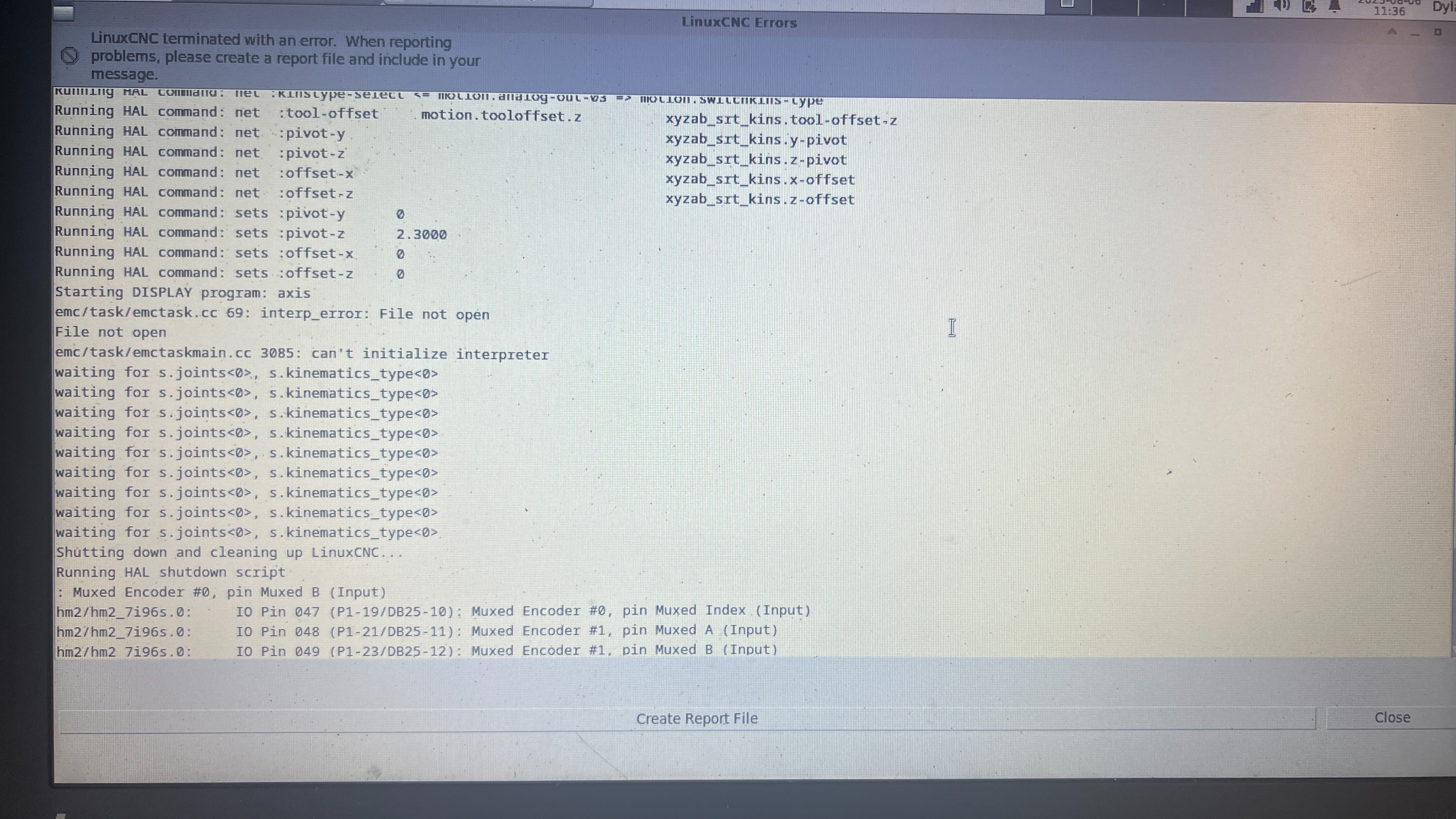

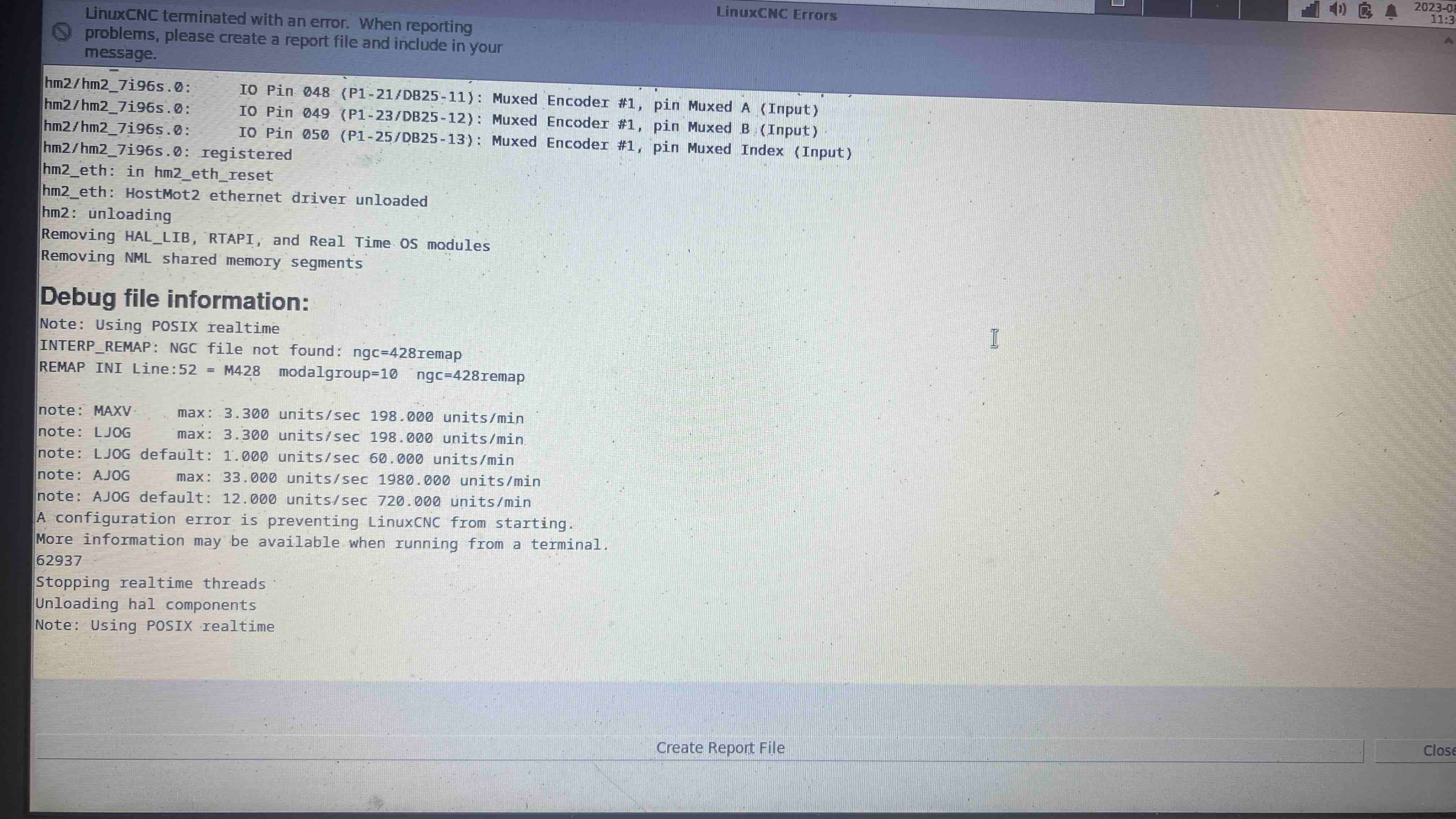

06 Aug 2023 01:00 - 06 Aug 2023 01:00 #277073
by IronManDylan
Here is some additional error information that may be helpful that I found a little further up. I tried running from terminal as well and that did not seem to provide any relevant information that stood out to me. Anyone have any ideas?
Last edit: 06 Aug 2023 01:00 by IronManDylan.

06 Aug 2023 05:50 - 06 Aug 2023 06:15 #277087
Replied by Aciera on topic Please Help - How to Configure a 5 Axis Head-Head
The switchable kinematics feature as well as the custom kinematic is independent of which gui you are using. What you won't have is the custom pyvcp panel on the right with the buttons to switch between the kinematic modes (IDENTITY, TCP, TOOL) but you can switch between modes using the M428,M429 and M430 codes in MDI of any gui.
Not sure about about ProbeScreen. Can you compress your config folder and post it here?
[edit]
Looks like 'Probe Screen' comes with it's own set of remaps in a folder called 'macros'. You should only have one line in the ini file starting with 'SUBROUTINE_PATH='You can have a _list_ of subroutine paths, (note the ':' separator )
SUBROUTINE_PATH = ./macros:./remap_subs
With the above the system will first look in the 'macros' folder of your config and if it does not find the remap there it will then look in the 'remap_subs' folder.

06 Aug 2023 18:48 - 06 Aug 2023 18:59 #277133
Change this line in you ini file:
SUBROUTINE_PATH = ./remap_subs : ./macros
to this (Note the removed spaces!):
SUBROUTINE_PATH = ./remap_subs:./macros
[edit]
Also it seems that you are missing the call to load the pyvcp panel for probe basic
So in the [DISPLAY] section of your ini file change (ie add the missing lines) this
DISPLAY = axis
to:
DISPLAY = axis
EMBED_TAB_NAME=Probe Screen
EMBED_TAB_COMMAND=halcmd loadusr -Wn gladevcp gladevcp -c gladevcp -x {XID} -u python/probe_screen.py -H probe_icons/probe_screen.hal probe_icons/probe_screen.glade
[edit]
DISPLAY = axis
to:
DISPLAY = axis
Last edit: 06 Aug 2023 18:59 by Aciera.
