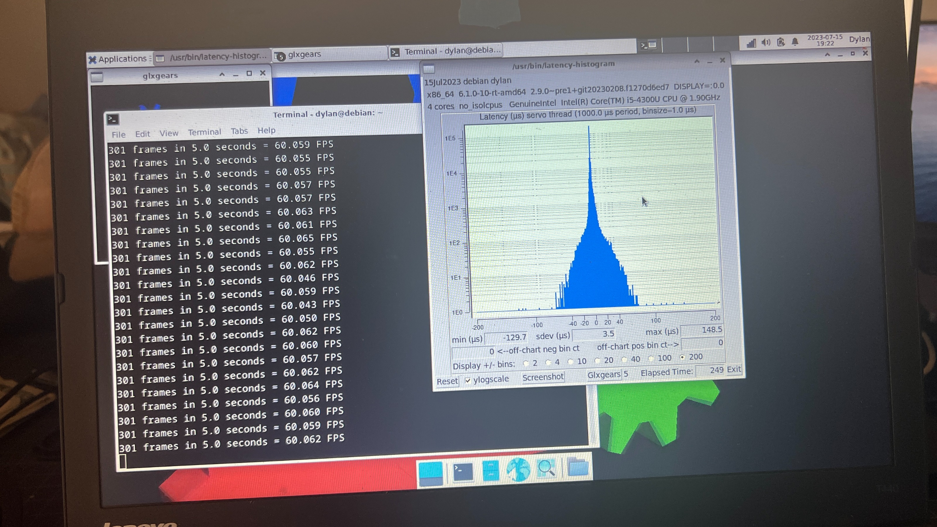

I added a photo of the histogram. Honestly not sure how to interpret this. Let me know what you think.
So, are the step/dir signals coming to the mesa board through the ethernet cable? Because I don't have a parallel port of my computer, just a vega connector.

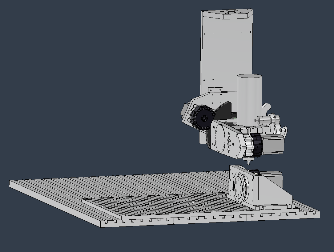

I added a screenshot of the cad of the 4th/6th axis (kinda works as a 4th axis but will technically be the 6th axis) since it is not assembled yet. Again, only 5 axis will be moving at any one time and there will be two different configurations. And a picture of the full machine which you can tell is a head-head I built on your standard gantry style machine.

I did some experimenting on LinuxCNC yesterday. I was able to get the vismach machine moving around in TCP mode for the bridgemill. But was unable to do this with the "5kins" table-head machine. Which had me concerned that I would not be able to use the machine in this configuration. But then I started thinking..
If the WCS is set at the middle of rotation my "4th axis" (would technically be the 6th axis of the machine but will be operating as a 4th axis) I shouldn't need any type of TCP control for the 4th axis, correct? I believe that this is how a 4th axis is programmed and doesn't require any kinematics control by the controller. If this is true I can use the head-head in full 5 axis TCP mode and use the 4th axis for indexing or whatever I need it for. Does anyone have experience machine with a 4th axis and can tell me if my understanding of this is correct?

I use a 4th axis (A) in continuous and indexing with LCNC and F360. No TCP.
I set the WCS at the CoR in Y/Z and X wherever is appropriate for the part. Works like a champ with F360's 'tool orientation' feature.
I suspect you'll want to set WCS at CoR of the table axis and treat each indexing move as a new WCS. i.e. A0 = G54, A90=G55, etc.
Reason I'm thinking this is how to do it is that F360 will not know when to rotate the table axis vs. the head tilt. You can set max tilt definition in the F360 machine settings, but it'll be hard to define whether you want 10 degrees of tilt and 45 degrees of table rotation, or 45 degrees of tilt and 10 degrees of table rotation.
Probably a non-issue for head tilt on an axis that doesn't correspond with the table axis, but when they're essentially parallel-but-offset, how does one define which moves when? Maybe in the post processor... but that's well over my head.
You can also have multiple LCNC configs for the same machine - perhaps one for continuous table axis work, one config for table axis indexing, and one 'non-rotary-table' config.
- The indexing one uses G54/55/56/57 for each 90 degree table axis quadrant, and the head can tilt +/- B90
- The continuous one uses one WCS and rotates the table, but doesn't tilt the B-axis
