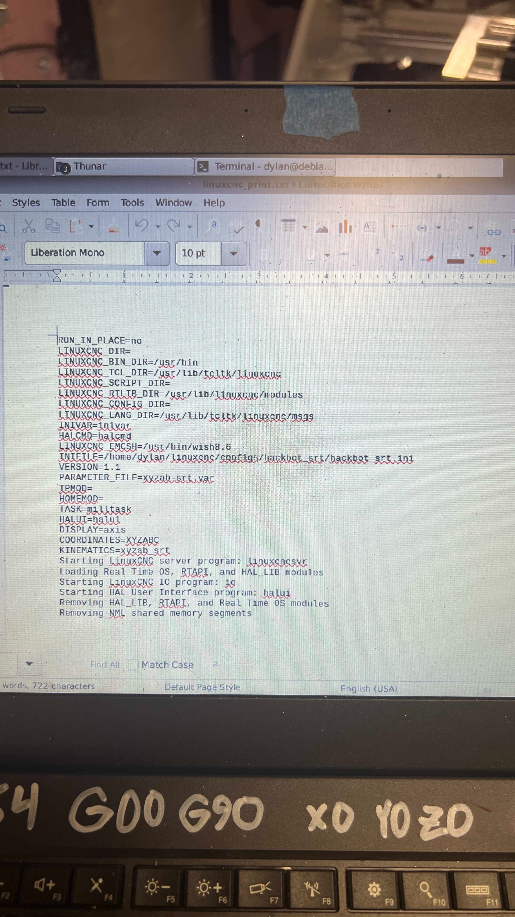

Okay I tried replacing the the .xml and postgui files on your config.  The c axis rotary offset thing is gone and I can def see more of the axis gui it seems, but not all of it, which is weird, seems like I should just be able to drag a window up to be shorter or something...
I did everything you said to do with my config and have attached all the debug file that showed up when I tried to launch.  These are debug files from terminal as well as I tried to launch normally.  I noticed that in the .ini under [EMC] the machine is set to "test2".  I am not using test2 anymore, should I replace this with the name of my new machine (hackbot_srt)?

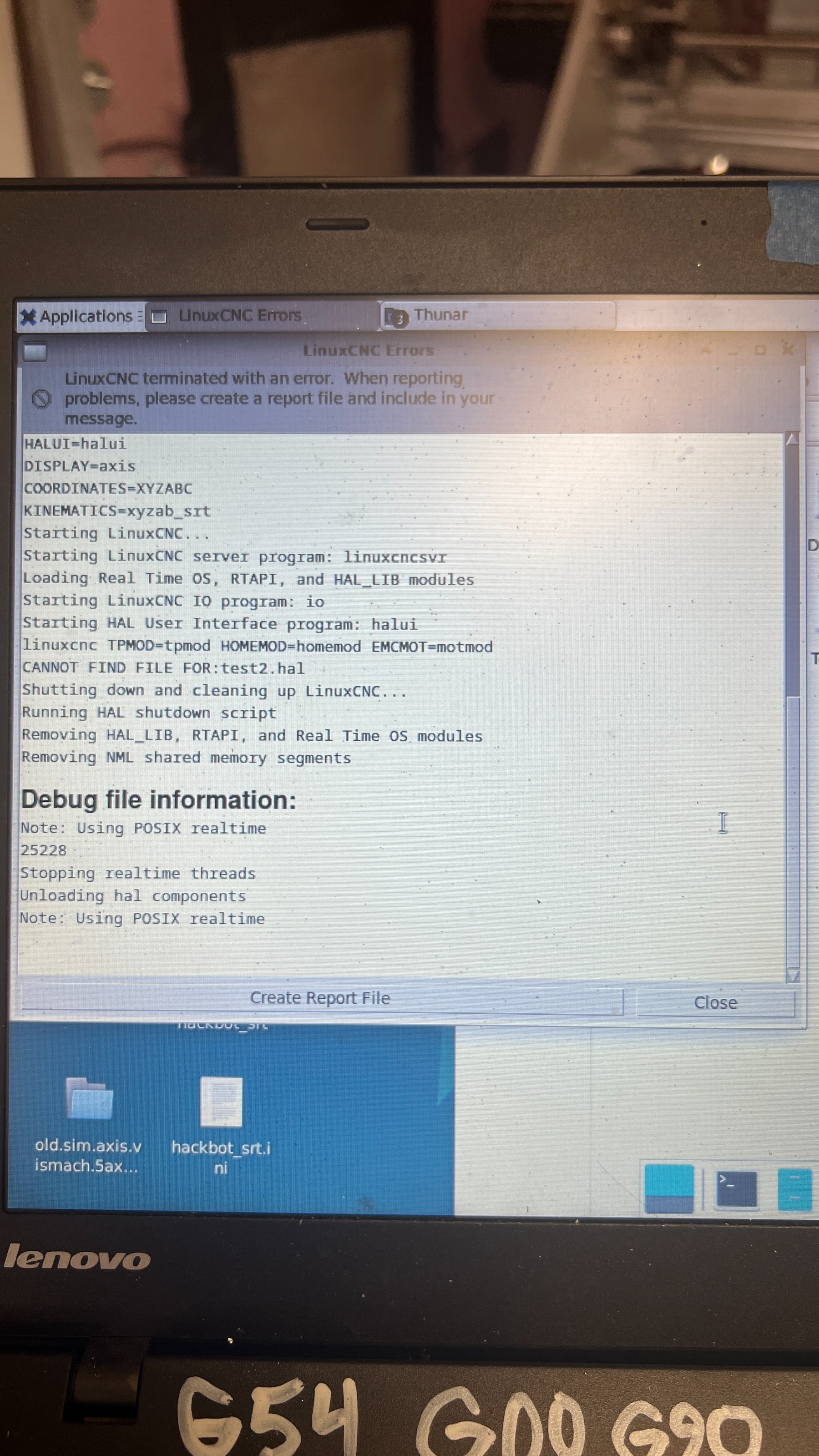

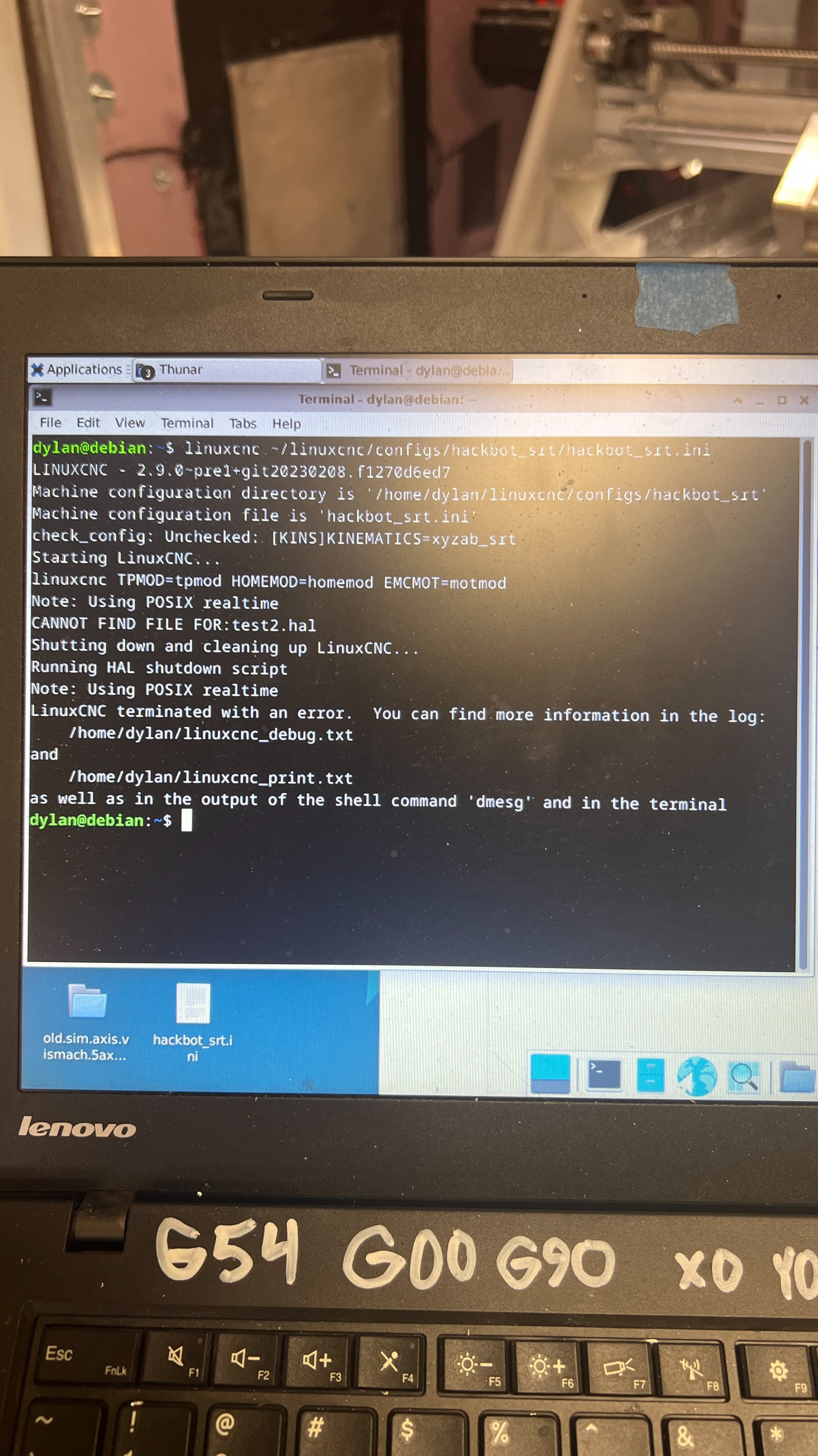

01 Aug 2023 18:33 #276720 by IronManDylan
Replied by IronManDylan on topic Please Help - How to Configure a 5 Axis Head-Head

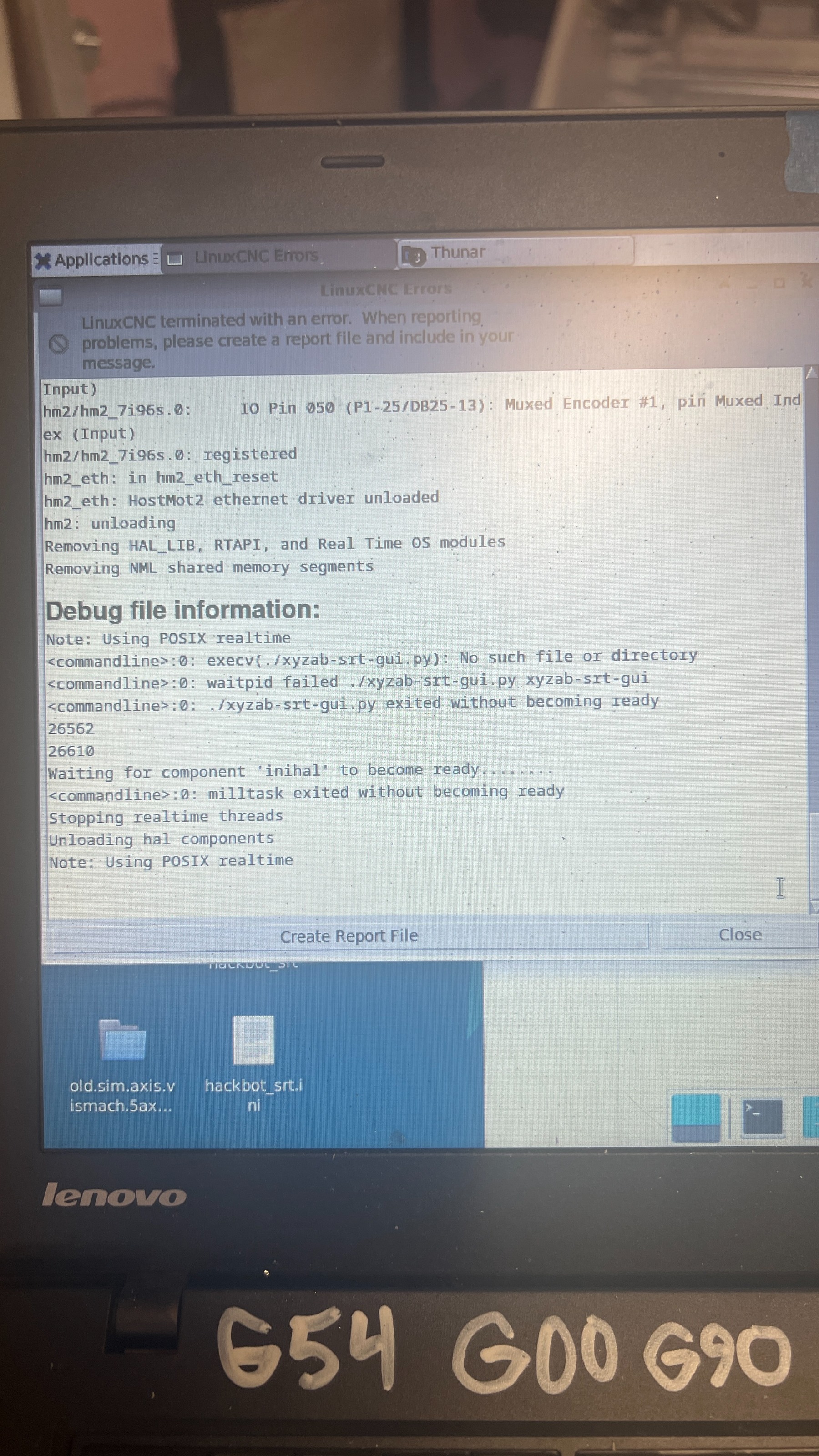

I switched test2 to hackbot_srt (there were two location) and now I am getting a different error.

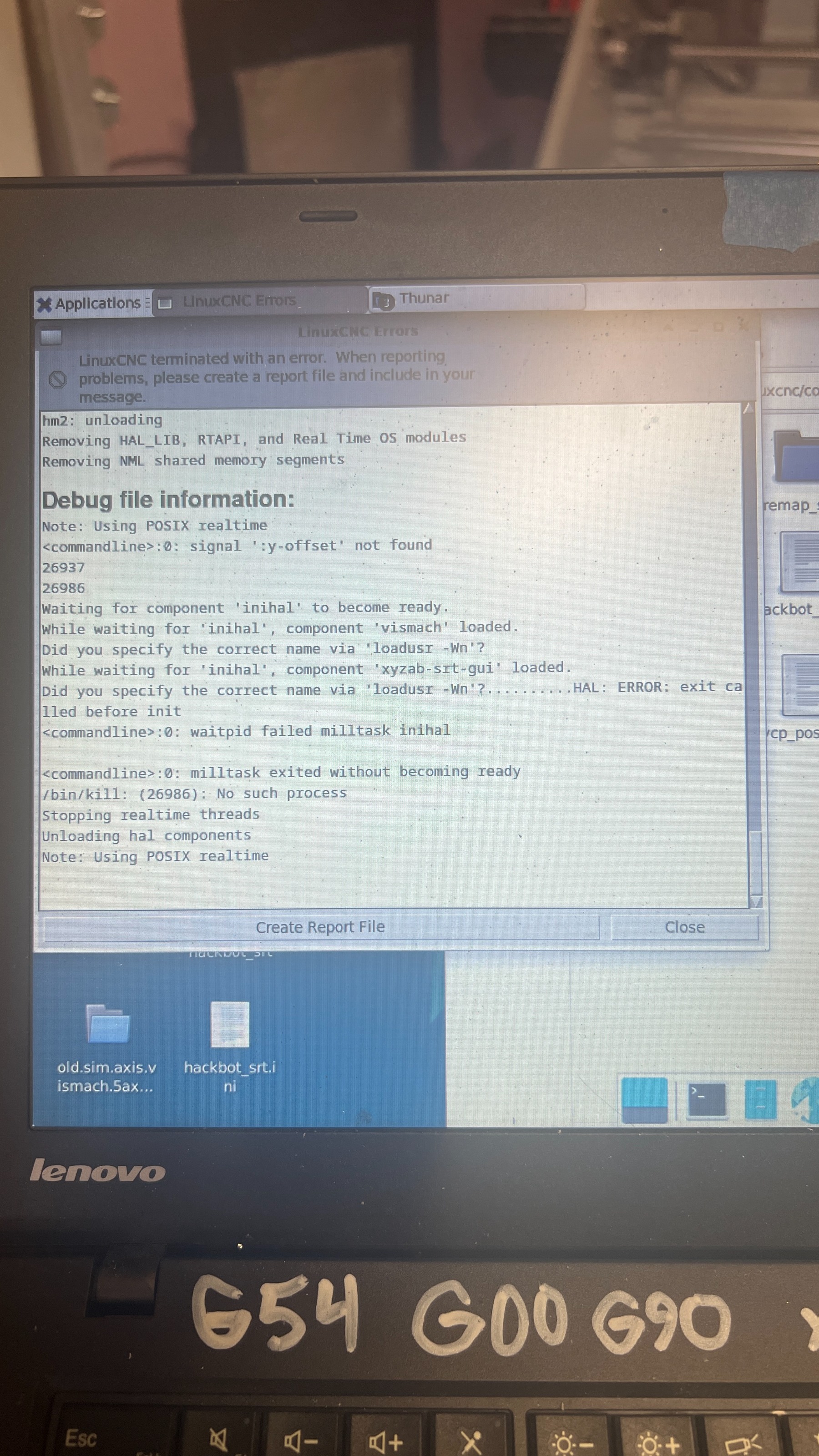

01 Aug 2023 18:43 - 01 Aug 2023 18:51 #276721 by IronManDylan
I tried copying and pasting xyzab-srt-gui.py into my config file and got the following error.  Also, vismach tried to start up during start up, which I don't think is what we want is it? I removed the file..
edit: I searched through all the files and do not see a "inihal" anywhere, perhaps this error is coming from the kins file?
Last edit: 01 Aug 2023 18:51 by IronManDylan.
01 Aug 2023 18:51 #276722 by Aciera
Can you please compress your current machine config folder and post it here?
Do you want the vismach simulation or not?
Because if you don't then there are hal connections we need to remove otherwise there are going to be a bunch of errors about missing pins.

So, I removed the vismach simulation and fixed a bug in the ini. Please replace your current config with the one attached, give it a try and report  back.

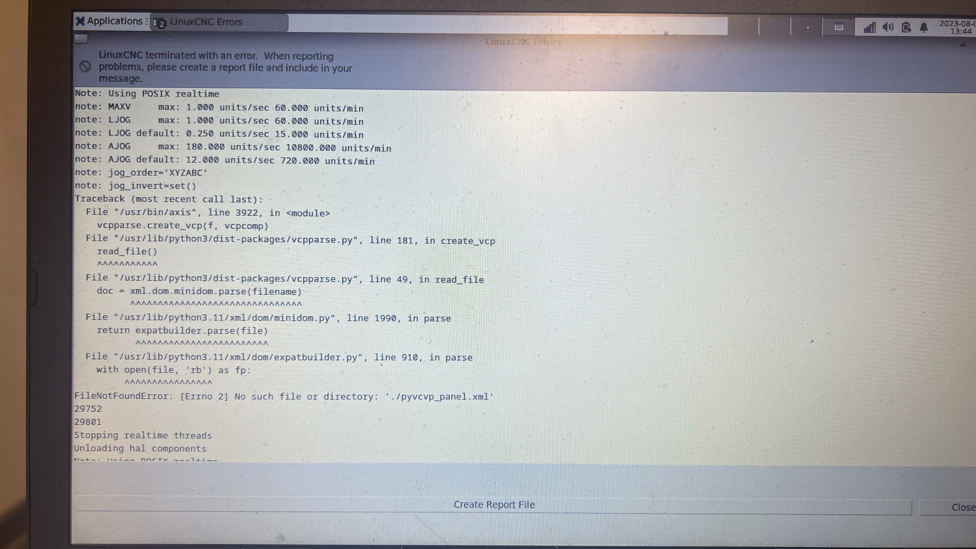

01 Aug 2023 19:47 - 01 Aug 2023 19:53 #276729 by IronManDylan
Okay did that.  Here is the debug info from that run
edit: weird that it say that file pyvcp_panel.xml is not found because it is in there
edit2: oh wait, thats a typo, it says "pyvcvp_panel.html" not found
Last edit: 01 Aug 2023 19:53 by IronManDylan.

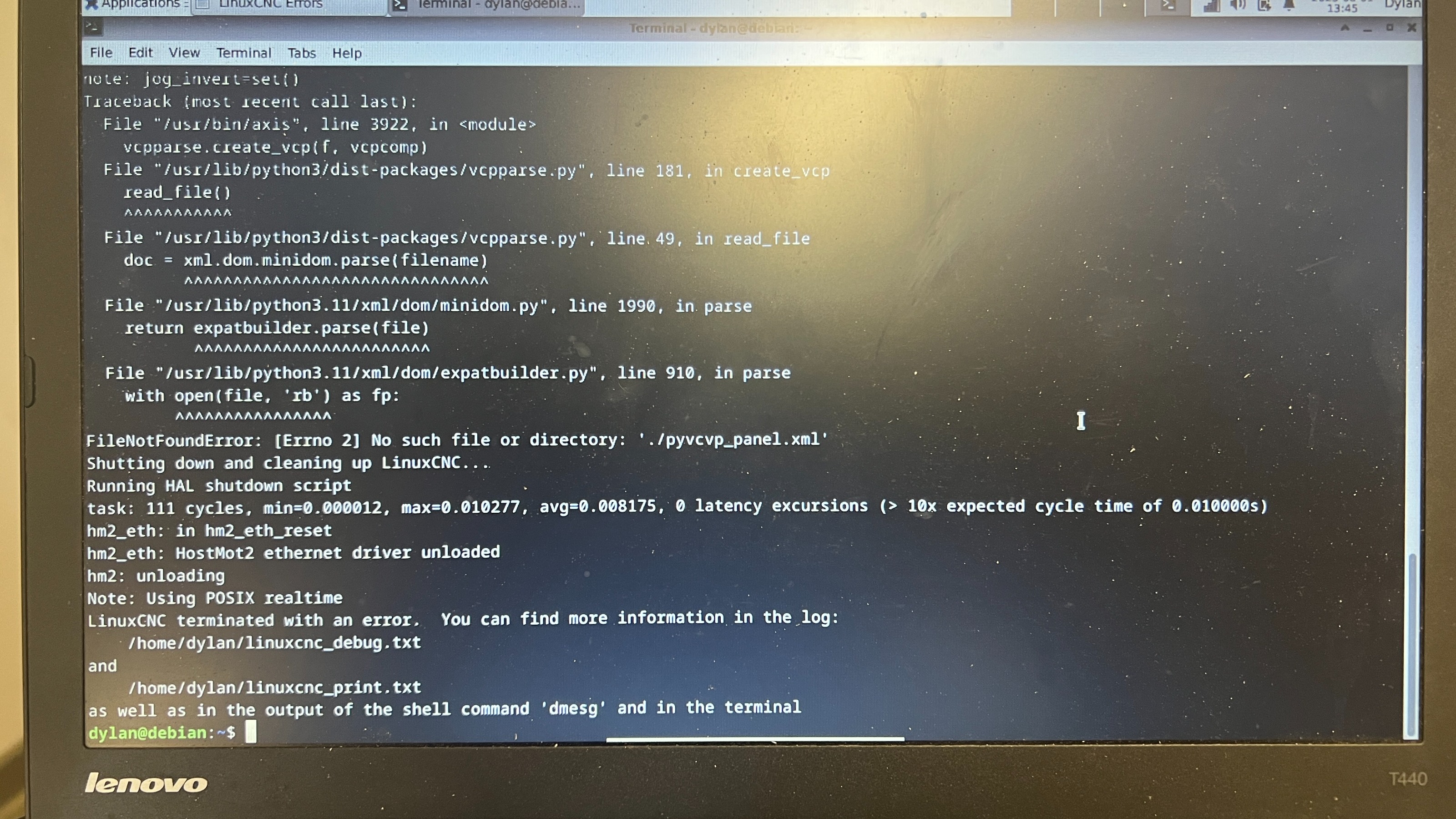

01 Aug 2023 19:57 #276730 by IronManDylan
It looks like that typo is in /usi/lib/python3.11/xml/dom/expatbuilder.py .  I am not sure where that is.
