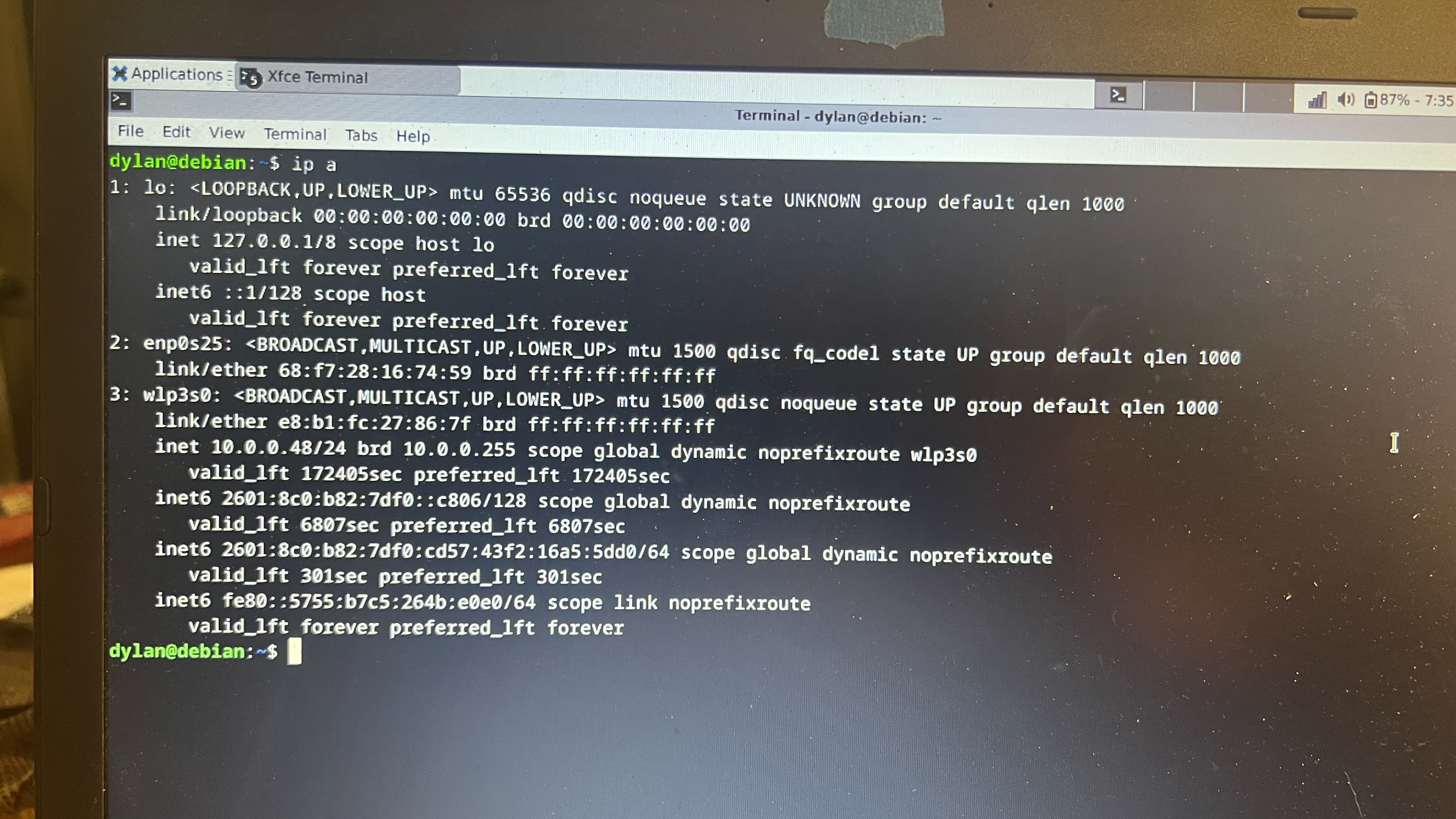

For the mesaflash command to work, you would need
1. 7I96S set for 10.10.10.10 IP address (W4, W5 = down,up)
( you need a 7I96S power cycle if you change these jumpers)
2. Host PC setup with a static IPV4 IP address in the same /24 range
(10.10.10.100 suggested). See hm2_eth manual page.
You can verify host IP address setup with the command:
ip a

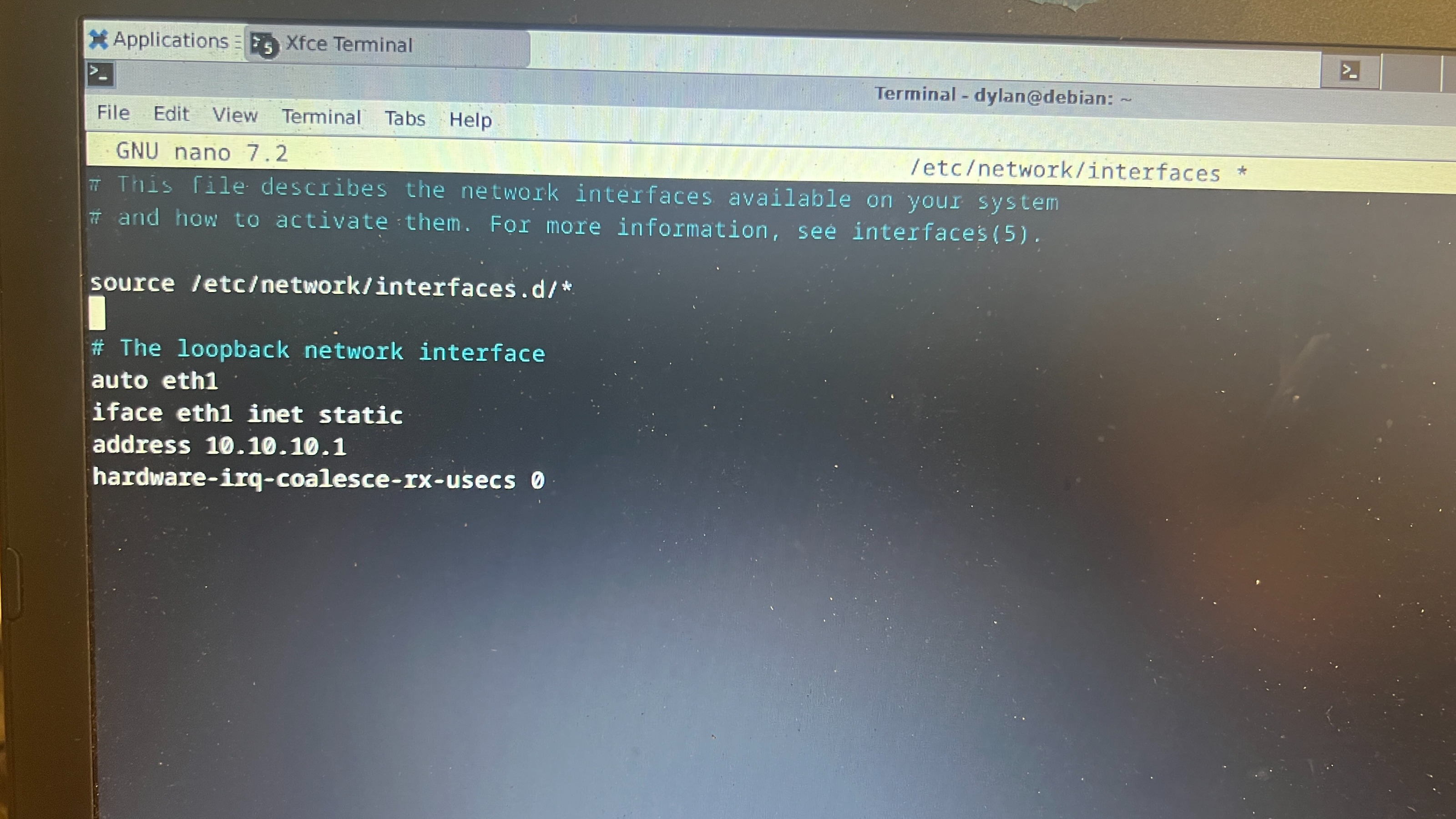

Okay I tried modifying the PC file via this link linuxcnc.org/docs/html/man/man9/hm2_eth.9.html and could not get it to work. I have provided images of both the file and the results of ip a command. This is like readying a foreign language to me a little bit, so I apologize if I am missing something obvious. I also tried with the address set as 10.10.10.10 as well as had auto lo and iface lo inet loopback still in the file and those didn't work either.
I modified the 7I96S with the jumpers as you stated, according to the board this puts it in EEPROM mode, so does this mean it is getting the address from the PC?
I am still getting the error "No 7I96S board found" when I try to connect via mesaflash.
Note: I don't think the computer has connected to the board once, it looks like there is a connection status light on the board that I have not seen light up yet.

25 Jul 2023 02:17 #276195
Replied by tommylight on topic Please Help - How to Configure a 5 Axis Head-Head
enp0s25 instead of eth1, twice
The following user(s) said Thank You: IronManDylan

25 Jul 2023 03:46 - 25 Jul 2023 04:14 #276198
by IronManDylan
Replied by IronManDylan on topic Please Help - How to Configure a 5 Axis Head-Head
Tommy
That worked! The pins are all showing secondary function "none" on the 7I85S, I'm sure theres a jumper that needs to be changed, going to look through the manual now. Edit: doesn't seem like this is a jumper thing, something programmed through mesaflash?
But PCW, you're saying that a stepper motor driver shouldn't be plugged into step+ -> step+ and dir+ -> dir+ ? Should I go change my wiring to:
