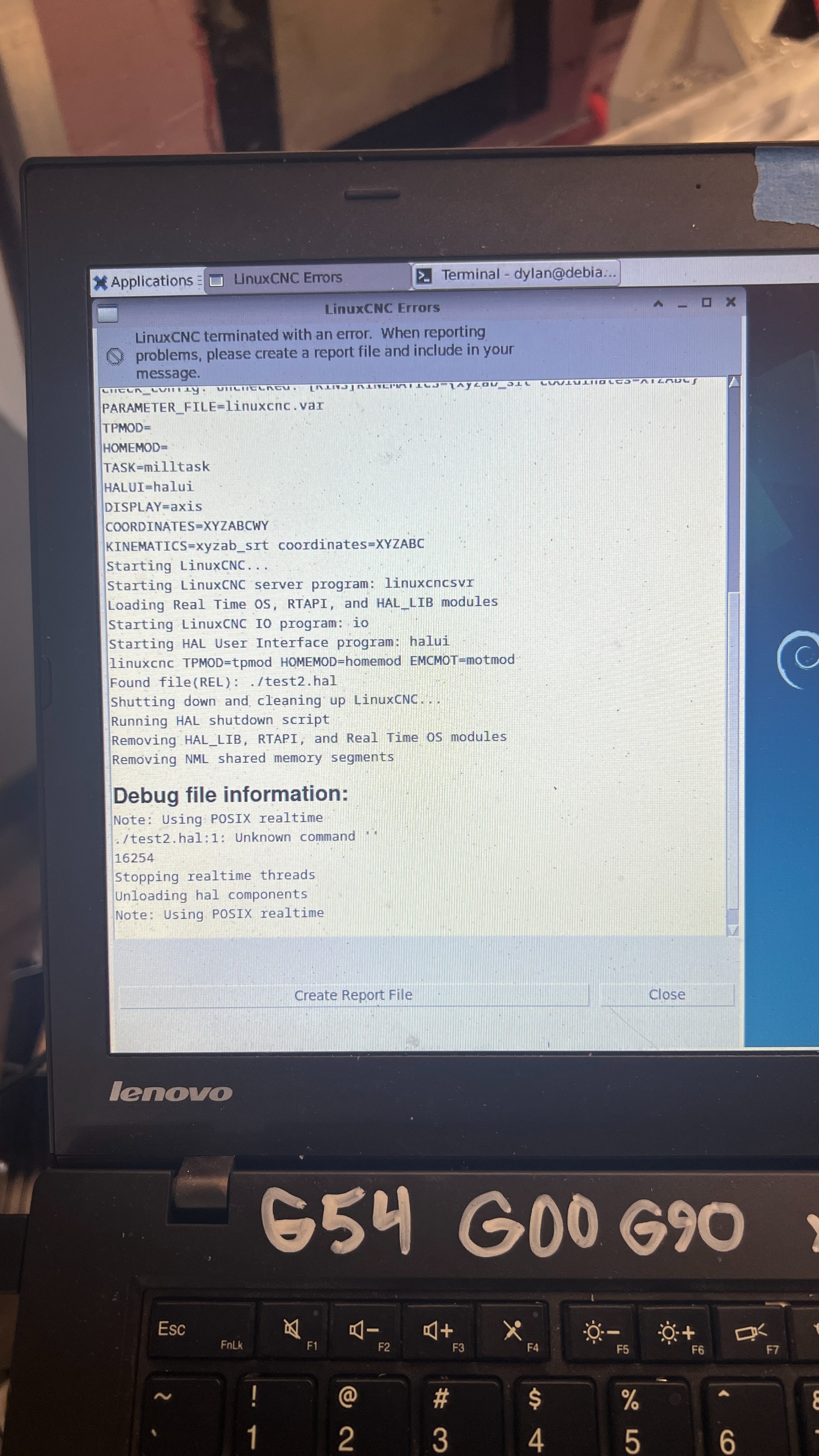

I modified the code as you suggested Aciera and am still getting the same error when I try to launch on LCNC. Maybe it is something to do with editing in Visual Studio and/or some kind of copy/paste error. Or some other mistake that I made. I will go through the code with a more fine tooth comb, but I will add the new code and the error I am getting for reference here. I don't know what it means by ' ' as a command... I did relaunch my test config and it still connects to and moves the machine, so it is not a connection issue.
Note: I moved the axis around so they are now oriented to work with the new xyzab_srt kins file. Because of the way I wired Mesa, the pin number and joint number are the same per axis. The .ini file is set to use xyzab_srt as the kins file, the joint number is 6, xyzabc.

Not sure if this is the issue, but i would avoid using Visual anything to edit the files, it is complaining about unknown command.
Try Geany or just use a simple text editor.

there is a program (you may need to install with apt) called dos2unix
run your files through it just in case there are spurious CRLF pairs in your file as it will remove them.

Lol, yeah I would be surprised if VS caused issues, but I have been using LibreOffice to do some editing on the laptop, so maybe that introduced some errors. Spumco, do you know if VS has a debug built in that I could use? I have downloaded the LinuxCNC extension but cannot get it to run debug. I am new to VS code.
Rodw, okay is dos2unix something I should install on the linux laptop and run through terminal?

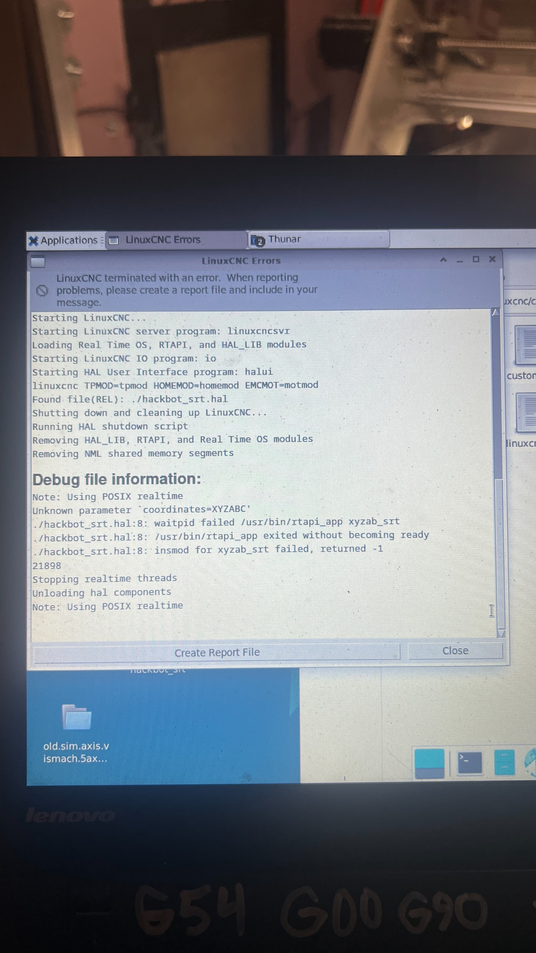

Got it moving! Not sure what the problem was, but I created yet another config (for some reason I cannot use pncconf to modify an existing file all though you are supposed to be able to. It throws up an error when I try to click past "external controls". Anyone know how to fix this?) then more carefully edited things. Never got the weird ' ' error and worked my way through the other bugs. Now XYZAB are working, I'm going to go add C now.
For future reference, it may very well have been LibreOffice causing the issue, I was careful not to use it. Though I am using VS code.
Kins is still on trivkins, but hopefully we can get xyzabc_srt kins working tomorrow or soon!
Edit: Looks like I got the C axis in there too. I don't actually have the C axis fully assembled yet, so I don't have anything plugged into C and can't see if it's moving, but it shows up in axis gui.
Edit2: I tried switching the kins file to xyzab_srt just for sh*ts and giggles and it threw up an error. I'm sure theres more to it then just switching the kins file name, but I am going to add a picture of the error code anyway.
