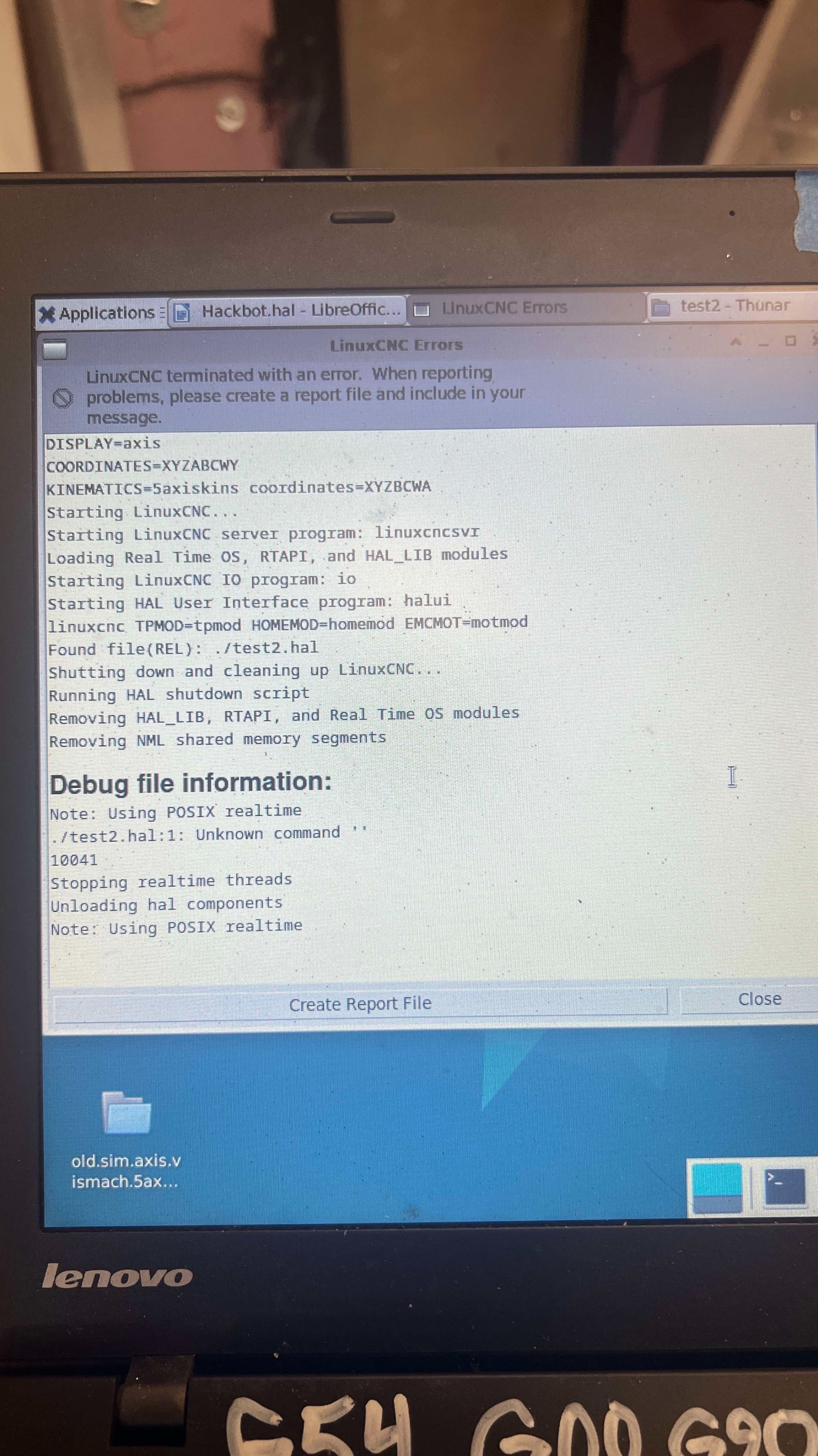

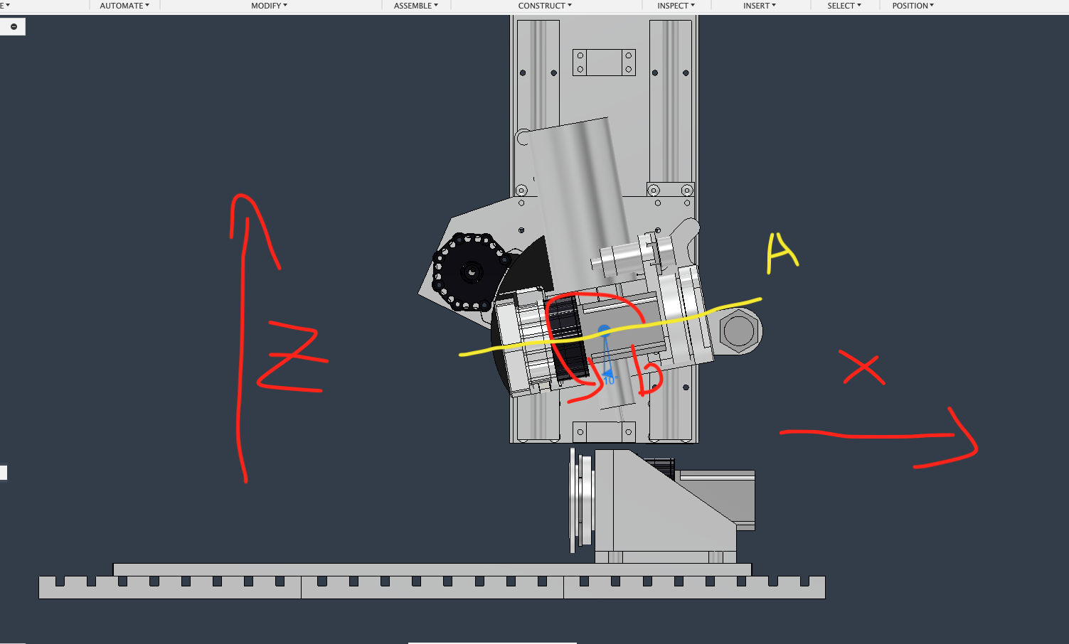

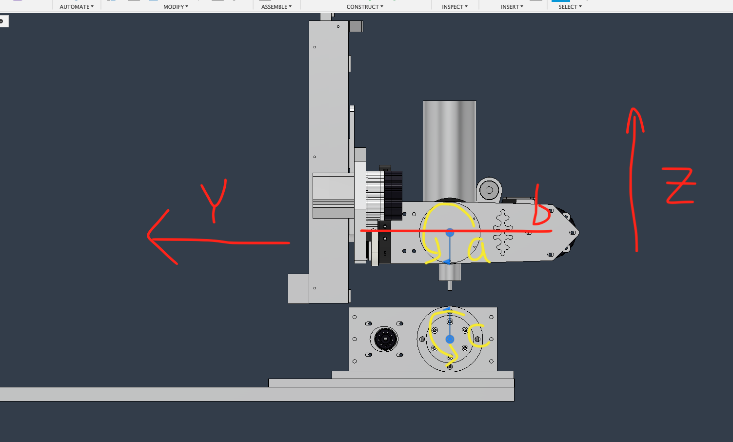

Wow, thats really exciting! Thank you for doing that! I have provided some pictures to give you a better idea of how the machine moves, I can't upload a video.. Note: the axis are labeled how I initial designed the machine, not where the axis is for the bridgemill modification or where they are in the hal and ini files. You are right, given the inaccuracy of the machining, the axis are of course not perfectly aligned. But right now I do not have a good idea on how to measure how misaligned it is anyway so. I am sure there is a way if I think about it but for now was planning to make the assumption that the two axis are perfectly aligned.
I tried to compile the kins file using halcompile as you suggest and got the following error:
"sh: 1: make: not found"
I will also post my .ini and .hal files for where they stand right now. I haven't changed them at all but can delete W when I get you kins up and running!
Tommy
Idk either but it seems like ordering of the joints is important to how the kins files interpret the TCP, that was the case when Aciera initial helped me modify the vismach model.
Tommy

31 Jul 2023 18:40 #276653
$ sudo apt install build-essential
Replied by Aciera on topic Please Help - How to Configure a 5 Axis Head-Head
Run this in a terminal and try again:I tried to compile the kins file using halcompile as you suggest and got the following error:
The following user(s) said Thank You: IronManDylan

That works! So awesome! Really excited to be able to use my machine how I intended to. Thanks so much! So is TCP spinning around some offset point (which would likely be the surface of the spindle?) and "tool" is spinning around the tip of the tool? Also, I ran the gcode, everything looks good on vismach, but the preview is doing something weird. It goes to the tool path for the positioning moves, but then jumps way off the toolpath for the cutting moves. Kinda weird, not sure what this gcode is supposed to do but thought I would point that out.
Also, I was going to ask about this at some point, but I cannot see the bottom of axis gui on my laptop. And I can't even seem to drag the screen up. Going to full screen does nothing. Right now I cannot see all of your "C Rotation Axis Offset" window. Is there a good way to fix this?
Lastly, I tried launching that configuration from my last post to see if it works and would move the axis around and I got the error that I posted a picture of. Note: I copied and pasted all the code from 'hackbot.hal' to 'test2.hal'. This is because I was using Visual Studio Code on my main computer to edit the files and I had changed the name to hackbot there.

31 Jul 2023 19:55 #276658
TCP kinematics keeps the tooltip on the same position on the workpiece while the tool is being reoriented (ie while the rotary axes A and B move). This is basically the same as the 'bridgemill' mode in the bridgemill config.
TOOL kinematics let's you position (move) the tool in the current tool orientation. The demo gcode shows how you can mill a circular pocket in any tool orientation using regular gcode written for a 3 axis mill. This is somewhat similar to the virtual W axis in the bridgemill mode but much better because it tilts the XY workplane to be perpendicular to the tool rotational axis.
Note that it is best NOT to move A or B rotary axes while in Tool kinematics because the rotational center in this mode remains in the machine reference point which can make the effects of such rotations rather surprising to the machine operator.
The preview window is of limited use when using these kinematics because the current work offset is transformed when switching from tcp to tool kinematics (hence why the moves in tool kinematics are done in relative mode).
The screen issue is likely because the custom panel in axis is too long and forces the axis window to extend past the bottom of your screen.
Also the 'C Rotation Axis Offset' is a remnant of the original config I modified this one from and I will remove that tomorrow and post an update that will hopefully also fix the issue of the window not fitting on the screen.

31 Jul 2023 20:21 #276660
by IronManDylan
Replied by IronManDylan on topic Please Help - How to Configure a 5 Axis Head-Head
Aciera
Ahhh I see about TOOL now, I was confused because I was moving the rotary axis in that mode. So it is like what W was doing but way better because it allows all the linear axis. That's too cool haha. Now I am curious, so it looks like you added a few lines to the 3 axis gcode to a) kick the head over to whatever angle you had the head set to and b) switch the machine from TCP to TOOL mode? Guessing here because I can't view the gcode. The switching modes seems to explain some of what is going on with the preview be a little weird. Makes sense with the work offset being changed.
Yeah, the panel is too long. But this has been the case with every configuration I have opened. Some of each of them have been chopped of at the bottom. I really have not been able to view the gcode that is being sent to the machine because this interface is what is being obscured.
Awesome thanks for posting an update. Really appreciate your help.
