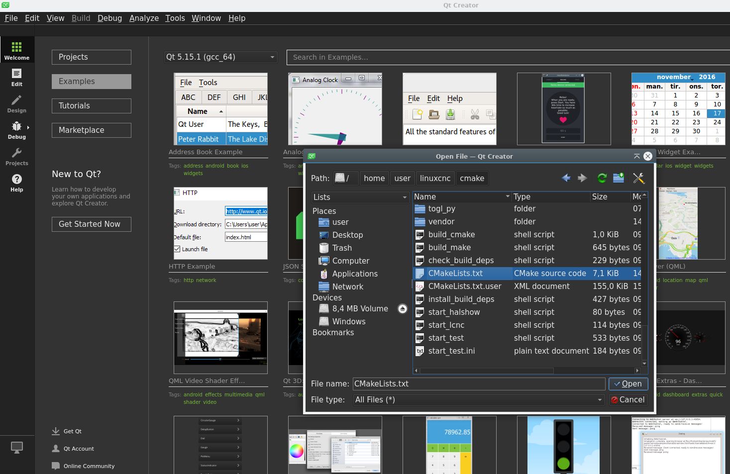

@Grotius - I can see you are using qtcreator as your editor/IDE. Any advice on how to import the exiting project into Creator?
Do you have it managing the cmake files or is that outside the control of Creator and you just import things as a non cmake project so Creator is kept as a simple navigating/editing IDE?
Thanks - J.
In qt open the cmakelists.txt file, and it loads the project. You can also build it with qt, but to install you can
use one of the build scripts.
Thanks you for the names. ! We choose the next on the list : T-800 Model 101
Thanks for the ngc file.
