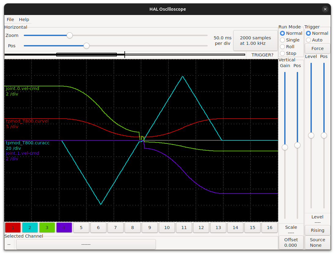

Interesting graphs with the velocity commands diverging. Do we know why that is happening?
- dm17ry
- Posts: 212
- Thank you received: 91
17 Nov 2023 12:27 #285764
by dm17ry
Replied by dm17ry on topic Debian 12 - 2.9.1 image for the Raspberry Pi 4b/400
i suppose we do... i'm probably stating the obvious, but...
when passing any trajectory kink without a complete stop on it - x, y velocities will have a discontinuity.
when passing a transition from a line to an arc - accelerations will have a discontinuity.
some type of blending is required for all transitions: line-line, line-arc, arc-arc.
i guess opencn guys solved that with some matlab witchcraft...

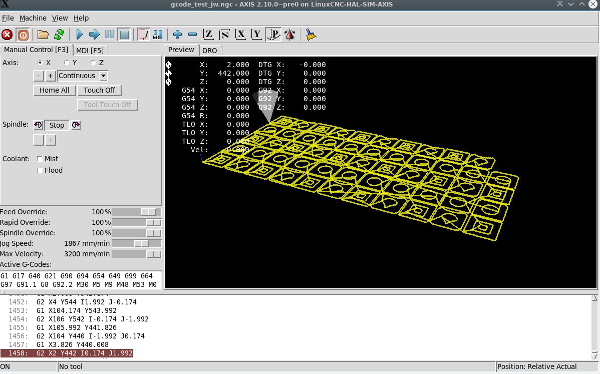

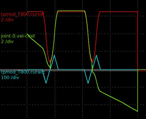

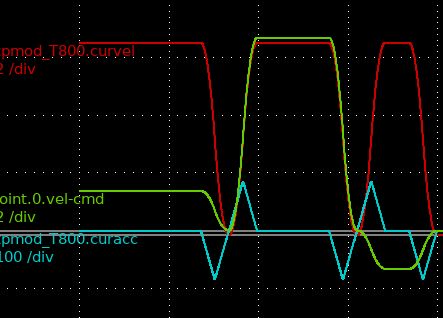

Ran a test of the t800 scurve TP on the plasma. Started out with no ve enabled. Was running like before. Enabled ve with a value of 1. All ok. Set value to 10. Soon after got follow error on a joint and things core-dumped. Will find the time to do a closer/more considered look and try and try and capture screens so we zero in on the point of following error.
I also have max_jerk set at 3000. Might dial that back a bit as well. NB: max acceleration is set at 3000mm/s/s.
Video of the full test file:
Edit: Second run with joint 0 follow error being tracked. Think this needs more investigation as things core dump before any follow error gets graphed.:
This gcode file seems to generate a crash on both the sim and the plasma table. Note that the "crash" in the sim seems to silent. Things just stop at the same point but nothing relevant is trapped in logs.
Cheers - J.
Cheers - J.

Hi Joco,
Thanks for testing and showing us the following error.
It's clear we can not use velocity end values if path's are non colineair.
Do you think you can get rid of the pause delay between full stops?
I think it has to do with input values of acc or jerk. If you add hal pin for jerk,
you can set the jerk in the planner during runtime to test different values.
In the future we could code online blending for the planner.
Today i go to invest some time in a out of the box lcnc startup method.
I found a interesting video, at 23:24, can someone explain to me how to solve this matrix?
This looks like the ruckig algo.
Ok, have a nice day so far.
