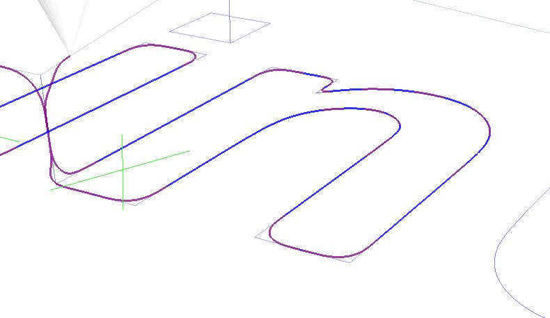

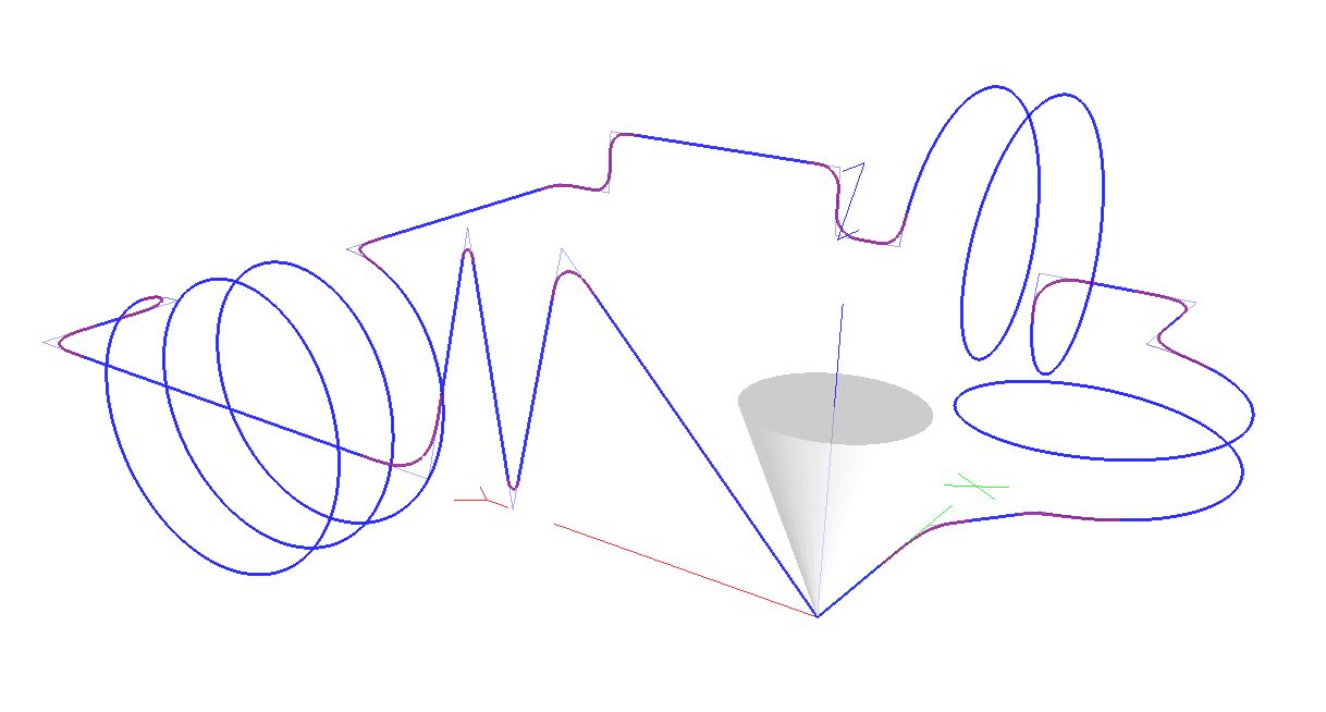

Replied by Grotius on topic scurve trajectory planner
@Lcevette,
that is awesome!!
We hope so.
I had to add extra logic to the arc-helix.
When the arc-helix is trimmed at the front, i had to update the center point.
As the old center at the front is off plane after trimming.
The result looks ok now. Helixes in plane G18 & G19.
Deviation = 5.
If there are shorter segments, the clothoid fillet previews to be tinyer.
Also working on the look ahead now.

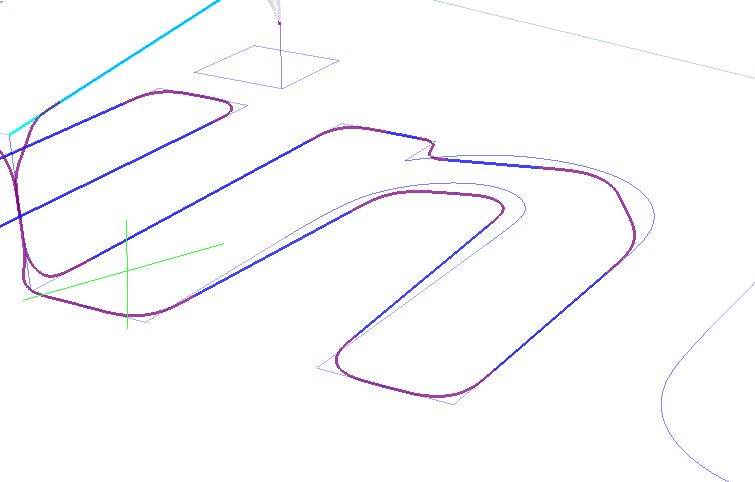

@ihavenofish,
how does it deal with tangential motion that exceeds acceleration abilities?
We calculate the max segment velocity based on curvature extrema and maxacc.
The implementation of this funtion is here.
I agree that deviation is the key. And the possibility to blend out multiple segments respecting path deviation.
Concern:
Today i experienced unwanted interpreter behaviour. I did know the problem was there, but forgot about it.
In the case of our planner, we have to always use the combination G64 P[x] Q[0.0] to prevent this behaviour.
This behaviour can also been seen on page 3.
The examples made by Hmnijp used no G64 Q[x] value. And planner did remove segments on it's own,
replacing arc by lines etc. Trimmed segments are clearly off path, wich is not ok.
It shows exactly the problem. If Hmnijp used a G64 Q0.0 value, the result would be very different.
Now i added this as a note to the planners readme file, that users including myself are aware of this, and don't forget about it.
With no G64 Q[x] value, we get unwanted interpreter input:
Using G64 Q0.0, we get what is to be expected from interpreter:
Concern:
- When no G64 Q[x] value is given, the interpreter removes tiny segments on it's own, replacing arc's with line's etc.
The following user(s) said Thank You: smc.collins, hmnijp
