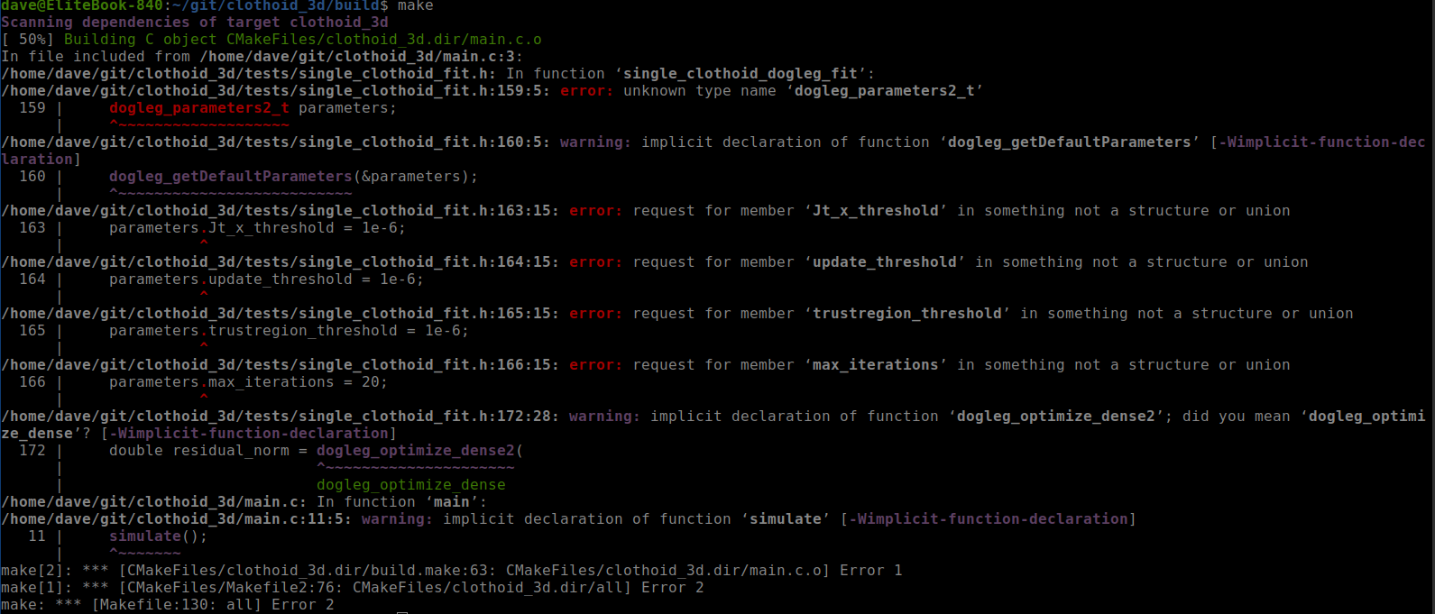

19 Feb 2025 13:53 - 19 Feb 2025 13:53 #322013 by Aciera
Replied by Aciera on topic scurve trajectory planner
Moved to another PC, installed 'libdogleg-dev' and I seem to get a little further but not much:
Anyway, I'm afraid there is not much I can think of to help as I'm really starting a zero with these dogleg solvers.

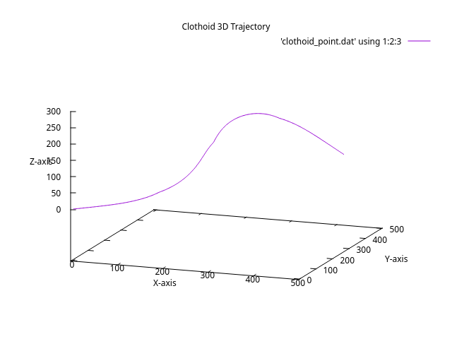

Today i started coding the clothoid compound fit using the gsl solver. It worked right away.
I think because yesterday we did it succesfully for just one clothoid.
This is really a milestone for us !!!
What we see here is a 3d clothoid spline, build from 4 individual clothoids, given start, end posture.
Given the abstract :
"Space corner smoothing of CNC machine tools through developing 3D general clothoid"
by Qun-Bao Xiao, Min Wan, Yang Liu, Xue-Bin Qin, and Wei-Hong Zhang.
Published in Robotics and Computer Integrated Manufacturing, Volume 64, 2020.
However if you look closely at the individual clothoid curve transitions there is a tiny change in curvature.
Somewhere in the code is a buggybug.    and or alien obstruction.

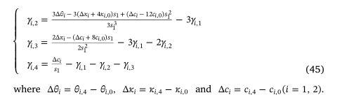

I think in eq45 where the constrains of the joints are calculated must be something signed to "-" ?

Converged after 315 iterations
Solution found: gamma10 = 0.000000, gamma20 = -0.000000, s1 = 198.587624
endpoint x: 520.050004 y: 266.500006 z: 125.499999
The following user(s) said Thank You: akb1212
20 Feb 2025 06:10 #322050 by Aciera
Indeed! Congratulations.
Is eq 45 in the loop yet?
20 Feb 2025 06:21 #322051 by Aciera
I can't quite tell from your repo so you may already have but just in case:
Remember that we need to run eq 45 with the gamma11, gamma21 and s1 values found with dogleg. With the 6 resulting gamma values it should then satisfy G1, G2 and G3 continuity.
The following user(s) said Thank You: akb1212, Grotius
20 Feb 2025 06:38 #322053 by Aciera
I don't think these gamma values look right:
yi1: 0.000000
yi2: -0.000001
yi3: 0.000001
yi4: -0.000000
yi1: -0.000000
yi2: -0.000000
yi3: 0.000000
yi4: -0.000000
20 Feb 2025 06:45 - 20 Feb 2025 06:47 #322055 by Aciera
Actually the problem might be in the dogleg algo, seems odd to me that gamma11 and gamma21 are zero.
Could it be that we are only solving for variable s1 instead of [gamma11, gamma21, s1]?
Last edit: 20 Feb 2025 06:47 by Aciera.

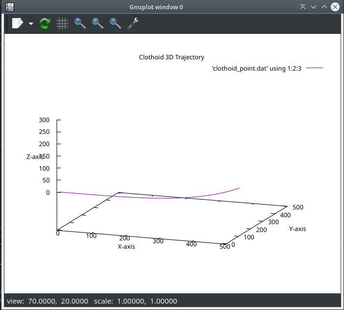

20 Feb 2025 06:46 #322056 by Grotius
Replied by Grotius on topic scurve trajectory planner
@Arciera,
I made a test : clothoid_compound_no_fit();
This visualises the problem quite good. This example uses no fit for endpoint. So the clothoid compound
behaves as a natural attached curve.
eq44 is reviewed and i added the for loop check calculations as in the paper.
However the tresholds results there are ok.
eq45, i can not find any typo's.
eq45 is sub off eq44_G123. Yes eq45 is in the loop.
Yes. eq45 is called for xy and for z.
Then yi1 is called like : y11 for z
Then yi1 is called like : y21 for xy.
This to avoid code duplication.
