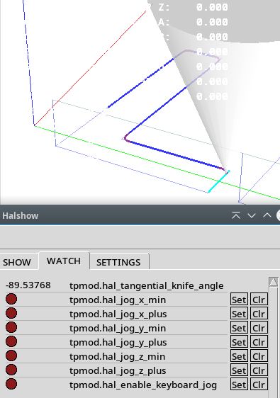

- Grotius
- Posts: 2419
- Thank you received: 2349
27 Mar 2025 09:40 #325064
by Grotius
Replied by Grotius on topic scurve trajectory planner
Hi all,
Today a new feature is added to the planner.
Jog in pause state.
It captures keyboard buttons for xyz axis in pause state.
This feature should work for every used linuxcnc gui, axis, gmocappy, qtvcp, etc. The whole mickmack.
When resuming the motion, the xy is running back to pause-pos, then the z is running back to pause-pos.
Next feature is tangential knife.
Will do that next time.
Jog in pause state.

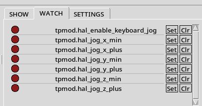

- Grotius
- Posts: 2419
27 Mar 2025 14:06 #325089
by Grotius
Hi Guys,
Thanks for feedback.
Now we added hal pins for jogging xyz in pause state.
The halui pins are unreachable from within the tpmod component.
Then tpmod has it's own hal pins for jog in pause.
For the one's who still want to do keyboard jogging in pause state, like plasma cnc's :
- enable the jog keyboard hal pin.

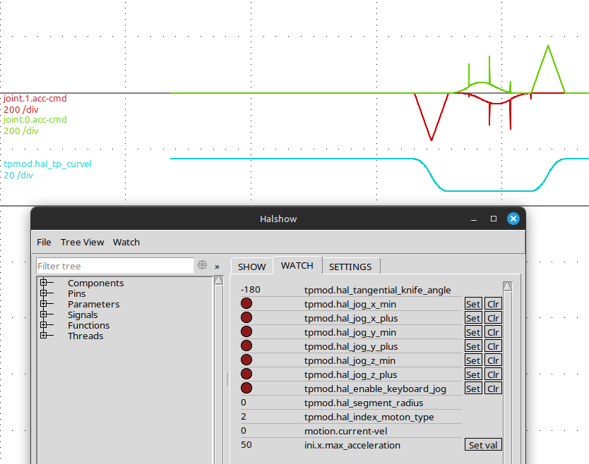

28 Mar 2025 10:03 #325166
Replied by Aciera on topic scurve trajectory planner
I did a quick test on my non-rt installation running 'cmake/nc_files/fillet/square_100x100_P5.ngc'.
1. it seems that inital deceleration and final acceleration along the fillet do not respect max_acceleration settings (50 for x in my case)
2. there seem to be acceleration spikes while traversing the fillet
Below is the captured accelerations for X and Y for the first corner of the rectangle:
