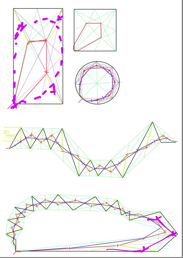

29 Jan 2025 05:13 #320071
by Grotius
Replied by Grotius on topic scurve trajectory planner

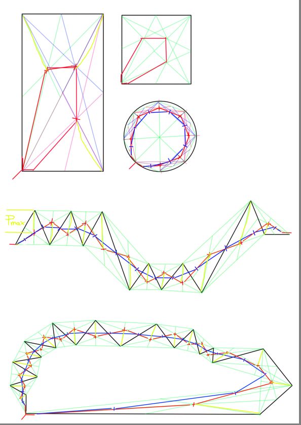

I was thinking about a algo to smooth trajectory path's. This is just an idea.
1. Create a triangle's & find gravity point off triangle's. Triangle is constructed in a loop by path point's n+0, n+1, n+2.
2. Max deviation point lies on the line n+1 up to the gravity point, but not exceed the gravity point. P=0 up to P=Infinity.
3. Connect the gravity points by a line. (red).
4. Create half way line points on the line. (blue).
5. Connect half way line points by linestrip. (blue). Second stage.
6. Replace linestrip by a cubic spline.
Properties:
Works in 3d space.
Conversion of arc's to linestrips is required.
The new trajectory tends to move inwards when on a circle.
Let me know what you think.

1. Nice
2. Seems unproblematic as that is what a lot of cam output does anyway and deviation can be easily calculated and adjusted.
3. I think that's the same behavior as the current planner.
Replied by Aciera on topic scurve trajectory planner
Works in 3d space.
1. Nice

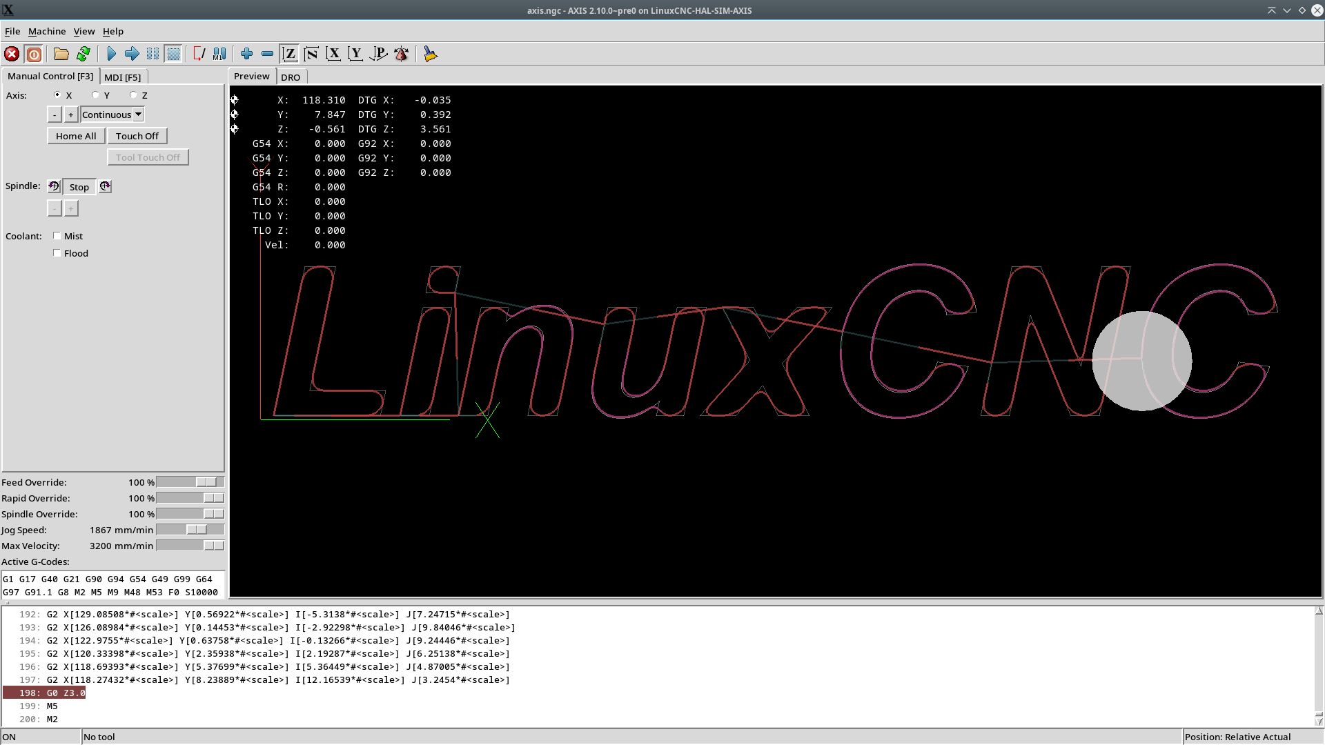

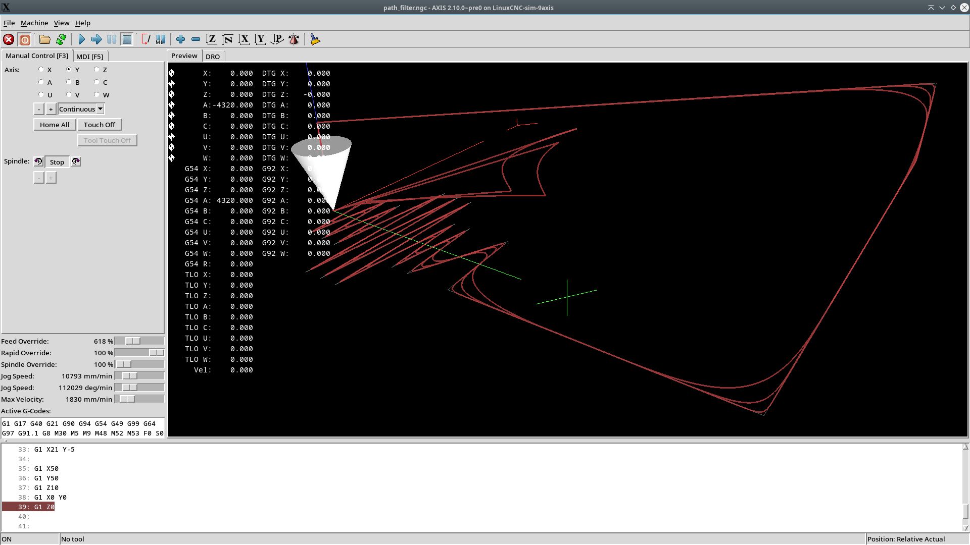

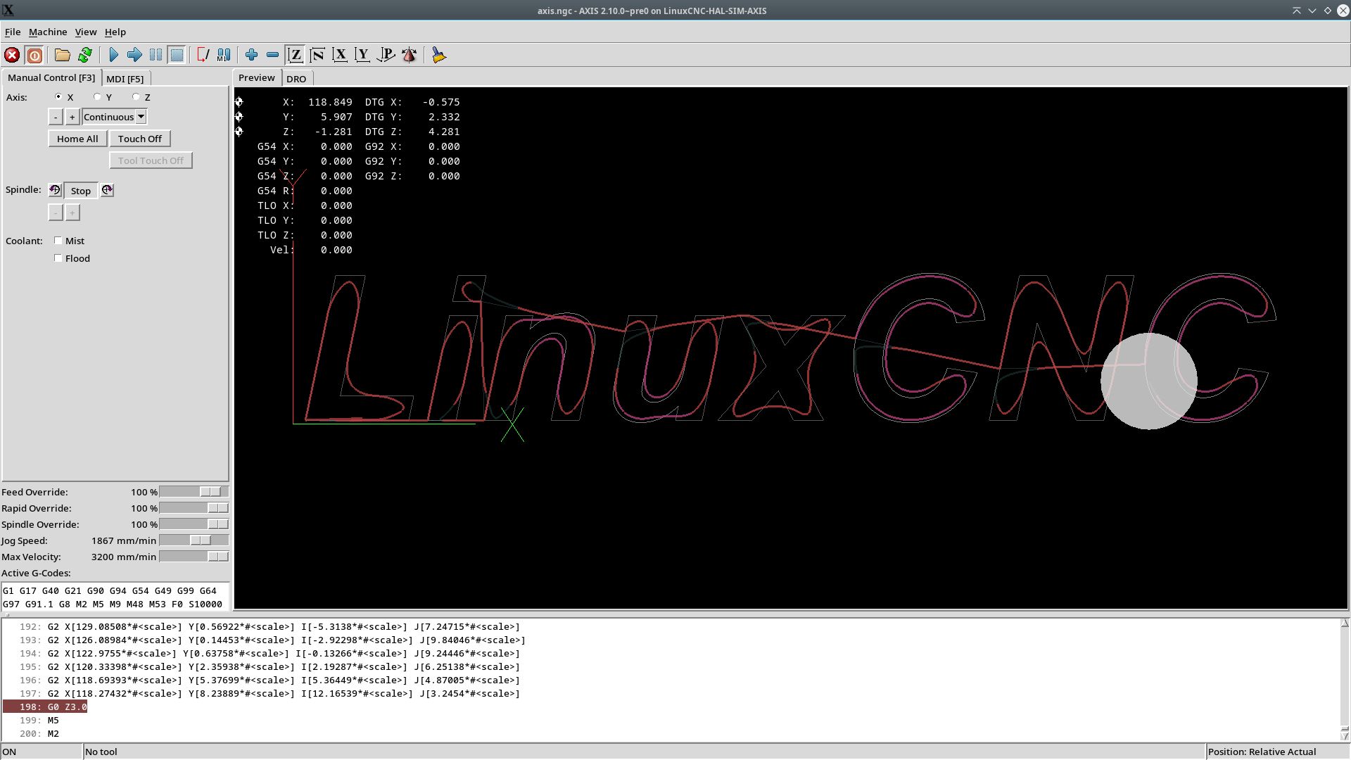

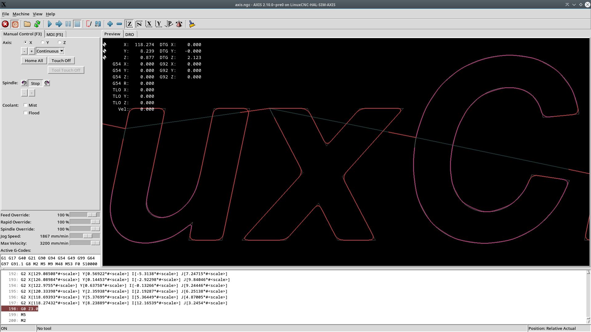

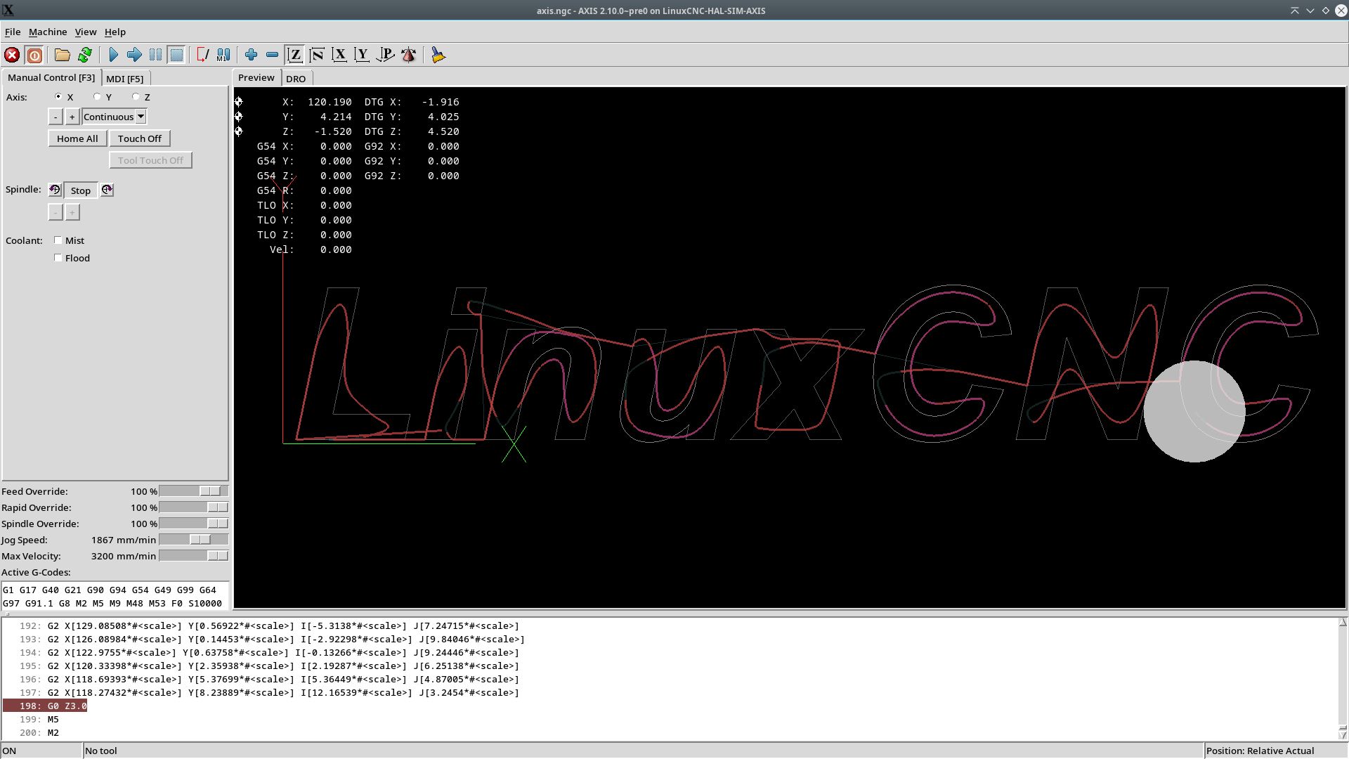

Today i thought maybe add a path filter to the planner. This is also just an idea that came up.
It uses no G64 P[x] value.
It uses no path blending and or fillets etc.
It works as backend filter for any path using G64 P[x] values.
It uses a hal_path_filter input parameter between 0 and 3000. Imagine 0 up to 3000 servo-cycles.
This is a simple algoritme that calculates the avarage of toolpath points [bufsize] in real time.
The runtime property is that how lower the speed, how closer it gets to the path. Deviation is small.
How faster the speed, deviation becomes bigger.
If normally the motion stops every gcode line because no G64 P[x] value is given, this algo keeps
up velocity's. In fact it automaticly generates endvelocity's for the trajectory.
In halscope the joint.x velocity and acceleration values, are nice.
hal_path_filter = 500
hal_path_filter = 1000
hal_path_filter = 2000
hal_path_filter = 3000
Show multiple filter values, 500, 750, 1000.
Let me know what you think?

- Grotius
- Posts: 2419
- Thank you received: 2349
30 Jan 2025 09:04 - 30 Jan 2025 09:30 #320152
by Grotius
@Arciera,
Thanks for responce.
Yes, looks like so.
@Julian,
Also thanks for responce.
I like the idea also. So you want to go nearer to the points before doing a spline.

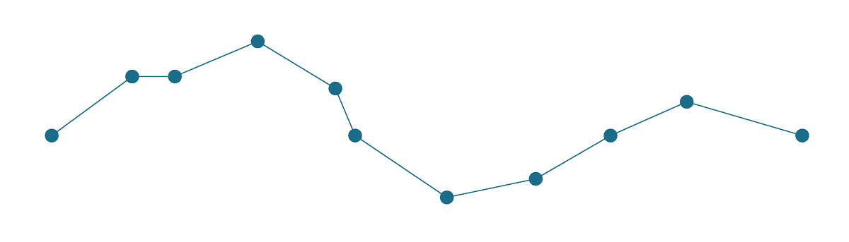

The idea is polyline simplyfication. Then i thought maybe use :
Douglas-Peucker
Visvalingam-Whyatt
However both algo's don't satisfy cnc path smoothing.
Then i tried something on a paper with a pen myself. And came up with the triangles
centroid idea.
In Cgal they use the idea off convex hull for triangles.
However,
this idea is not really using a convex hull method, it's more like a forward sweep convex hull or
triangle-fan.
When the resulting line strip looks ok. Then doing a splinify is problably most succesfully.
However, if you use the "filter algo from previous post" then used as the planners back-end,
the result is maybe good enhough, you don't need the splinify.
Splitting in half between edgepoint and last point if next angle is the ame direction. And going one step back if the direction will change (not perfectly described of course).
I don't get it. . But does'nt matter. Thanks for your help yesterday !

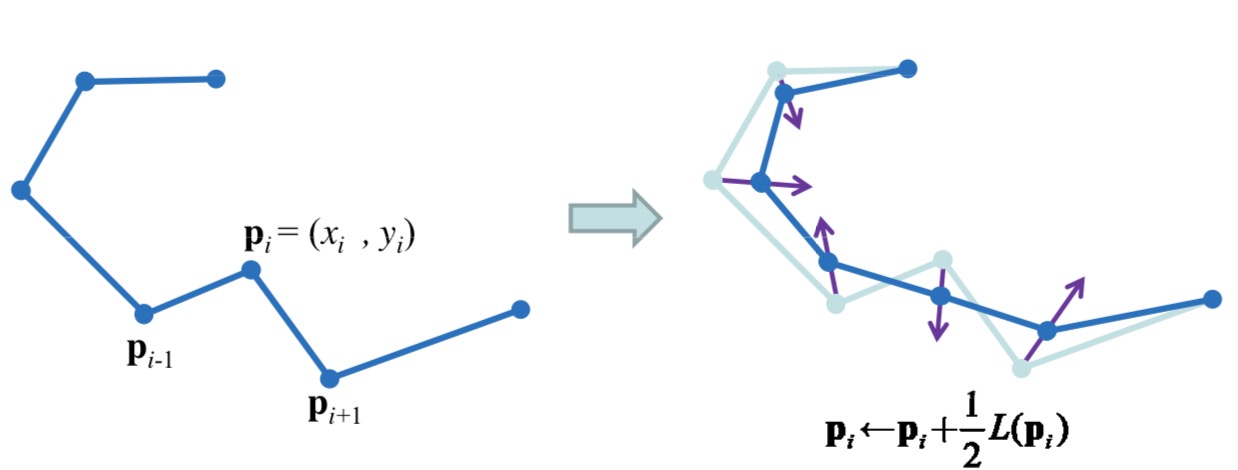

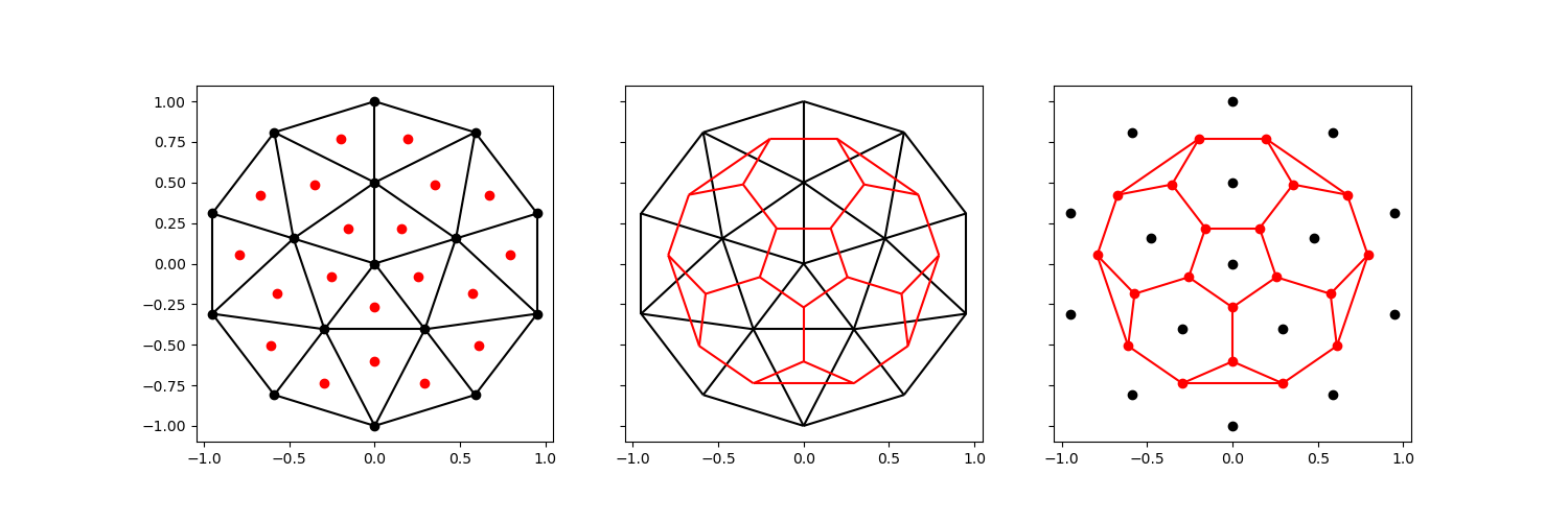

From DeepSeek:
Possible Names or Related Algorithms:
Laplacian Smoothing:
A common technique in mesh and curve smoothing that averages points with their neighbors. Your method is somewhat similar but uses centroids and halfway points instead of direct averaging.
Centroidal Voronoi Tessellation (CVT)
While not a direct match, CVT involves optimizing point positions (like centroids) to achieve smoothness in a geometric structure.
It looks like the algo is similar to Laplacian smoothing for the first stage. liqimai.github.io/blog/AAAI-18/
However the Laplacian is not using centrold's. And here it show's only the 2d solution. And algo is
working different as we use it.
Then it has no second stage.

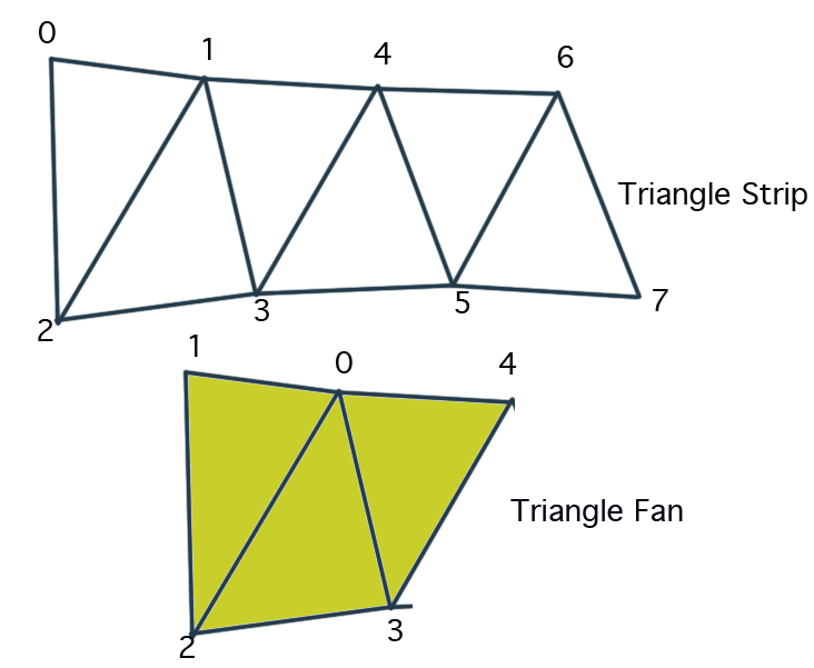

However,
triangle-fan.
From DeepSeek:
