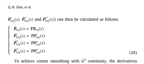

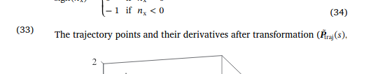

@Fabian,
Thanks for writing me. Mabye you could help us?
The frego paper i tried to read it tonight. It brings up several idea's how clothoids where solved in the past.
And then it bring's up a closed form solution.
However i just miss the knowlegde here to understand how it's done.
This paper i would bring under attention, it uses 4 clothoids to generate a clothoid spline fillet in 3d.
The mathematics are quite well documented. And the result pictures look very promising.

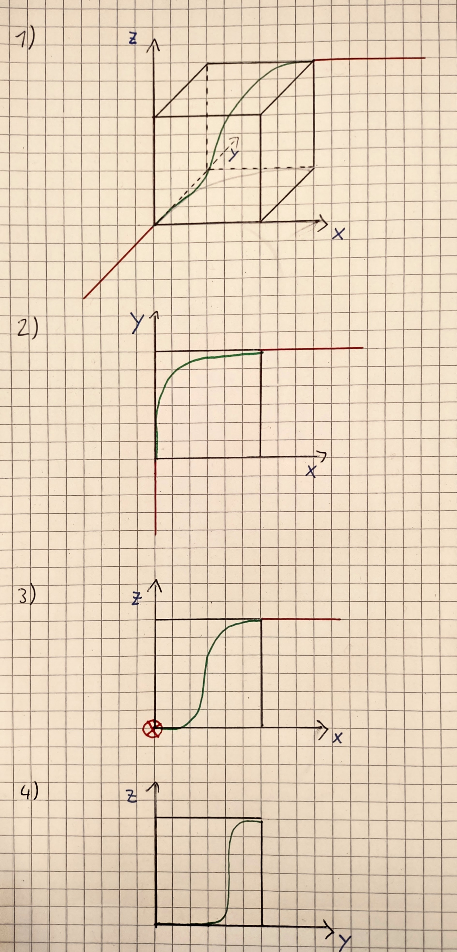

I tried to draw a picture to ilustrate the issue with the 2D clothoids stacked on each other to approximate a 3D clothoid.We want to connect a straight line in y with another line in x. The second one isI tried to draw a picture to ilustrate the issue with the 2D clothoids stacked on each other to approximate a 3D clothoid.We want to connect a straight line in y with another line in x. The second one is also shifted up in z. The 1) picture shows a 3D drawing of the situation. Pictures 2) and 3) show the xy and xz planes respectively with how the 2D clothoids would look like respectively.
The 2 clothoids look fine by themself, the one in xy is also close to the correct one I guess. The issue is with the second one in xz. The clothoid optimizes curvature in this xz projection so you get linear increasing and decreasing curvature relative to arc length in this projection but not linear in total 3D arc length. In this example the difference is quite extreme because the curve is initially moving mainly in y and not in x. So the resulting curve does not behave as expected. Picture 4) shows the resulting curve in the yz plane, the tool is barely moving in z for quite some time (because the machine is mostly using in y and this direction got ignored for the clothoid calculation. Then it suddenly needs to move quite a lot in z and jerk is much higher than expected from the xz clothoid.
I hope I managed to explain this, it’s kind of hard to visualize 3D clothoids.
So in summary this approach leads to a smooth curve with fitting curvatures at the ends but in between the change in curvature and torsion is not linear and jerk might be higher than expected. The resulting connection curve also dependens on the orientation in the coordinate system. If the example was rotated for example by 45° the resulting clothoids would look differntly. This is of course kind of unintuitive.
So it does work to some extend but is not the best solution and there might be more extreme edge cases where this might go wrong.

@Fabian,
Thank you for nice illustration. This indeed will not work.
Good you have seen the Frego paper is not suitable for our work!
For the new paper, i managed to code Equatation 39.
However Equatation 40, i dont understand the first greek character, and the name of this character.

The greek letter is 'kappa' and stands for curvatureHowever Equatation 40, i dont understand the first greek character, and the name of this character.
