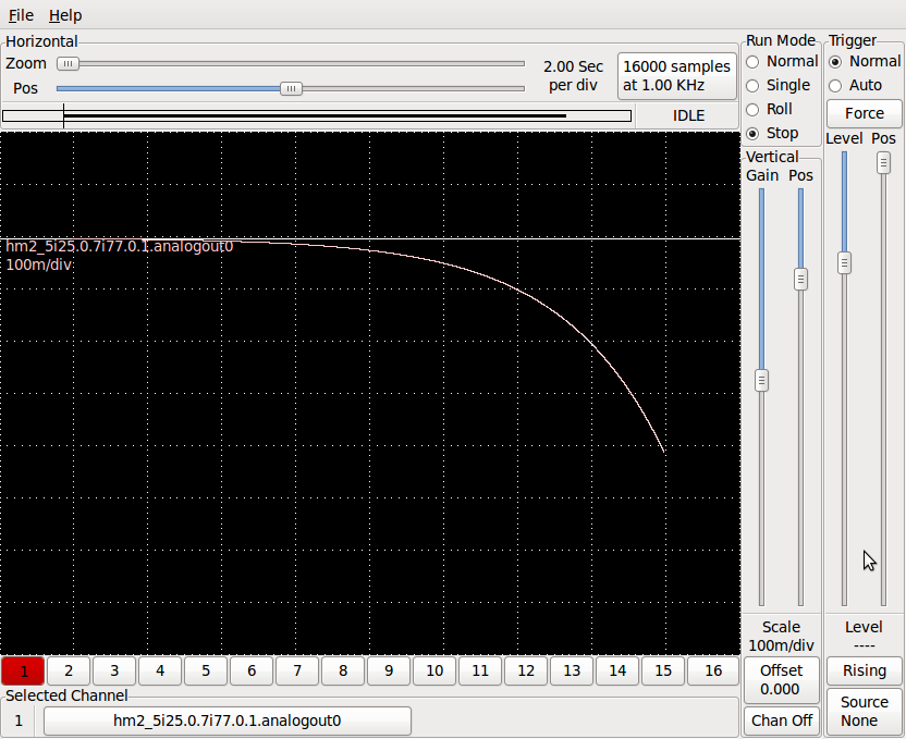

I'm back again with a couple more questions -
I've set up my spindle control and it seems to run correctly from AXIS after a little massaging of the scaling numbers (it appears that the analog input of my VFD wants a max voltage of 1.5 to get 60 Hz which for some reason works with a scale of about 6.4 - however I'm not sure what AXIS' default spindle speed is supposed to be when you leave spindle at 100% and press the CW rotation button). When I tell it to run in reverse, it correctly sets the spindle CCW pin but the PWM pin output stays at 0. I've seen this discussed here www.linuxcnc.org/index.php/english/compo...57&catid=38&start=18 with a workaround but I see at the end of the thread that you updated PNCConf (or was it stepConf?) to fix it. I wanted to see whether I should proceed with the workaround or if there's a cleaner way of fixing this behavior.
I'm also having trouble getting my servomotors to run in AXIS. I'm able to run them in the open loop test dialog in PNCConf but whenever I try to jog them in AXIS I get no motion whatsoever and a following error. The ".. Amplifier Enable" pins, which I have connected to X/Y/Z-release relays on my end, are not being activated when I try to jog in AXIS like they are in the open loop test. Now the complication is that there must be some intricacy of my Bridgeport control circuitry/servo amplifiers because if I jumper a logic high signal to a release relay, I hear a progressively louder buzzing noise for about 2 seconds until the main contactor trips out completely. This is pretty bizarre. I can't find any differences between what is on and off when I successfully run the open loop test and when I try to jog in AXIS except the release relay drive signal being low. I would appreciate suggestions on this issue but the question I imagine is more answerable is "Why aren't the X Amplifier Enable.. etc pins being activated when I jog in AXIS?"
I also would like to figure out how to get my multi-axis MPG encoder to work. I don't think it does at the moment despite being set up in PNCConf; I don't see any activity when I rotate it but maybe I need to press a button in AXIS to get it to run. Getting the linear axes running is the more important issue at this point though.
Any pointers are appreciated.

28 May 2012 14:32 #20459 by PCW
Replied by PCW on topic Re:7i77 testers wanted
A quick observation is that if you get a following error, with a standard (and safe) HAL file, the drive enables will be instantly dropped (this may not be the case in the open loop test).
If you have not tuned the drives this is expected at this point
28 May 2012 16:26 #20460 by PCW
"Now the complication is that there must be some intricacy of my Bridgeport control circuitry/servo amplifiers because if I jumper a logic high signal to a release relay, I hear a progressively louder buzzing noise for about 2 seconds until the main contactor trips out completely. This is pretty bizarre. I can't find any differences between what is on and off when I successfully run the open loop test and when I try to jog in AXIS except the release relay drive signal being low."
This sounds like the closed loop gain is too high. That is when you run a real test (not open loop) your servos are oscillating. If the drive enables are controlled by LinuxCNC the drives will be disabled as soon as you get a joint following error
I would set your PID parameters to something really low to start (say 1 for P and 0 for I,D,FF1,FF2), and as Andy suggested increase your following error limits so it does not immediately fault when the drives are enabled
28 May 2012 18:22 #20462 by maxvdh
Replied by maxvdh on topic Re:7i77 testers wanted
Thanks for all the responses. I'll try to address everything that's been mentioned.

28 May 2012 18:42 - 28 May 2012 18:44 #20464 by maxvdh
This seems likely. I've been using FERROR=5 and MIN_FERROR=0.5 to allow myself some leeway. I cranked the gains down to where you suggested and when I manually activate the X release relay I don't get oscillation but I seem to get positive feedback. Monitoring the analog output signal to the X servo amplifier, I see an initial voltage of about 1e-14V. As soon as I activate the servo amplifier, that voltage slowly climbs to ~-0.5V at which point I get a joint 0 following error. I attached a picture of HAL scope monitoring this behavior. I wasn't able to capture the whole event in one pass but I got a joint error right after the period you can see here.
Perhaps that means that I have either an encoder or servo drive signal inverted. I set them correctly in the open loop test in PNCConf but I know that doesn't necessarily mean that they're being handled correctly now.

28 May 2012 18:48 - 28 May 2012 18:58 #20465 by PCW
A few observations:
1. Why are you not using the drive enable outputs of the 7I77? That is their intended purpose. They have the advantage that they are "floating" switches so can be used with active high and active low enables. They have the additional advantage that they can use a separate supply so you can use them with enable inputs that have a different voltage requirement than the field I/O (which is normally 12 or 24VDC)
2. HM2 encoder "Counter mode" which is an up/down count mode
as opposed to the normal reversable quadrature mode is not suitable
for MPGs so this should be set false
