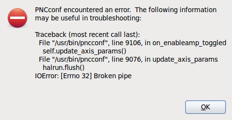

26 Apr 2012 04:00 #19539
by maxvdh
Replied by maxvdh on topic Re:7i77 testers wanted
I'm back and I went ahead and tried the open loop test again immediately as soon as I got back here. With 12V field power applied to the 7i77, I got no errors in the open loop test dialog. However, I got no voltage out of any of the pwm outputs when I pressed the plus/minus jog buttons. I fooled around with some other things and permanently wired the field power to 24VDC. I ran PNCConf again and found that I get the error again when I press the axis enable button. Attached is a screen cap of that error. I then updated LinuxCNC to get your new updates but I found that I still get the same error when I press the axis enable button in the open loop test dialog. I'm not sure what changed that caused me to get the error. I get a "following error" when I try to use the jog button in axis.

27 Apr 2012 00:44 #19571
Replied by cmorley on topic Re:7i77 testers wanted
thank you for the report.
If you run PNCconf from a terminal it will give more specific messages to why this happens.
probably a HAL name spelled wrong

28 Apr 2012 04:25 - 28 Apr 2012 04:28 #19602
by maxvdh
Yeah looks like it's a different version of the same problem -
XML 7i77 TXData3 SMARTSERIAL-P2-TX
XML 7i77 RXData3 SMARTSERIAL-P2-RX
XML 7i77 TXData2 7i77 sserial #2
XML 7i77 RXData2 SMARTSERIAL-P1-RX
XML 7i77 TXData1 7i77 sserial #1
XML 7i77 RXData1 SMARTSERIAL-P0-RX
XML 7i77 TXData6 SMARTSERIAL-P5-TX
XML 7i77 RXData6 SMARTSERIAL-P5-RX
XML 7i77 TXData5 7i77 sserial #5
XML 7i77 RXData5 SMARTSERIAL-P4-RX
XML 7i77 TXData4 7i77 sserial #4
XML 7i77 RXData4 SMARTSERIAL-P3-RX
hm2_5i25.0.encoder.03
<stdin>:12: Pin 'hm2_5i25.0.7i77.0.1..analogena' does not exist
insmod: error inserting '/usr/realtime-2.6.32-122-rtai/modules/linuxcnc/scope_rt.ko': -1 Unknown symbol in module
<commandline>:0: exit value: 1
<commandline>:0: insmod failed, returned -1
See the output of 'dmesg' for more information.
loadrt scope_rt failed
two periods on the analogena pin?.. Perhaps not. I don't know what's screwed up here.
