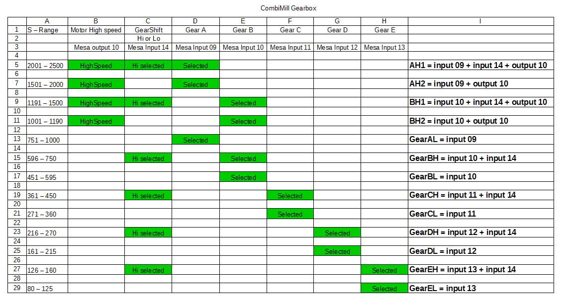

OK missed case numbering
Always 50Hz = no
Say I want S800
Select Motorspeed LO
Select GearShift LO
Select Gear A ===> 50Hz on that setting will give 1000rpm spindle output and via VFD regulated down to commanded 800rpm
So VFD only regulates all gear settings max/min range === this will give me (more or less) max torque on all gear settings.

28 Aug 2018 14:37 #116735
Replied by andypugh on topic Help needed to get my 7i76E + 7i85S + 7i73 on my mill going.
I don't understand how BH and B are different input pins.
Why would you check for high-gear if you are already in AH?
is high_gear an input from the motor speed switch or from the gear ratio switch?

28 Aug 2018 14:47 #116737
by tecno
Replied by tecno on topic Help needed to get my 7i76E + 7i85S + 7i73 on my mill going.
forum.linuxcnc.org/39-pncconf/33069-help...ing?start=560#116477
Have a closer look at my table that explains all gear settings.
BH = Motor at High Speed and Gear B
B = Gear B
B = Gear B

28 Aug 2018 16:49 #116742
And how is that two separate HAL pins?
B = Gear B

29 Aug 2018 02:29 - 29 Aug 2018 02:30 #116764
by tecno
I see your point Andy, here a new sheet with new pin names that I hope will work OK.

29 Aug 2018 09:54 - 29 Aug 2018 09:57 #116774
So, 13 valid gears.
It probably makes some sense to have overlap between gears. CL and DH are probably about as good as each other at 275 rpm
I think it would be better to _sense_ the position of the motor speed switch than to actively drive the relay. That way the VFD will not be powered up while the speed is changing-over. The VFD would most probably be damaged by that.
This adds an extra output that can be used with the message HAL component to say which gear should be selected. (using bitslice to convert the int to individual bits)
