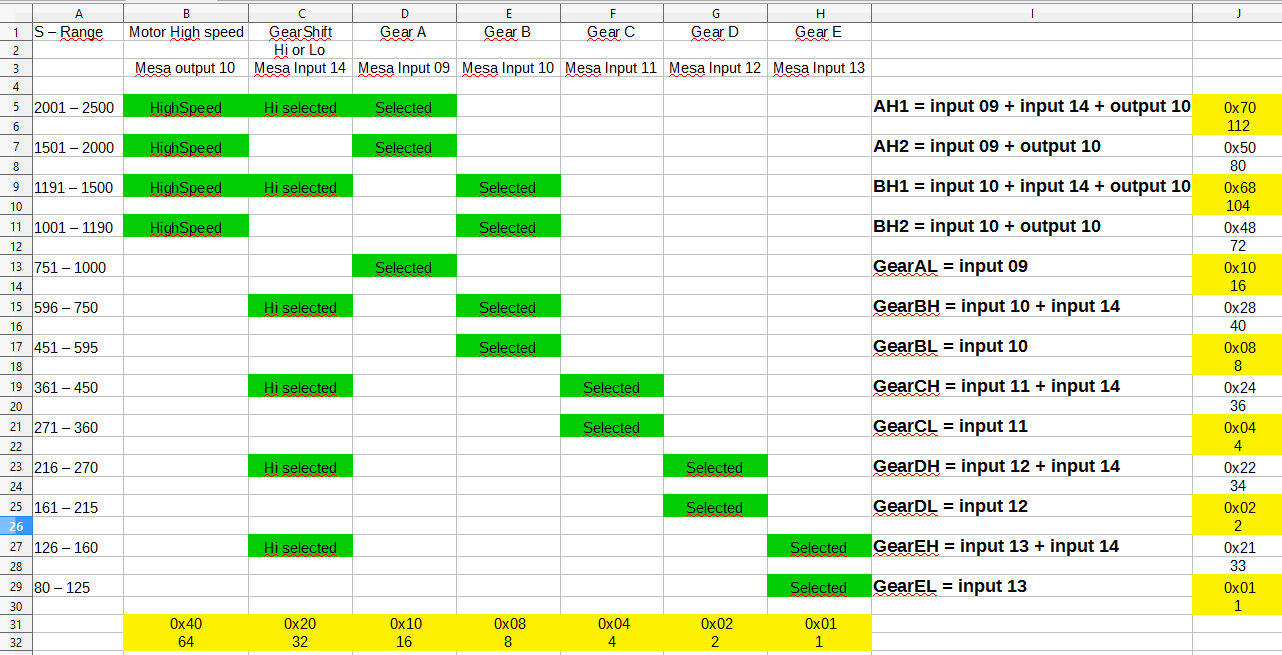

31 Aug 2018 05:32 #116905
by tecno
Replied by tecno on topic Help needed to get my 7i76E + 7i85S + 7i73 on my mill going.

02 Sep 2018 04:48 #116970
by tecno
Is this way to setup SETP OK?
setp GB_2speed.0.min1 80
setp GB_2speed.0.max1 125
setp GB_2speed.0.min33 126
setp GB_2speed.0.max33 160
setp GB_2speed.0.min2 161
setp GB_2speed.0.max2 215
setp GB_2speed.0.min34 216
setp GB_2speed.0.max34 270
setp GB_2speed.0.min4 271
setp GB_2speed.0.max4 360
setp GB_2speed.0.min36 361
setp GB_2speed.0.max36 450
setp GB_2speed.0.min8 451
setp GB_2speed.0.max8 595
setp GB_2speed.0.min40 596
setp GB_2speed.0.max40 750
setp GB_2speed.0.min16 751
setp GB_2speed.0.max16 1000
setp GB_2speed.0.min72 1001
setp GB_2speed.0.max72 1190
setp GB_2speed.0.min104 1191
setp GB_2speed.0.max104 1500
setp GB_2speed.0.min80 1501
setp GB_2speed.0.max80 2000
setp GB_2speed.0.min112 2001
setp GB_2speed.0.max112 2500Please Log in or Create an account to join the conversation.
