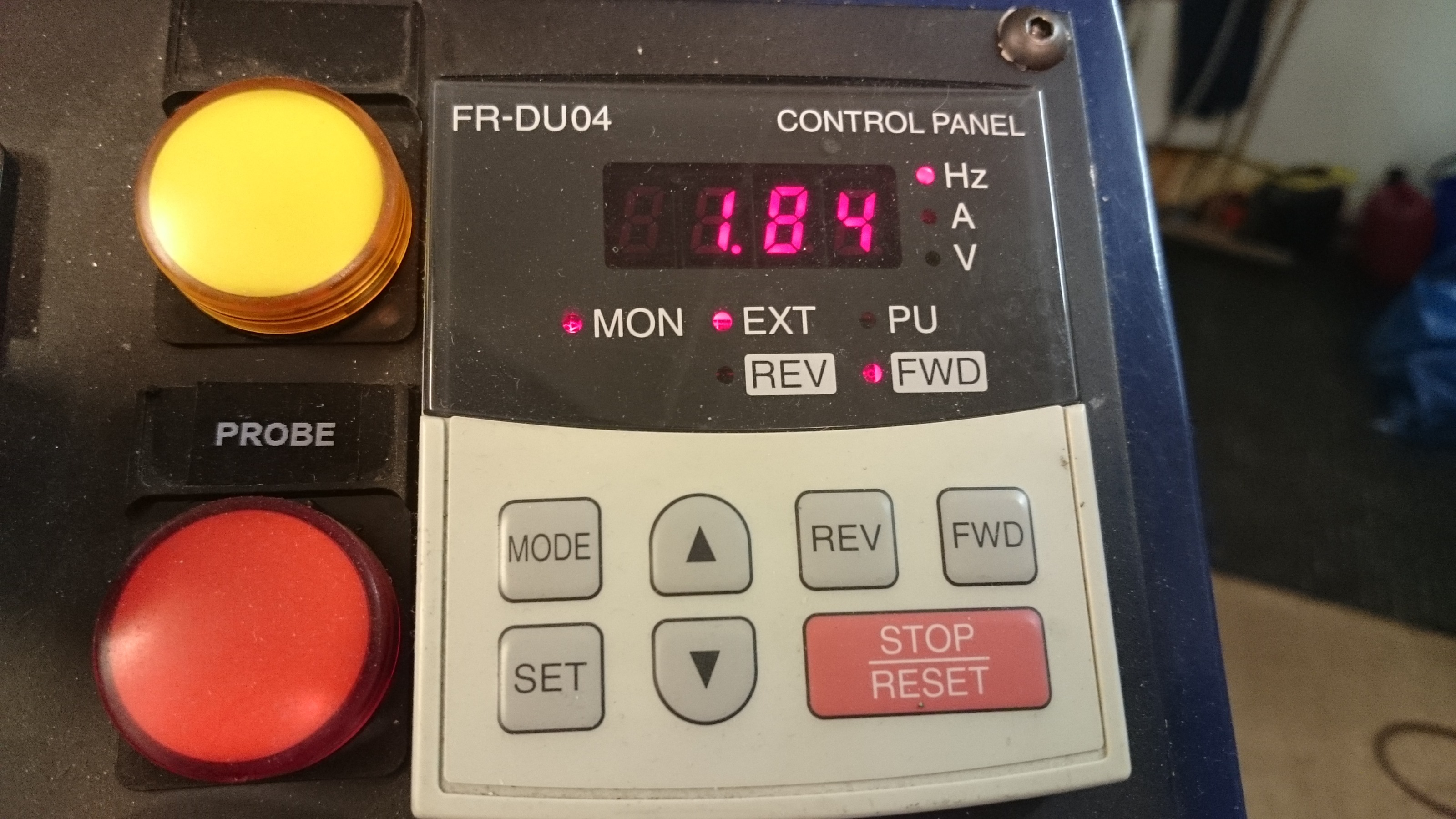

06 Sep 2018 06:07 #117143
by tecno
Replied by tecno on topic Help needed to get my 7i76E + 7i85S + 7i73 on my mill going.
- tecno
- Posts: 1850
- Thank you received: 127
06 Sep 2018 06:36 #117144
by tecno
Assuming ratio's to be separated motor at HighSpeed
