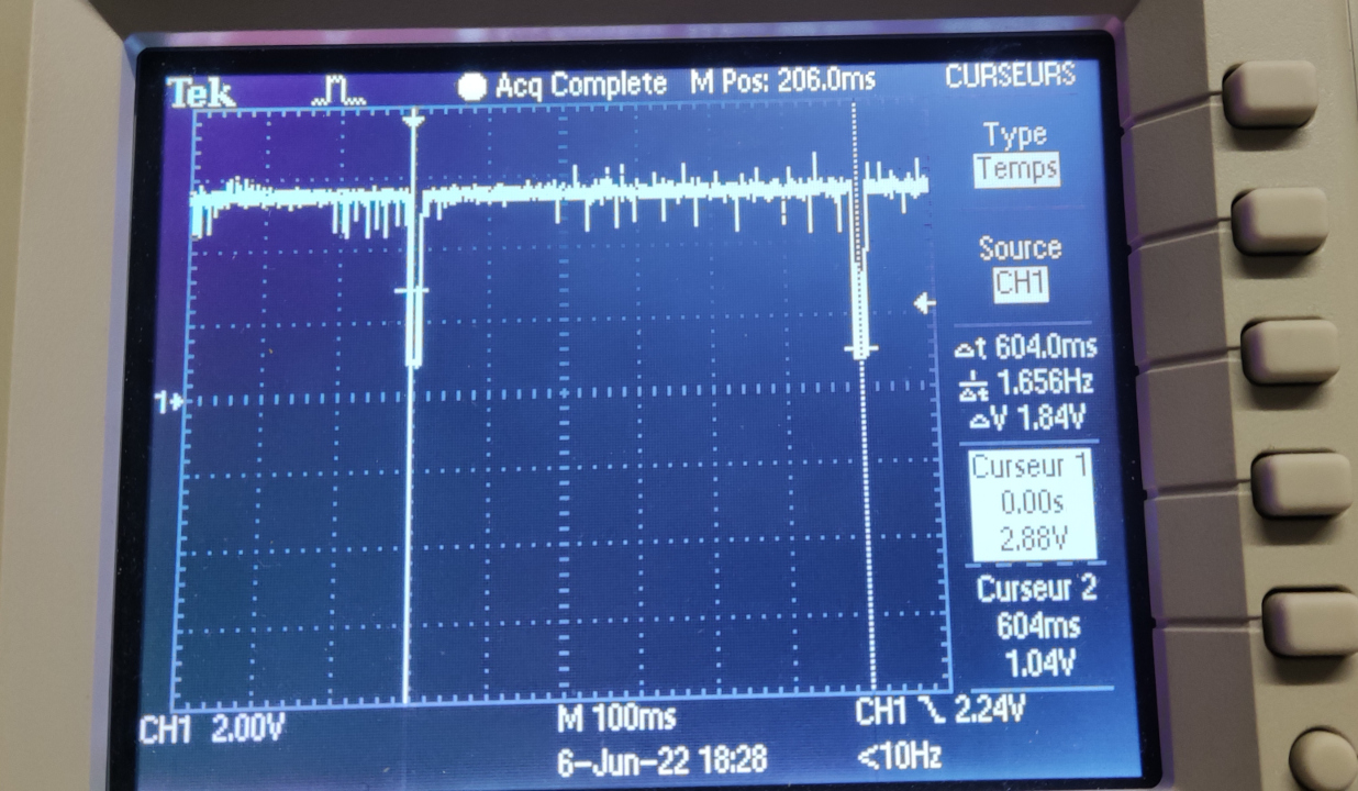

10 Jun 2022 06:47 - 10 Jun 2022 07:56 #244849
by looping
Replied by looping on topic Parport to 7i92

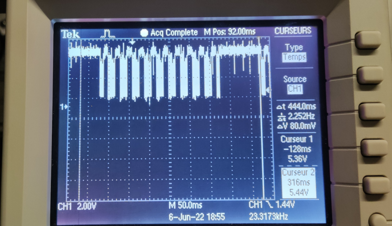

In t500-hotbus/rs485-wiring-guide.pdf from the link above I discover the requirement for wiring.
My wire is about 1m long, shielded, not twisted from my scrap box. It's not 120 ohms impedance. During my previous tests, I replaced it with a thicker one, add termination resistor, add and removed the GND link with no better result. I need to find a 120 ohms to be sure.
From the oscilloscope, it seems hy_vfd it trying to read ACV from the VFD every 600ms when no response: see HY_22Kw.jpg. The debug file shows that hy_vfd is picking up the noise as a response.
See HY_15Kw.jpg when my other HY is responding. Much more traffic.

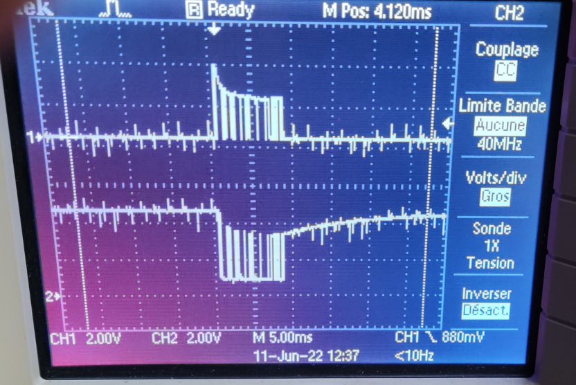

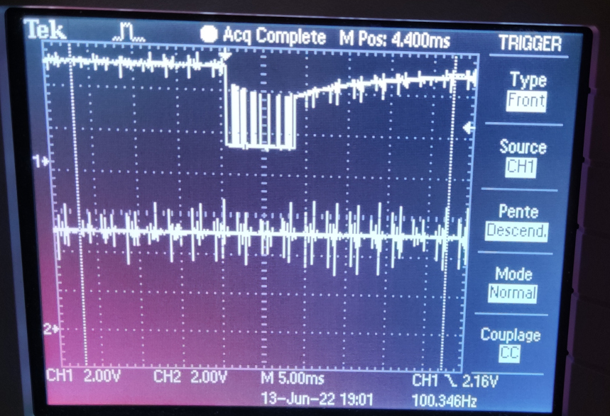

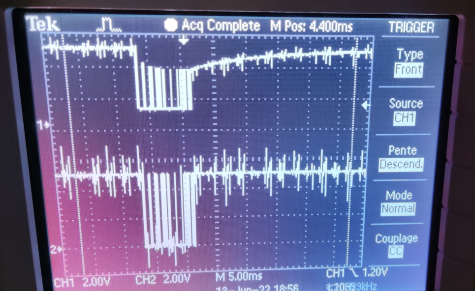

Put your B probe on the bar TX line. Look at "A" TX and "B" bar TX to see transmitted noise.
- looping
- Posts: 91
- Thank you received: 10
12 Jun 2022 12:31 #244991
by looping
Here is A and B

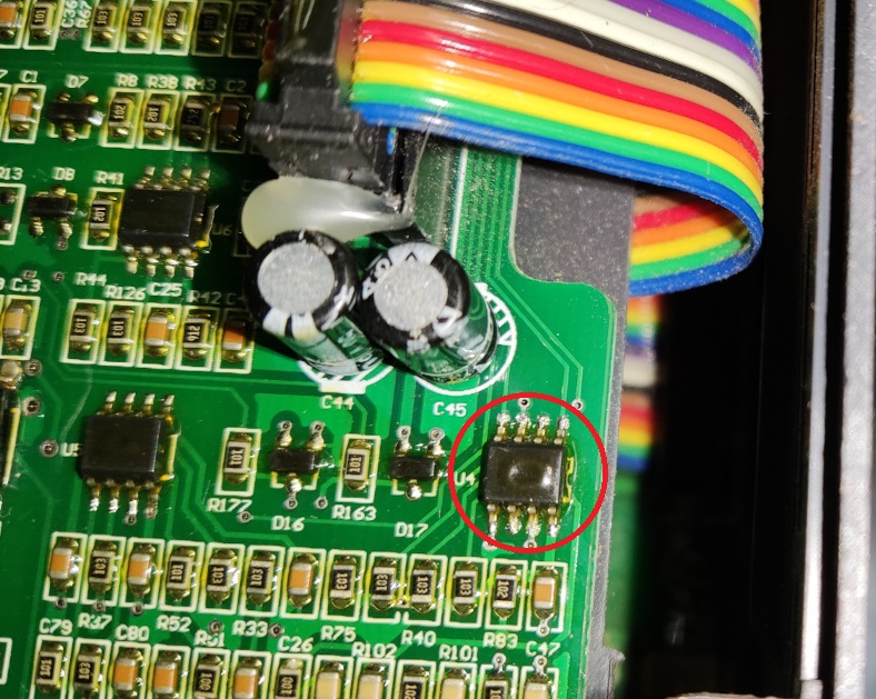

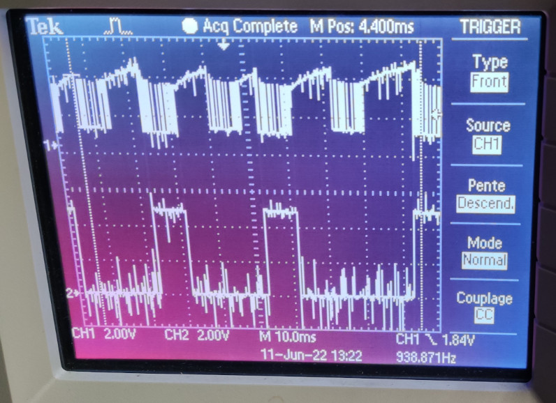

On the PCB, I located the rs845 transceiver chip : U4
Many rs485 transceiver have the same pinout as this one thvd8010.
Assuming this, it seems the query from the computer seems to be correctly decoded on the pin #1 : R (I didn't trace it yet, up to the MCU).
But I have level changes on pin #2 (Receiver enable, active low) neither on pin #3 (Driver enable, active high) or pin #4 (Driver data input)

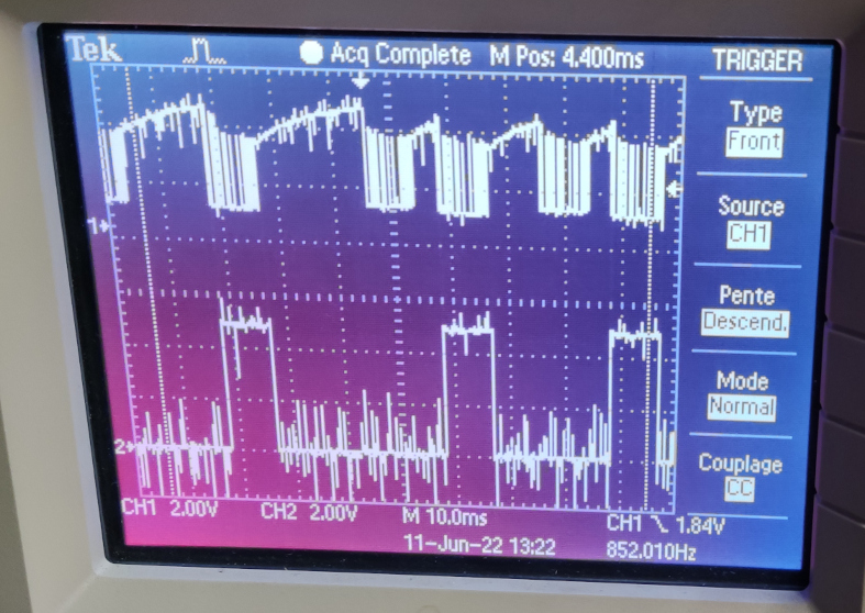

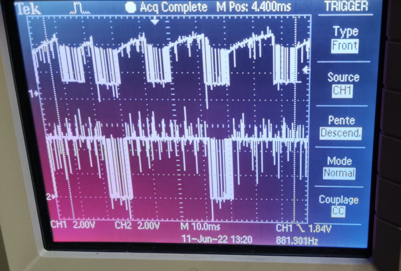

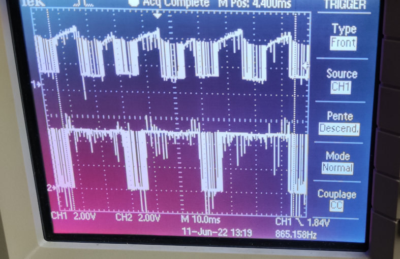

12 Jun 2022 13:34 #244994
by looping
Here are the signals on the 1.5kw for pins 1 to 4.

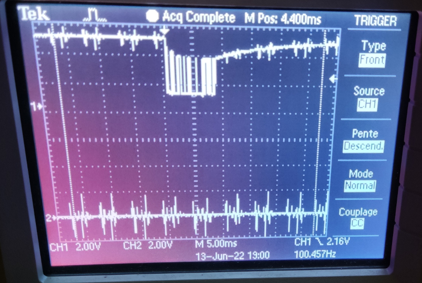

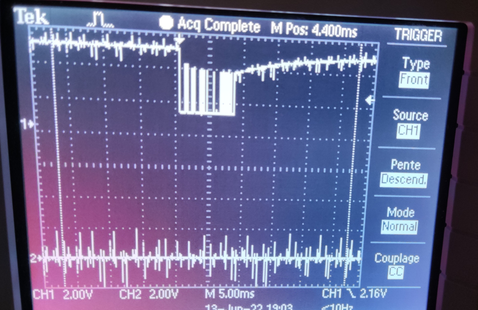

13 Jun 2022 20:28 - 13 Jun 2022 20:28 #245086
by looping
Here are the signals on the 2.2kw
DE signal (Driver enable, active high) remain low. Does it mean that the rs485 is not enabled !?
PS:
On June 5, I wrote thant I could execute some command on the VFD using SpindleTalker2. Today I couldn't succeed starting the spindle niether had a single response fron it. (I'm still using the shielded wire from my scrap box)
PS:

13 Jun 2022 21:02 #245088
by scotth
Replied by scotth on topic Parport to 7i92
Try A channel on RS+ and B channel on RS- .
Lower right-hand side of control terminals.
They should mirror, and anything else is noise and should be rejected.
