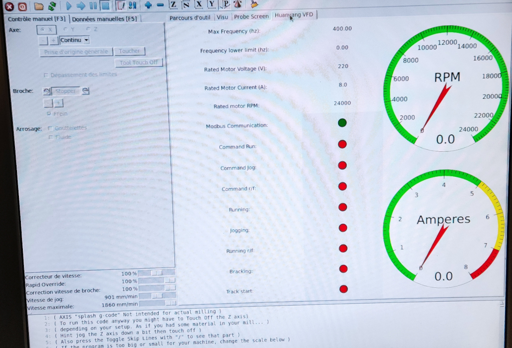

After a very long pause, I got back to my troubleshooting.
I desolder the rs485 chip from the cpu board of the VFD and put a max485 from Maxim. And it is now working like a charm !!!
With or without GND , with the USB adapter and with the RS232!

I put every back to my workshop and reconnect the 2.2kw spindle, limit switches and so ...Fire linuxcnc. gladevcp panel shows the proper parameters and Modus communication is now green
But after homing, I can't start the spindle using AXIS spindle control buttons. Neither with MDI command M3 S10000
The VFD debug file shows no error.(see attached file).
I quickly changed the VFD to select the control mode (PD001 and PD002 ) to "front panel" and every this is fine: the RUN button starts the spindle, the potentiometer adjust the speed and STOP ... stop.
It's been a long time since I worked on this so I must be missing something obious but I can't figure out what

The first step would be to make sure that the correct veluaes arebeing sent to the spindle control HAL component. i.e. rather downstream of what you already posted.

I had messed up my spindle hal file, I guess during all the tests I did.
Now it's fixed and all is running
Many thanks for your help
