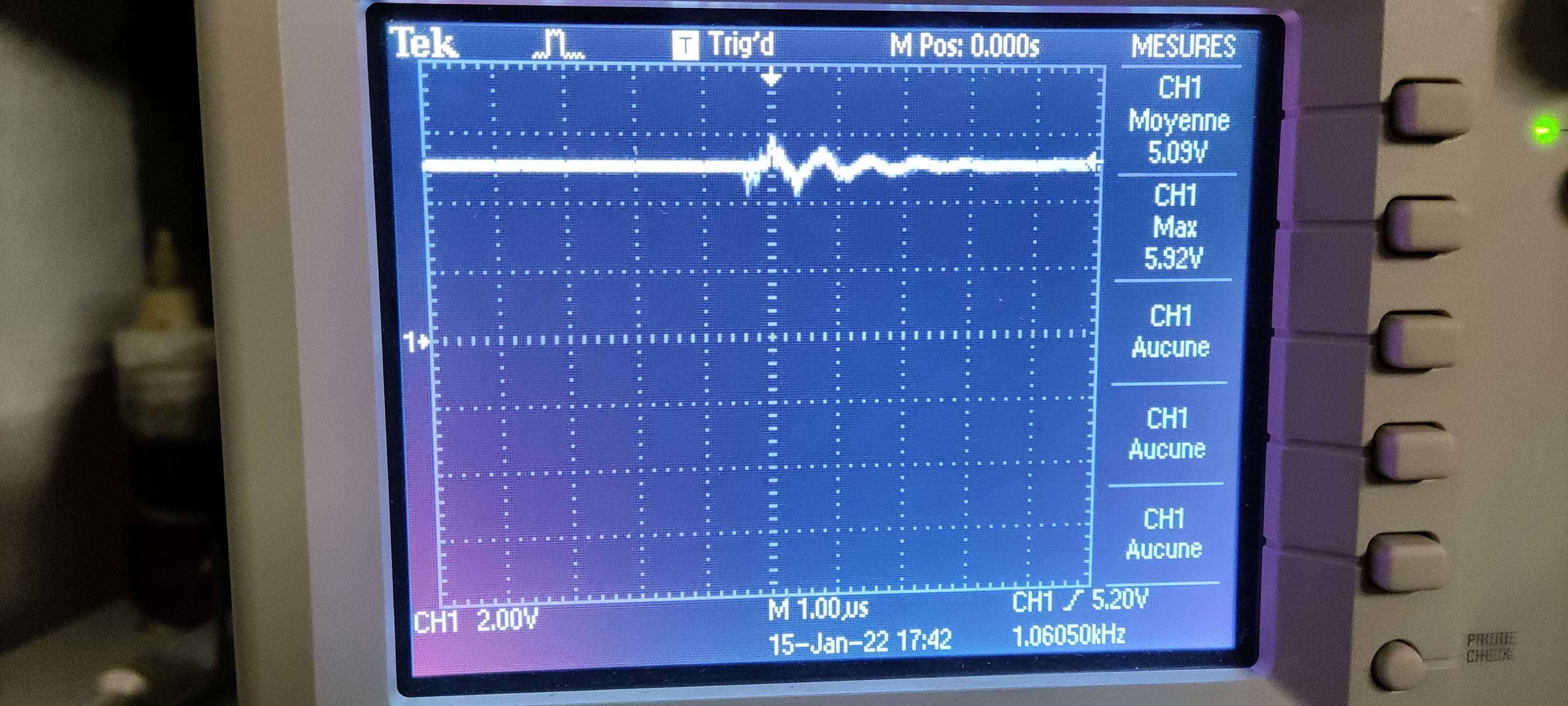

Shut down everything!
Find a power cable for the PC WITH and ground pin, this is a must.
-move spindle cables as far from 7i92 as possible
-use very short cabling on the 7i92 headers
-do not use a parallel cable from 7i92 to BOB if you have the M version, just plug the 7i92M to the BOB
-use a grounded cable for the spindle drive and the spindle, also not negotiable !
The 9V peak-to-peak on the 5V supply is bad, very bad.

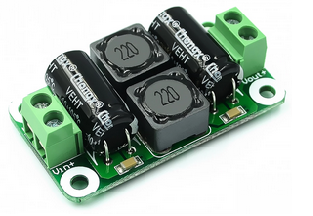

Yes as soon as I saw the scope I turned off everything.The VFD and the 40V power supply are grounded.The PC is powered with a laptop 19V adaptor + a PicoPSU, so I'm not shure how to do this.
But I ordered a those filters for the 5V to the 7i92 and for the VFD.

Hello
I installed the 2 above filters and some ferrite as describe here
Now it's much better.
Thanks for your help

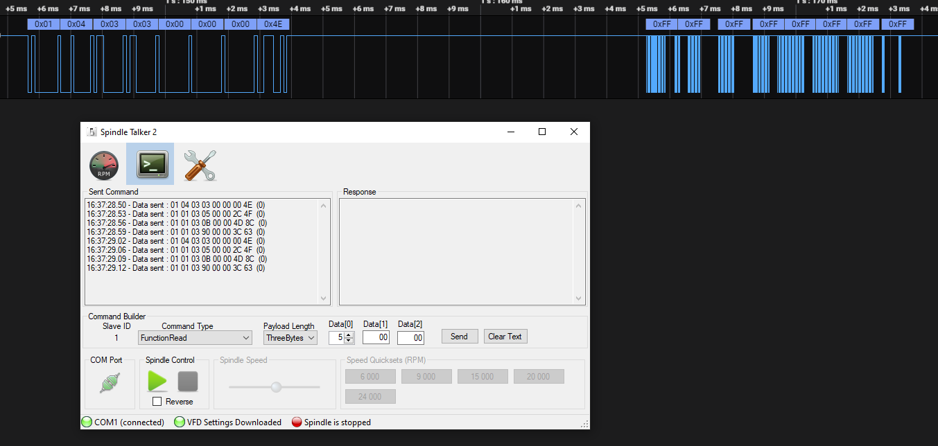

I downloaded and installed SpindleTalker2 on windows... ans I CAN control the VFD !!!
So the RS485 VFD is not broken

The 2.2Kw is receiving commands, but responds it sends are gardbage
- Posts: 21958
- Thank you received: 7478
05 Jun 2022 14:47 #244619
Replied by tommylight on topic Parport to 7i92
Check the spindle talker how many data bits, stop bits and parity bits, then set the same on the Linux machine.

AS you can see in the log files:
spindle-vfd: device='/dev/ttyS0', baud=9600, bits=8, parity='none', stopbits=1, address=1, debug=1, PID=6030
and in the VFD:
PD164 = 1 (baud rate 9600 bps)
PD165 = 3 (8N1 for RTU mode)
The commands are understood and executed : I can make it run with by Spindle Taker 2. This validates the comms parameters on the VFD side.
But hy_vfd loops on his first read query as it gets an invalid response: only sending
hycomm query = [01][01][03][05][00][00][2C][4F]
to get the ACV from the inverter
and in the VFD:
