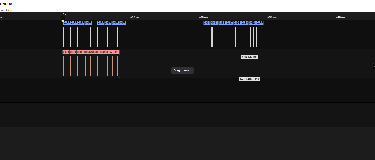

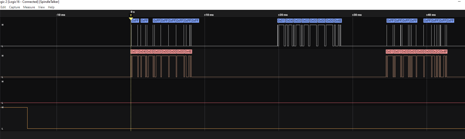

Booting on Win10, with SpindleTalker2 I have everything working well : Com1, 8 bits, 9600bds, 1 stop, no parity
Logic analyser capture on Rs232 pins Rx, Tx, Dtr Rts (see:SpindleTalker2.png)
Reboot on Linux

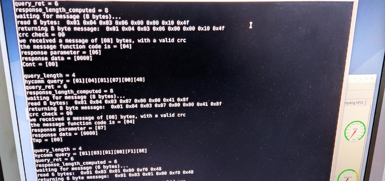

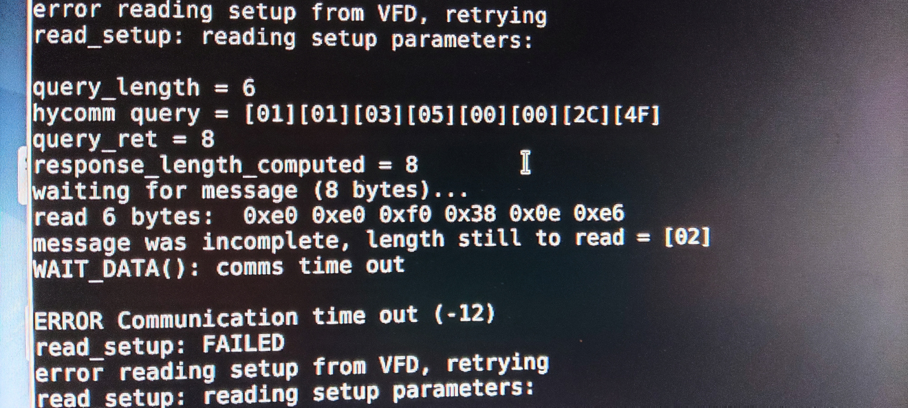

loadusr -W hy_vfd -d /dev/ttyS0 -r 9600 -b8 -pnone -s1 -t1 --debug
setp hy_vfd.enable 1
Comms error (see IMG_20220704_232136.jpg)
But the LinuxCnc and the analyser agree on Tx data :0x01 0x01 0x03 0x05 0x00 0x00 0x2C 0x4F
But on Rx they don't display the same data
The analyser sees 8 bytes incomming, no framing error.( LinuxCnc.png ) The same query occurs every 600ms and the same response.
LinuxCnc expects 8 bytes, only detects 6 and not the sames values
There's an other difference SpindleTalker and LinuxCnc don't drive Dtr Rts the same way.
