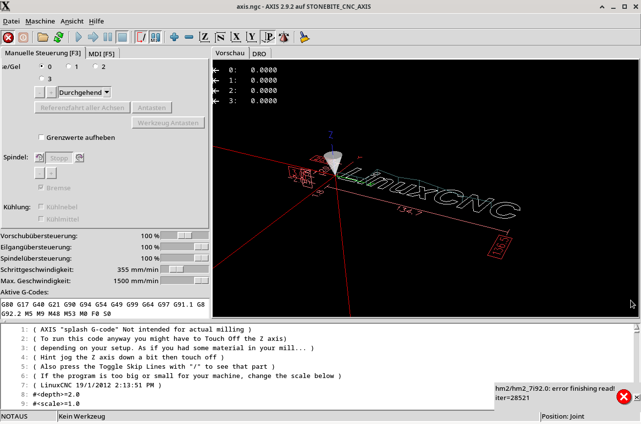

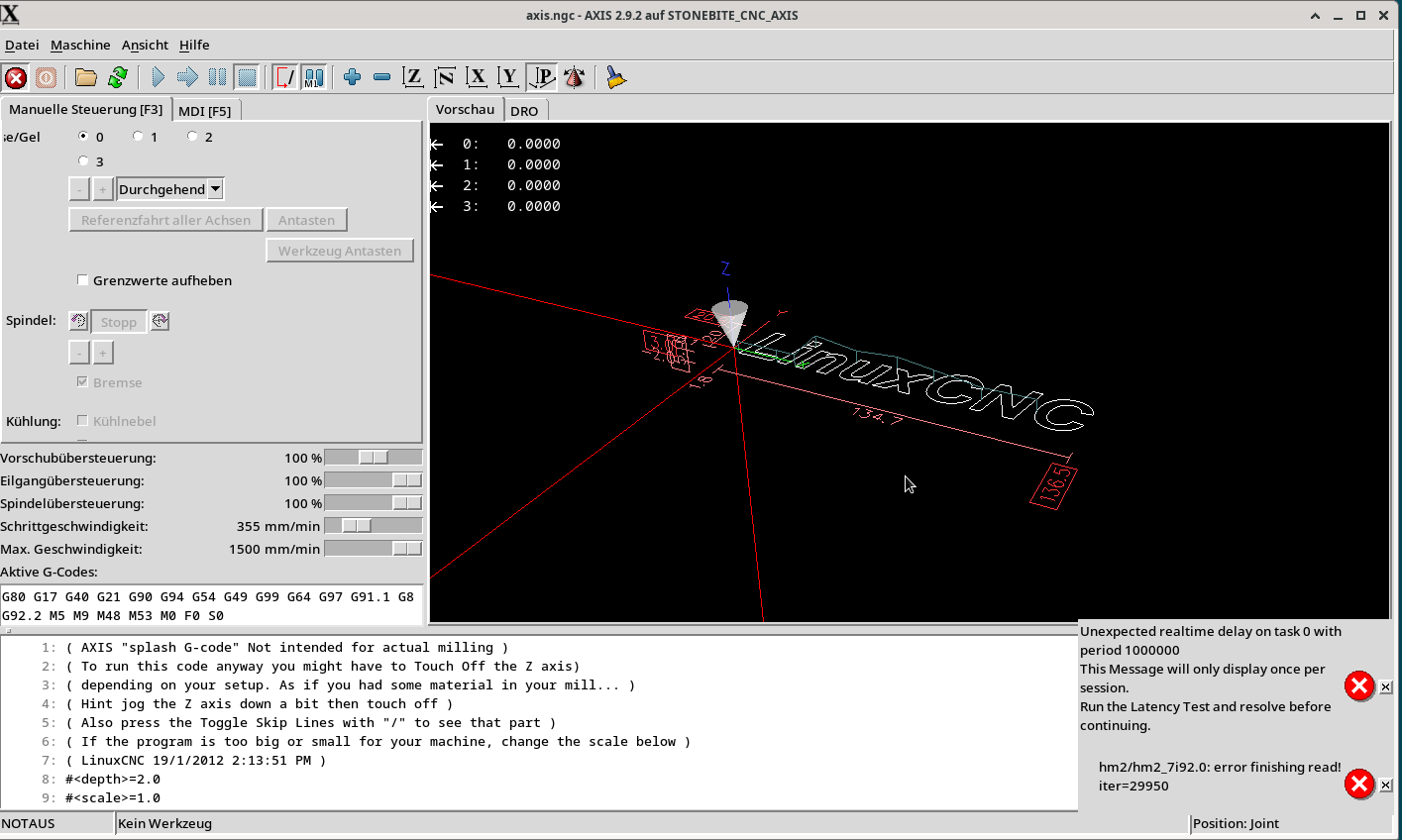

It seems I have a sleeping PC with 13ms when starting and still have two errors after starting the PNCconf machine.
The first error right at start and the second a few seconds later.
With my knowledge, I don't know how I can reduce the 13ms, as explained above with printscreen?
Could you please give me additional help?
Thank you in advance

Replied by tommylight on topic PNCconf 7i92H and 7i76
Close LinuxCNC, start again, does the same thing happen?

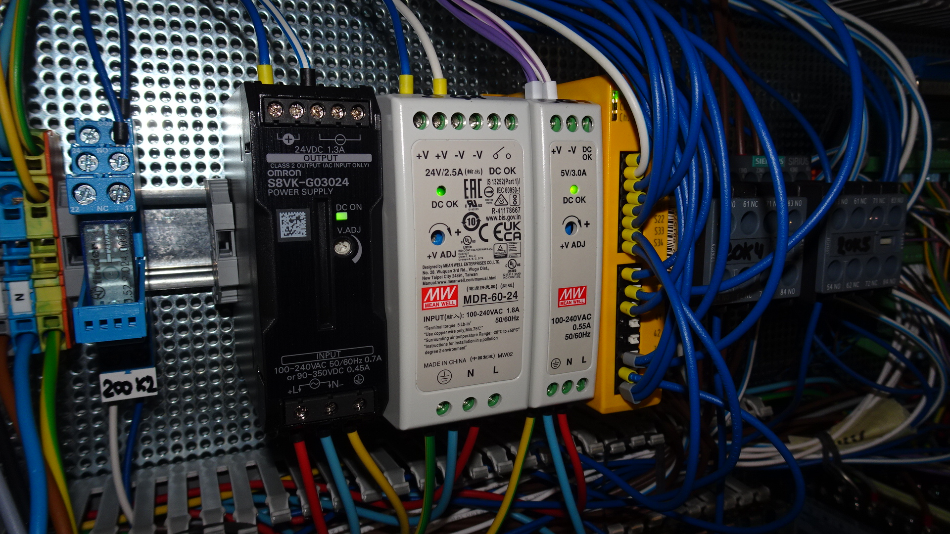

I would change the 5V power supply first, find a good one, preferably MeanWell or Delta or FSP or ... older Samsung mobile chargers, original ones only.

Replied by stonebite on topic PNCconf 7i92H and 7i76
I have a MEANWELL 5V power supply.
The output voltage at the power supply is measured at 5.06V
The input voltage VIN on the 7i92 is measured at 5.03V
The power supply also feeds the power supply of the 7i76 at the same time.
The input voltage VIN (on contacts TB3 21/23 Jumper W2 rigth hand) 7i76 is measured at 5.02V
