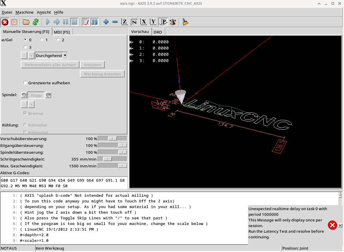

Chronological order of work:
De Lock USB/RJ45 adapter/hub removed
before starting the PC Cable I-Net is disconnected
Direct LAN cable Mesa > PC disconnected
before PC start Cable connection from PC to Mesa is disconnected
De Lock USB/RJ45 adapter/hub inserted between PC and Mesa
5V voltage connector on Mesa 7i92 disconnected, waited 2 minutes
5V voltage plug plugged back into Mesa 7i92
PC started > password query ok > Debian Desktop ok
old LAN I-Net setup deleted at top right
Mesa connection deleted at top right
no more I-Net connection
reconfigure Mesa and PC connection
Ping the Mesa with 10.10.10.10 > ok (see the Terminal printscreen)
Ping the Mesa also with 10.10.10.11 > also ok
try to readout the mesa > not ok > seem to be inpossible? (see the Terminal printscreen)
Start the PncConf File
start the PncConf file > first another error close and start the file again > about 150 minutes no error message
create an I-Net connection via WiFi But immediately afterwards an error message appears? (see second pretscreen)
Questions: I'm surprised that this solution works, since some YouTube channels recommend connecting the PC directly to the Mesa card? But ok if it works safely in CNC milling operations?
why can't I read the Mesa 7i92 now?
the temperatures also look good
What does the next step look like?

cnc@cnc:~$ sudo mesaflash --device 7i92 --addr 10.10.10.10 --readhmid
should work.
As for latency, try setting the servo_period in the ini file to 2000000 (2 million) see if it complains, if not, also edit every entry with P value to 500 (they should be 1000 normally but depend on servo period so must be changed)
Replied by tommylight on topic PNCconf 7i92H and 7i76
Attention to such details must be payed, always, must have two -- in front of addr, you have 1.cnc@cnc:~$ sudo mesaflash --device 7i92 -addr 10.10.10.10 --readhmid
mesaflash: invalid option -- 'a'
So
should work.

Oh, yeah, I see because of the minus sign, I wasn't paying attention, thank you very much ;o)
If I entered it correctly, I can now read out the mesa, perfect!
I changed the value to 2 million, no error message within about 40 minutes
But I'll let the machine run overnight and see if there were any errors tomorrow.
So I didn't have to change the P value.
Could things continue now? thank you very much

I might have not been clear, if no errors with servo period of 2 million, change the P values to 500.
1000
P is for proportional gain in PID loop.
For stepper systems it is always 1sec/servo period in ns, so 1000 for servo period of 1 million, or 500 for servo period of 2 million.

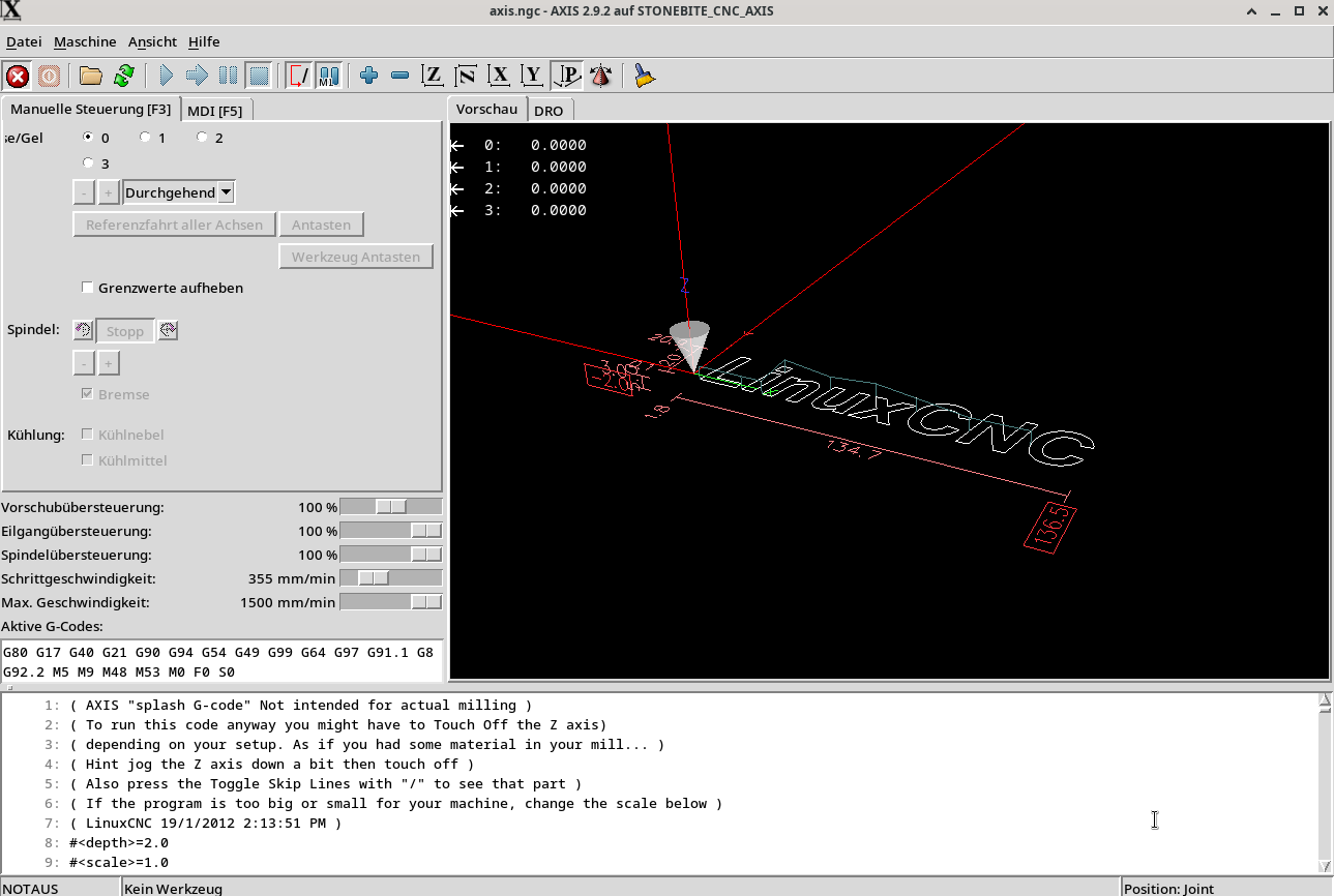

Thank you very much for the explanations.
I'm still a beginner and am grateful for such information.
well, I set the one value P = 1000 to 500 in the INI.
I hope that's what you mean?
if yes, then I started PncConf.
Within 5 minutes of starting the PncConf file I have no errors. ;o)
Yes, that is what i mean.
Good, now on to moving the machine, so do you have the drives and motors wired in? Do some tests, see how things work, make some chips...
