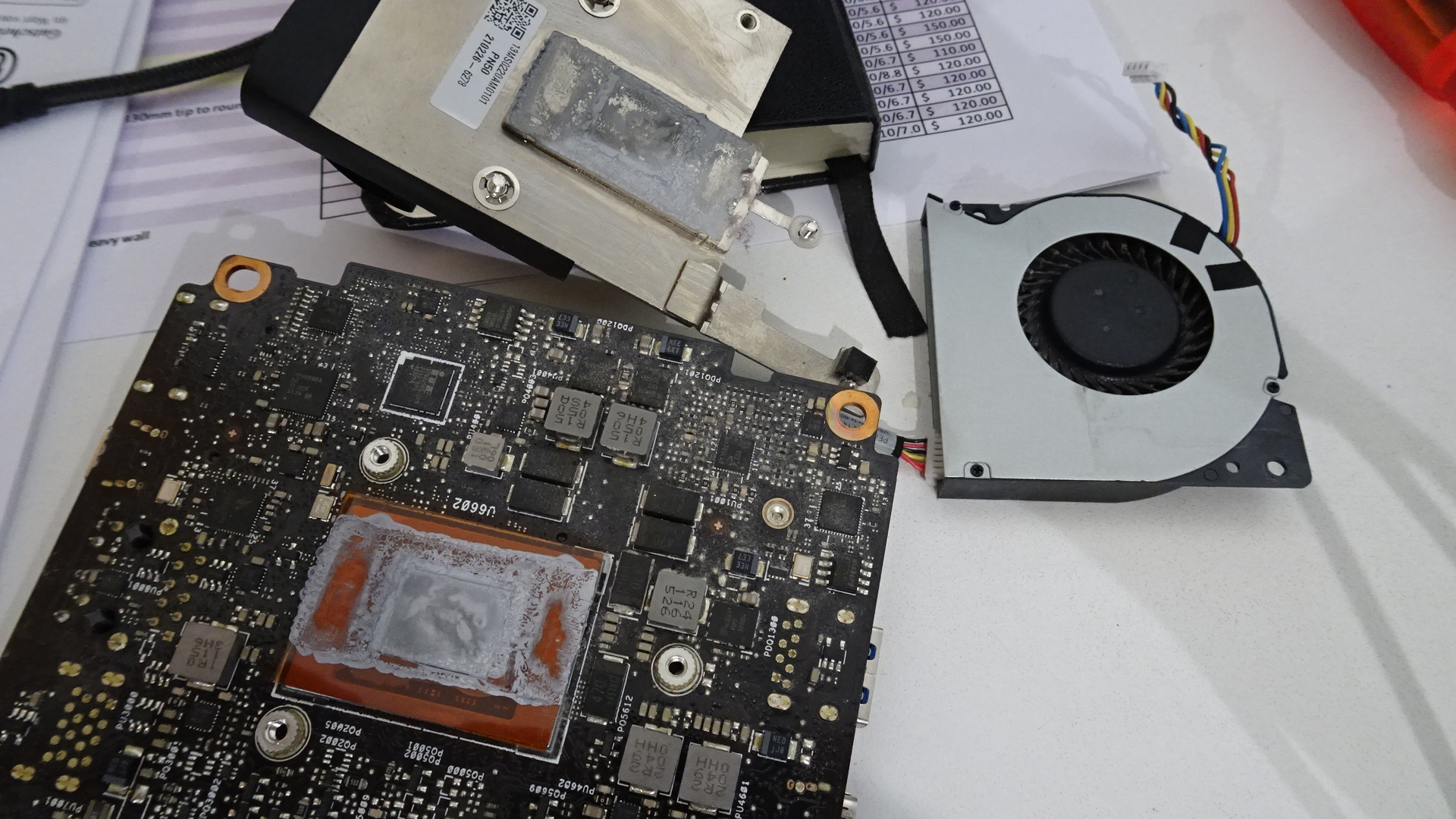

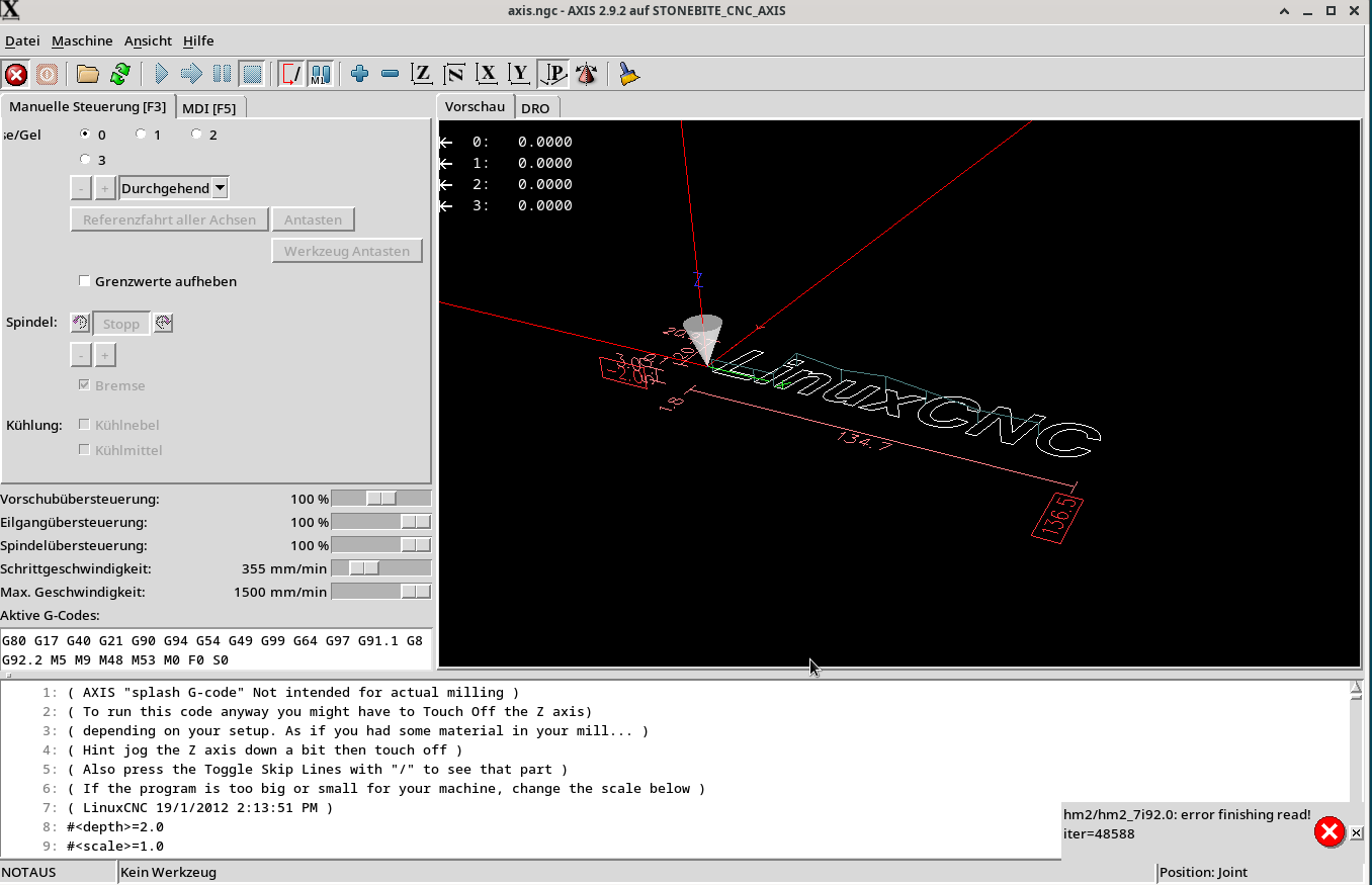

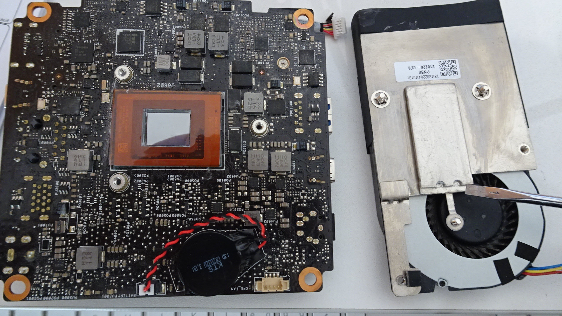

30 Apr 2024 07:53 - 30 Apr 2024 08:54 #299393
by stonebite
Replied by stonebite on topic PNCconf 7i92H and 7i76
Hi Thommy,
back from the PC modification front.
PC completely disassembled and the thermal paste between the processor and cooling element.
Replaced PC case modified so that the air inlet is not or less restrictive and the pseudo centrifugal fan actually blows through the cooling element
PC reassembled (very delicate work)
All components plugged in
Start PC, Debian/LinuxCNC starts, works perfectly.
Open the terminal and query sensor values (see below).
The temperature values at the beginning are promising.
Start Linux CNC with temp. values below 60°C.
The exact same error message still appears.
Leave the PC with LinuxCNC open and continue working.
Temp. values still climb to 92°.
So I think that the temp value around 60° showed that LinuxCNC still gives the error message.
What is fact is that temperatures drop below 50° relatively quickly. It is also a fact that the temperatures rise relatively quickly to 95° when starting linuxCNC.
I would now be more than grateful if I could get some information as to whether I should operate with a different PC?
Are there any other ways to find out where the error comes from?
thanks in advance

- Posts: 22036
- Thank you received: 7504
30 Apr 2024 12:42 #299411
Replied by tommylight on topic PNCconf 7i92H and 7i76
I agree, it is time to look for something else, preferably not micro sized. Those have a lot of power saving stuff so never a good choice for machine control.
CPU heating and cooling quickly is always a sign of cooler not seating properly or scratched cooler/heat spreader so not making good contact.
- stonebite
- Posts: 118
- Thank you received: 10
30 Apr 2024 13:30 - 30 Apr 2024 13:31 #299413
by stonebite
So I thought I described it in such a way that I just improved the contact of the cooling element, replaced the thermal paste and also optimized the PC case? I remembered from the past that AMD processors were always hot-blooded compared to Intel processors.
A:
For me, the question now arises today and immediately about switching to another PC if there are still concerns about normal operational security. Unfortunately I can't estimate it. As already mentioned, I would NEVER buy a PC with an AMD processor again.
If a new PC is preferable, the question arises as to which one.I would prefer a Lenovo ThinkCentre. What is your opinion
B:
I can make another statement. Amazingly, I can now use ONSHAPE again in the Firefox browser without any error messages because of OpenGL. Can that be grasped?
C:
I would still be very interested to know why I installed the LinuxCNC machine with the sample file “Axis” from LinuxCNC can be opened without an error message. And when I open the file created with PncConfig, I get the familiar message.
Shouldn't there be something wrong with this file?
A:
B:
C:
Last edit: 30 Apr 2024 13:31 by stonebite.
- Posts: 22036
30 Apr 2024 18:46 #299430
Included SIM configurations do not care about latency, i have never seen a sim complaining about it.
You have ... had two issues, latency and dropping the link, i did not see latency errors on your latest screenshot, so that is good, but the link keeps dropping, meaning something is causing a huge delay in communication with the network card.
Do you by any chance have a USB to ETH adapter to test with?
Yes you did, apparently it did not improve to the point of being useful.So I thought I described it in such a way that I just improved the contact of the cooling element, replaced the thermal paste and also optimized the PC case?
True, that was the case for a long time.I remembered from the past that AMD processors were always hot-blooded compared to Intel processors.
I will never buy an Intel processor until they stop their cr@ppy lies.I would NEVER buy a PC with an AMD processor again.
I still have a M93 i think that is the model, for probably 6 years in use, never failsIf a new PC is preferable, the question arises as to which one.I would prefer a Lenovo ThinkCentre. What is your opinion
Yes, the graphic are in the processor, so less heat = no issuesI can make another statement. Amazingly, I can now use ONSHAPE again in the Firefox browser without any error messages because of OpenGL. Can that be grasped?
Only if you change the servo period.I would still be very interested to know why I installed the LinuxCNC machine with the sample file “Axis” from LinuxCNC can be opened without an error message. And when I open the file created with PncConfig, I get the familiar message.
The following user(s) said Thank You: stonebite
