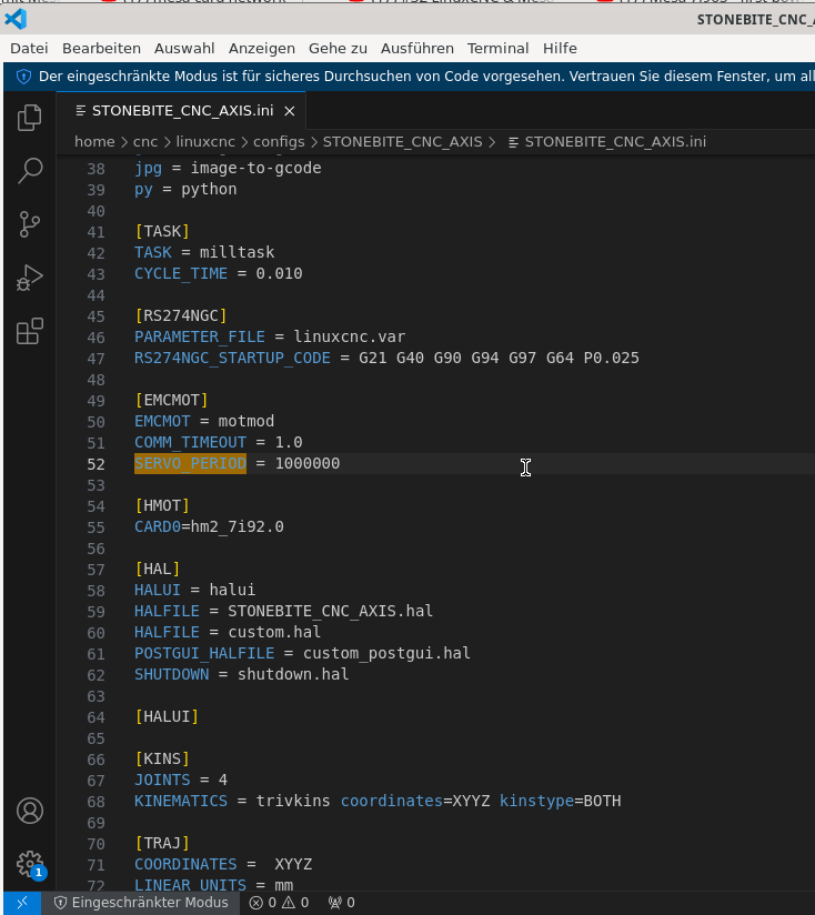

In the ini file the value is 1000000

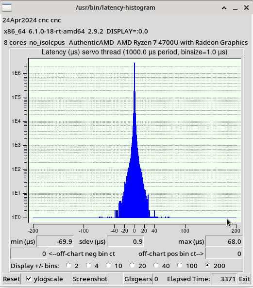

Good, now in a terminal
latency-histogram --nobase --sbinsize 1000 --show
leave it on for at least half hour while doing stuff on the PC and post the screenshot.

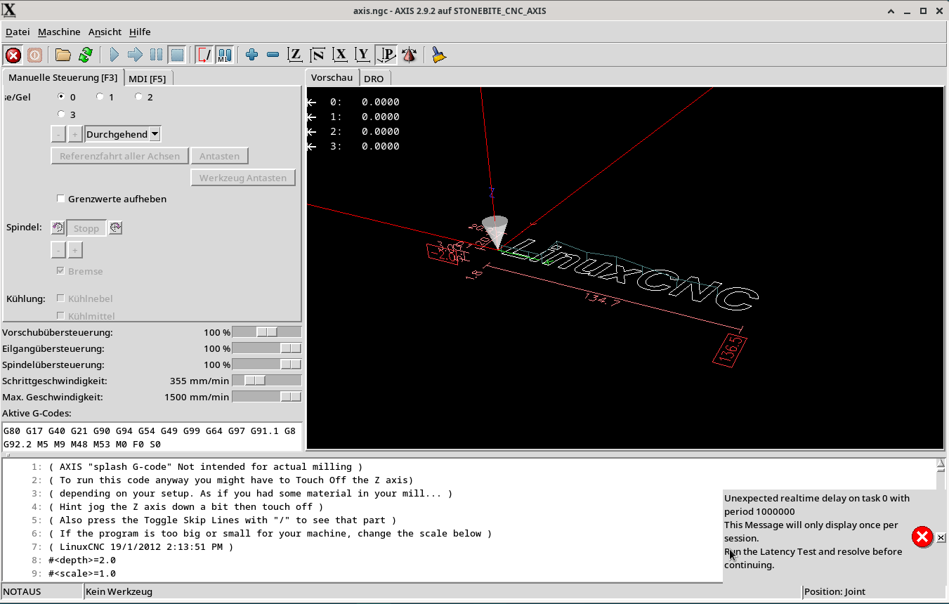

Replied by PCW on topic PNCconf 7i92H and 7i76
The 13 ms ping delay is not caused by a power issue (the 7I92 cannot
restart in 13 ms, it it loses power it will take about 1 second to recover),
The delay is most likely caused by some power management running on the host PC.
If this cannot be discovered and changed on the host PC it may be that that
PC is not suitable for real time use.

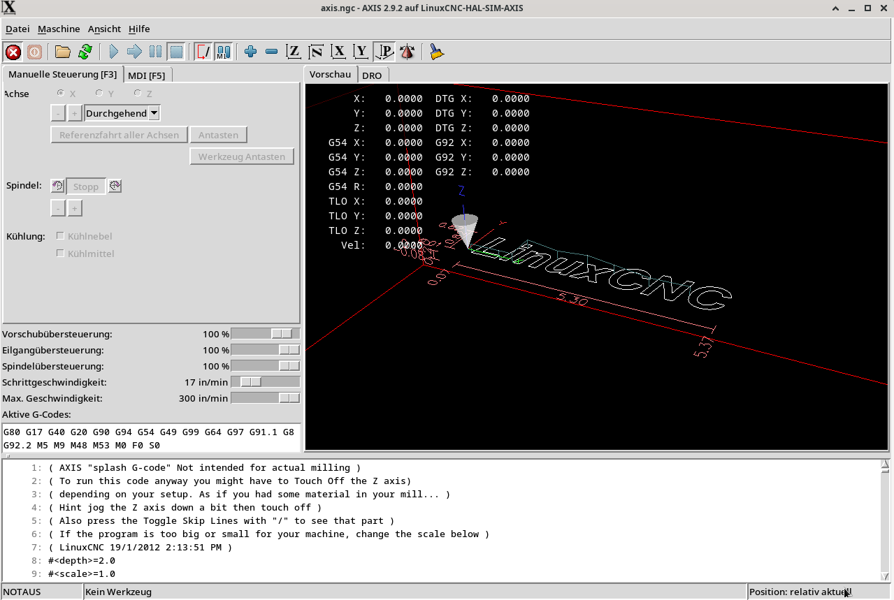

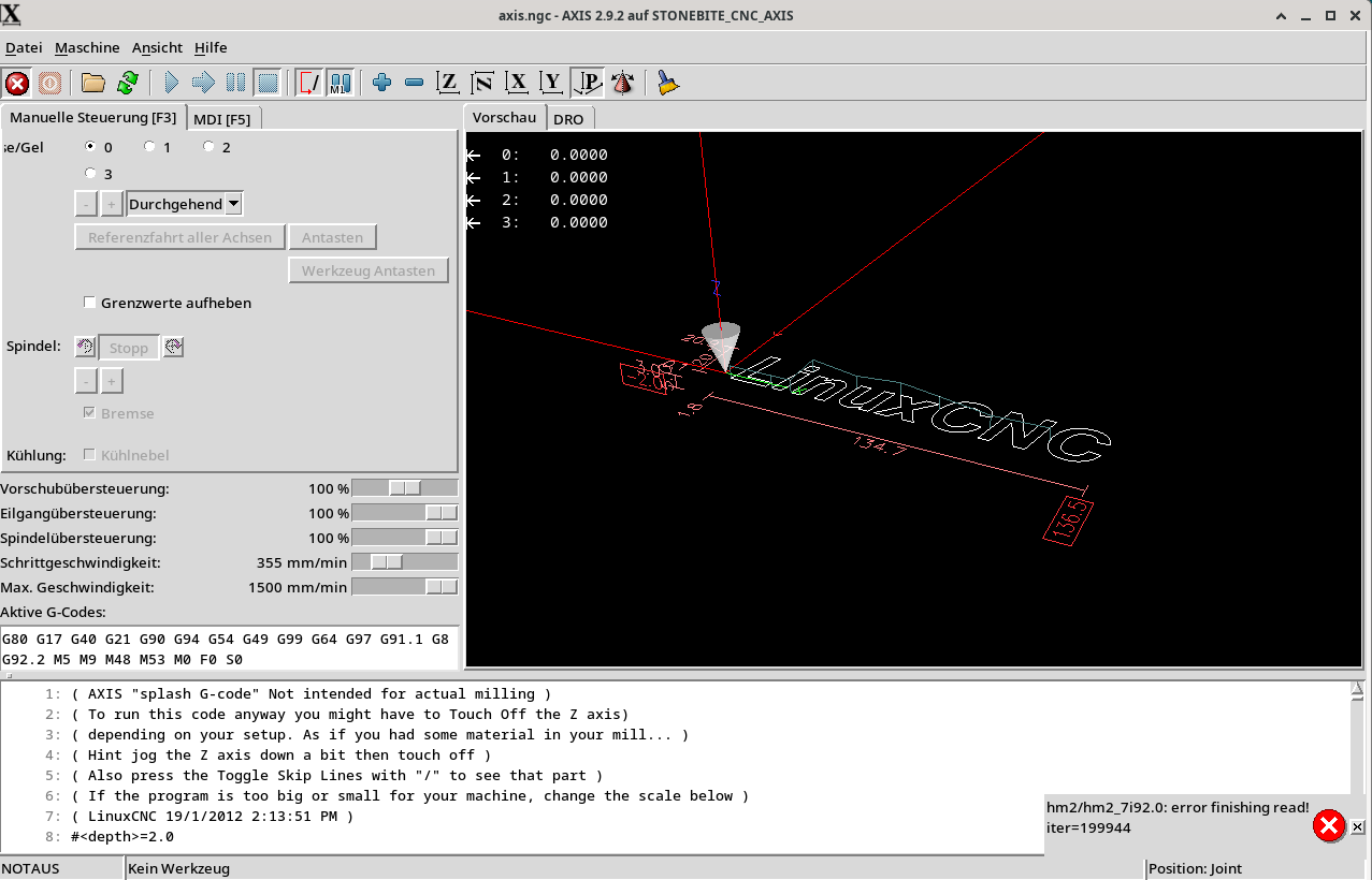

26 Apr 2024 02:34 - 26 Apr 2024 03:01 #299100
by stonebite
Replied by stonebite on topic PNCconf 7i92H and 7i76
OK Erp switched offPC starts normally ping > ok
reading out the 7i92 card > ok
first start of the pncconf file > not ok > 2 errors
second start > seems ok at first, but then error after about 30 seconds
third start > error appears maybe after 2 minutes
Starting an example file from LinuxCNC > results in no errors
why do I get errors with a file that comes from pncconf,
and with an example file from Linuxcnc not?
thank you in advance
