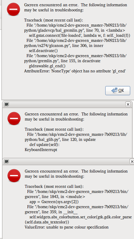

Hi
Some of cnc-club members have have tried gscreen from mentioned here git repository ( git.mah.priv.at/gitweb/emc2-dev.git )
But unfortunately they were unable to launch linuxcnc having this error messages:
What can cause them? Are there any fix?
Thanks in advance
Thanks in advance

no 100% sure , but in your home directory you should have a .gscreen_preferences hidden file
Last edit: 17 Aug 2012 11:42 by cncbasher.

They have such file with following content:
[DEFAULT]
window_force_max = True
window2_force_max = False
error_font = Sans Bold 10
err_textcolor = default
dtg_textcolor = default
hide_cursor = False
window_geometry = default
use_screen2 = True
gtk_theme = Blue-Joy
window2_geometry = default
abs_textcolor = default
rel_textcolor = defaultPlease Log in or Create an account to join the conversation.
- Posts: 7368
- Thank you received: 2181
18 Aug 2012 00:47 #23373
Replied by cmorley on topic Re:Gscreen - a GTK / Glade / Python based screen
Ask them to to replace their preference file with this one:
It seems the default color codes are not actually default...

18 Aug 2012 00:50 #23374
sorry the zip name was hidden...
