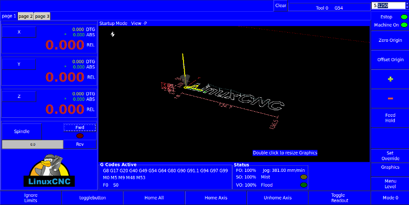

03 Jul 2012 04:45 #21510
Replied by cmorley on topic Re:Gscreen - a GTK / Glade / Python based screen
- Posts: 7368
- Thank you received: 2181
03 Jul 2012 04:49 #21511
I bet if i changed the graphics background color lighter it would look better... wonder if i can
