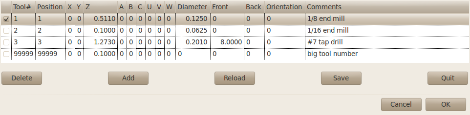

I'm working on a tooledit table widget for gladevcp... pics to come

05 Oct 2012 21:24 #25030
Replied by cmorley on topic Re:Gscreen - a GTK / Glade / Python based screen
- BigJohnT
- Posts: 3981
- Thank you received: 994
05 Oct 2012 22:10 #25032
by BigJohnT
Replied by BigJohnT on topic Re:Gscreen - a GTK / Glade / Python based screen
I like it!
Would it make more sense to have a "Save & Quit" button and a "Cancel" button?
Can you specify which axis columns show up with a yes/no for each axis in Glade?
How do you add those widgets to GladeVCP?
John
