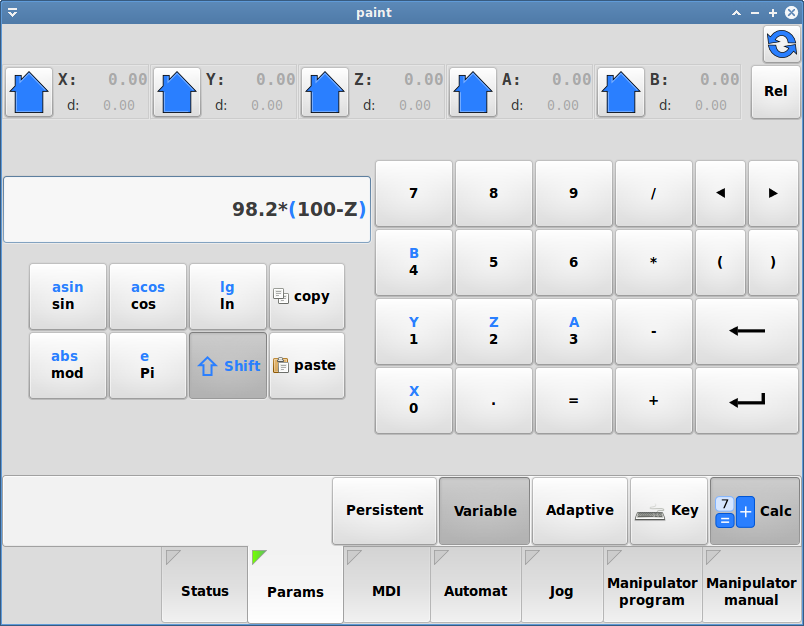

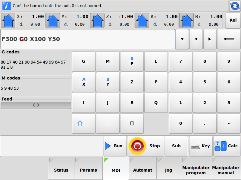

03 Aug 2015 01:47 - 03 Aug 2015 02:00 #61123
by krutic
Replied by krutic on topic Screen shots of gui designs

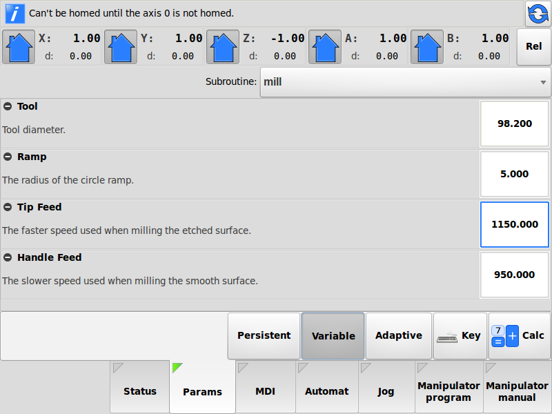

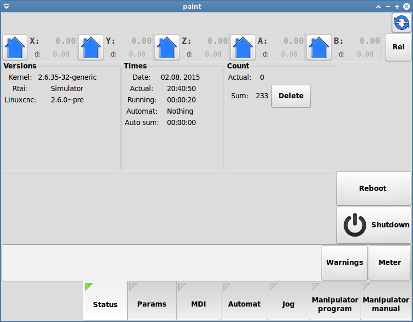

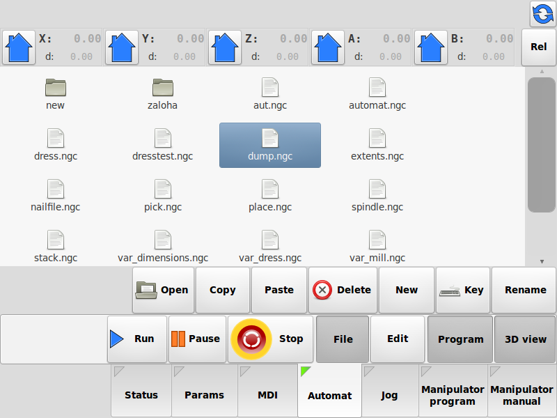

A few year later I was working on an automatic production of some glass parts. I think the linuxcnc is amazing and really complex project. I wrote this GUI to understand more how the linuxcnc works from the top of the application and because I needed some extended functionality which wasn't present. It's intended for touchscreen with 800x600 resolution. I call it PAINT (parameterized interface) because it has ability to change parameters during running program.

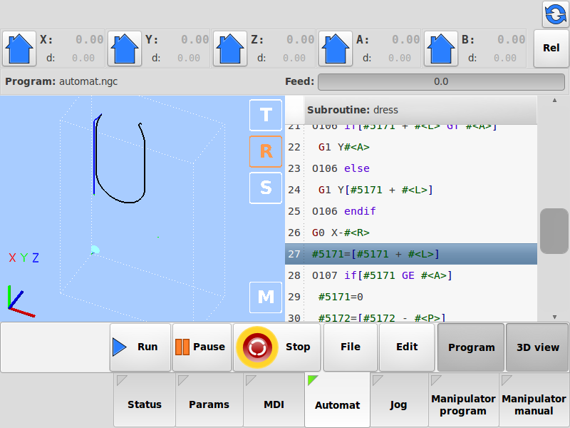

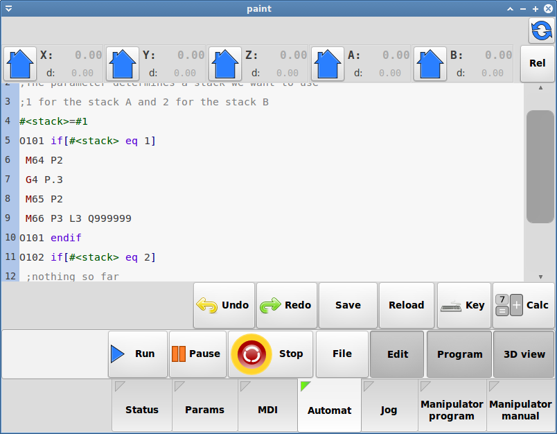

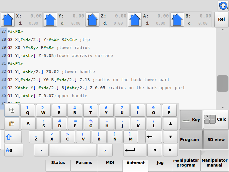

03 Aug 2015 01:49 - 03 Aug 2015 01:57 #61124
by krutic

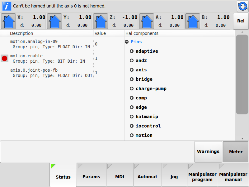

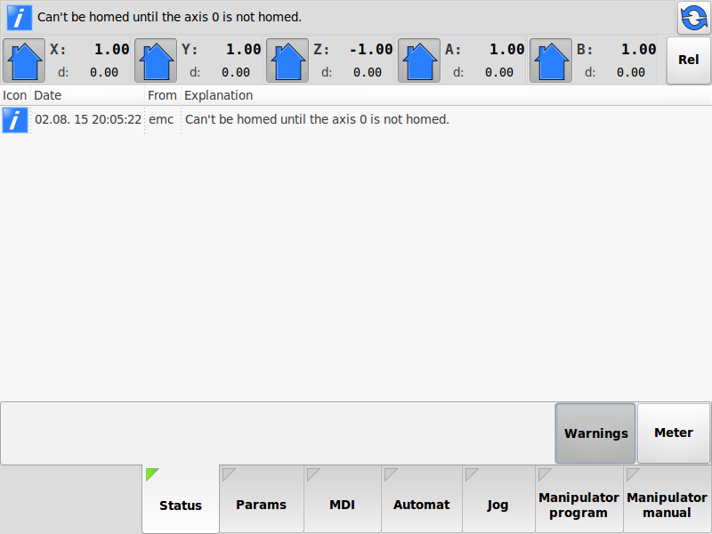

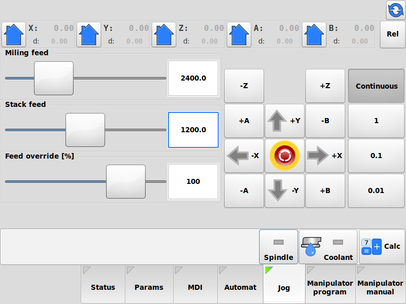

Rest of the previous pictures. Is there any way to join this project?

What language did you use?
What toolkit?
Is it open source?
Where is the sourfe code?

What language did you use? Python and C.
What toolkit? PyGtk.
Is it open source? Yes, it's open but no one has seen it yet.
Where is the sourfe code? On my hdd.

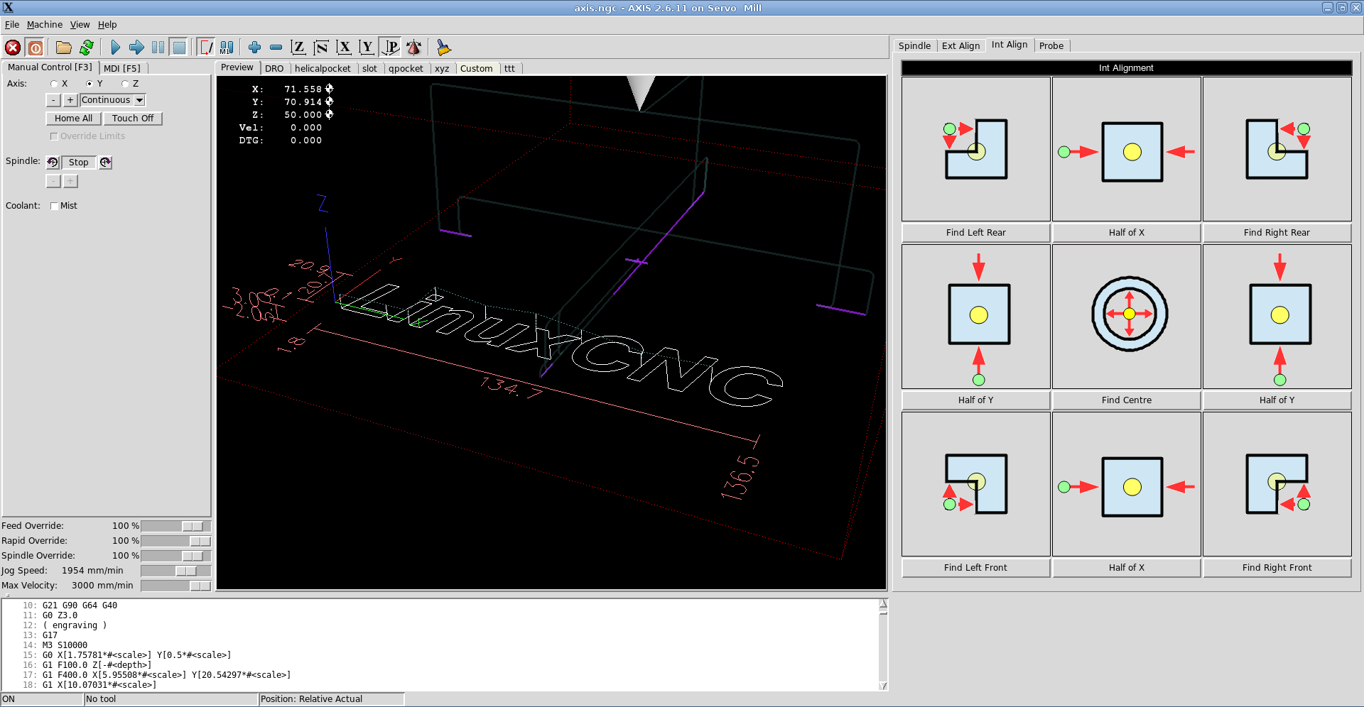

04 Aug 2016 00:18 #78341
by cncnoel
Replied by cncnoel on topic Screen shots of gui designs

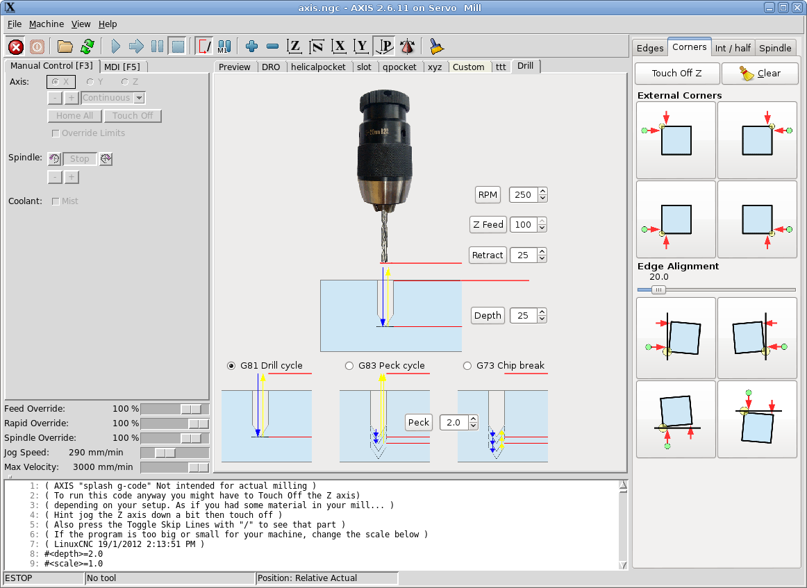

Here's the screen shot for the whole thing....
Working on the hole drilling UI at the moment.. with options for single holes, row grid, PCD...
experimenting with importing CSV data (from excel) into the hole routines - single button press, then select the file from the given list.
And here's the other panel, which really speeds up touching off the work piece. 5 seconds and we're ready to mill!
The automated half-x and centering routine makes life so much easier.
