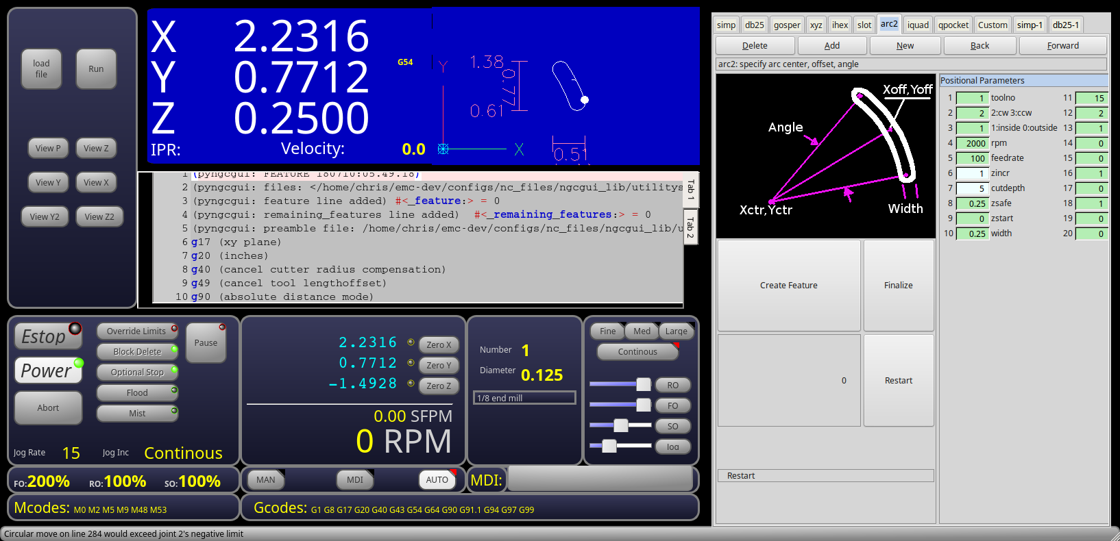

Hello
I apologize if my question is stupid.
Is there any guide to qtvcp?
I would like to add some features to the buttons. For example, I need to click on a button to run some MDI command, python code or other
I would also like to know - is it possible to bind any PIN to the led
Buttons of zero axes become available only after the axes homed
This is convenient for the first run of the program. But if turn off the power, and turn on again, then the buttons become unavailable again. So You have to calibrate axes again
Also, manual movements are slow, compared to the "axis". Both the up and down buttons move the Z axis, and the left and right buttons are inverted.
Please tell me where I can fix it if possible
Thank you!

Not a stupid questions at all.
I might warn though qtvcp is not released yet and is under fairly heavy development.
Also features depend on how current your version is.
what branch are you using?
Action buttons allow arbitrary MDI command select the property MDI command action and at the bottom of the list should be command text.
in that command list either enter the MDI command yo wish to use or add
MDI_COMMAND_LIST=0
The 0 will be the number of the command you wish.
This option allow you to add commands to the INI file under the heading (probably would have to add it)
[MDI_COMMAND_LIST]
with the signature:
MDI_COMMAND=g0x0y0z0
MDI_COMMAND=g0x1y1z1
in this example the first command would be call with 'MDI_COMMAND_LIST=0', the second with 'MDI_COMMAND_LIST=1
Using designer's signal and slot selection allow arbitrary python code in the handler file to be called If you need that info ask again.
The LED widget can have a HAL pin (I think this is what you are asking), it's selectable in the property editor under the name halpin_option and can be connected to any other HAL pin of the same type (BIT)
I see what you mean with the zero axis button - i'll look into it
Do you mean the axes move in the wrong direction or the buttons are laid out opposite your machine? The current screen i tested seems to move the axes in the right direction. It may mean you are using an old version.
There are some beginnings of documentation - if you compile with the -enable-build-documentaion=html you can have HTML docs on your webbrowser or just look in at the text files in doc/src/gui/ there is qtscreen, qtvcp_custom_widgets qtvcp_libraries and qtvcp_widgets.
Thank you for the feedback.

Thanks for reply!
I used the older version.
I tried to update the branch, but I broke it. Had to build anew.
After building, I got an error:I fixed line 7 in widgets_plugin.py: Changed gcode_widget to gcode_editor
Maybe you should fix that too.
Now, I'll try to follow your prompts.
Thanks,
Ilya

Yo must be using qt5vcp_py2 branch - it got stale - I was doing renaming in qt5_vcp_cleanup.
I just pushed to qt5vcp_py2 to bring it back to date.
If you try to pull this branch into your local branch it will complain of conflicts.
Be careful with this next command it overwrites the code in the branch:
(save any personal work you have done on this branch that you want to keep)
So the command to use after switching to qt5vcp_py2 is:
git reset --hard origin/qt5vcp_py2
Ilya:
This command doesn't merge anything it overwrites your branch to linuxcnc's github version.
There was a big name change in this code - qtscreen was renamed qtvcp.
Not all the docs reflect this change.
The docs do give details of how to get designer working so you can edit screens.
The errors you describe should go away.
If you have more questions please make a new topic so as not to take over this thread.
I would be very interested in your comments on the project.
Are you interested in development or use of qtvcp?
Chris M
